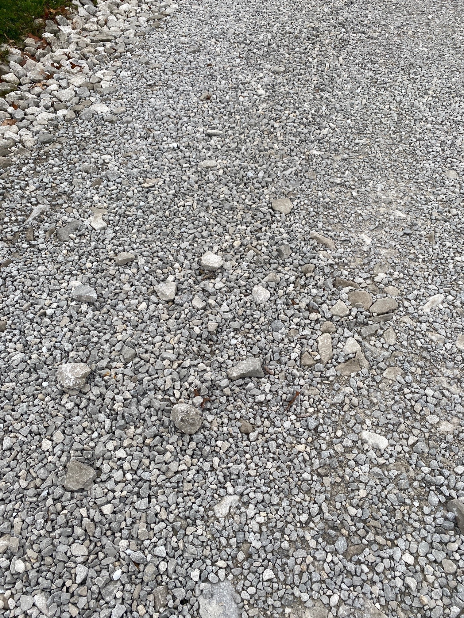

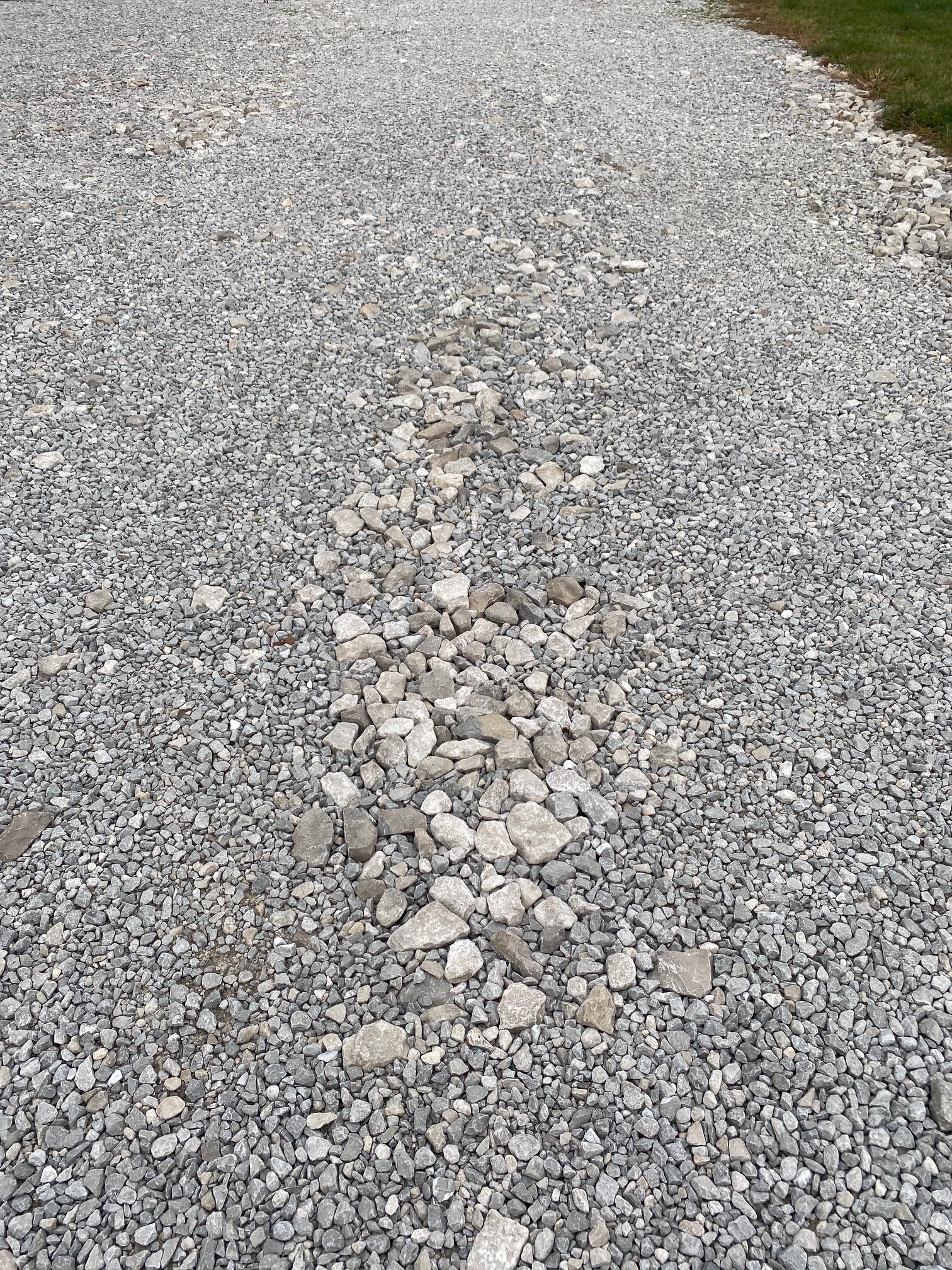

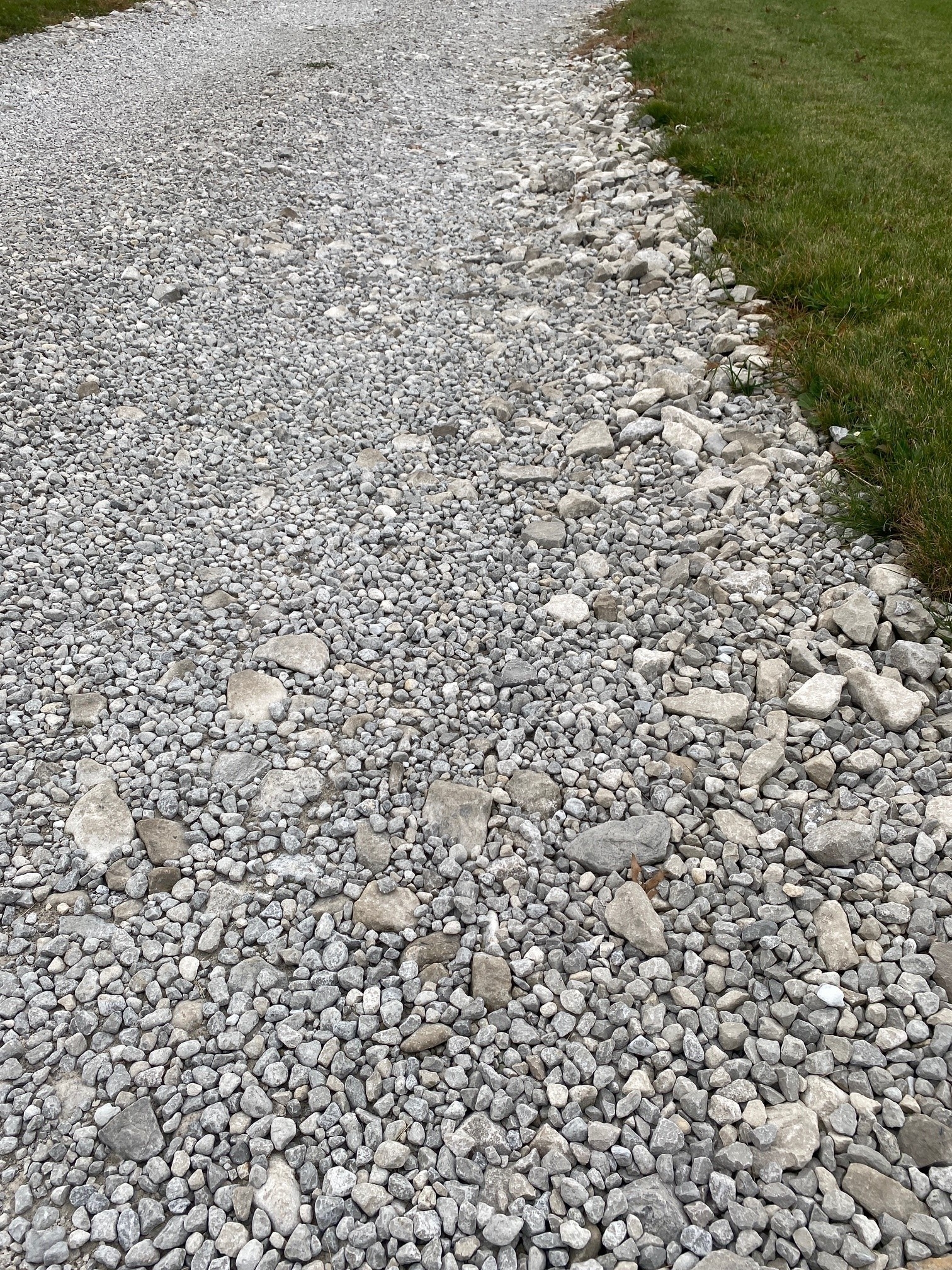

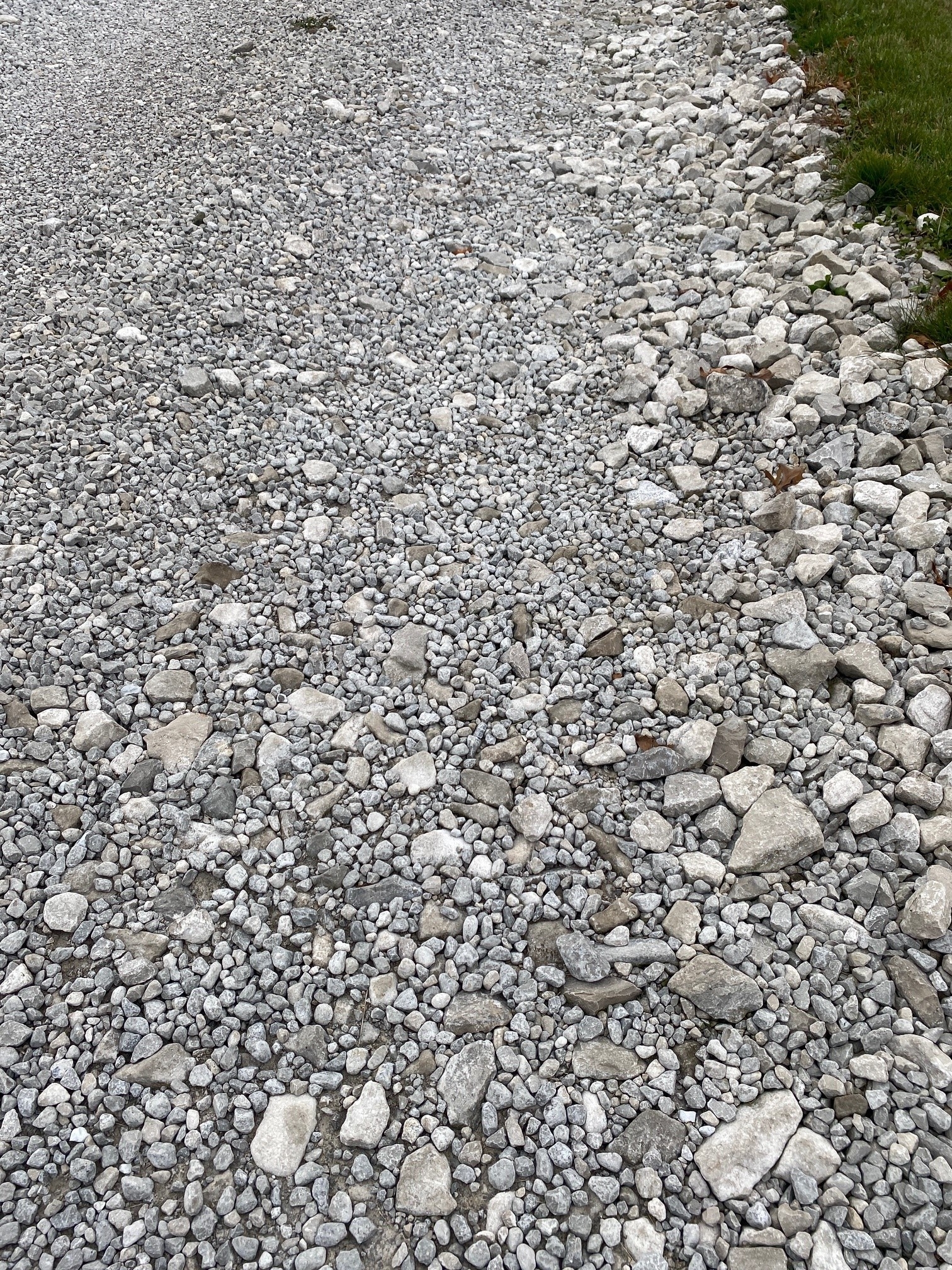

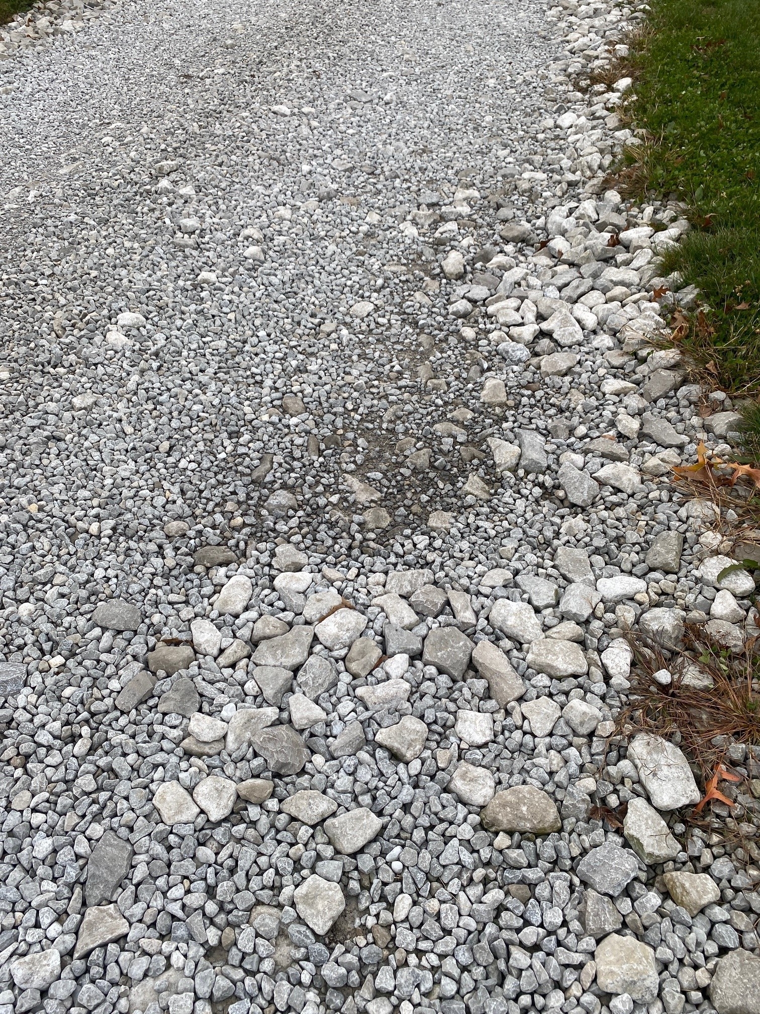

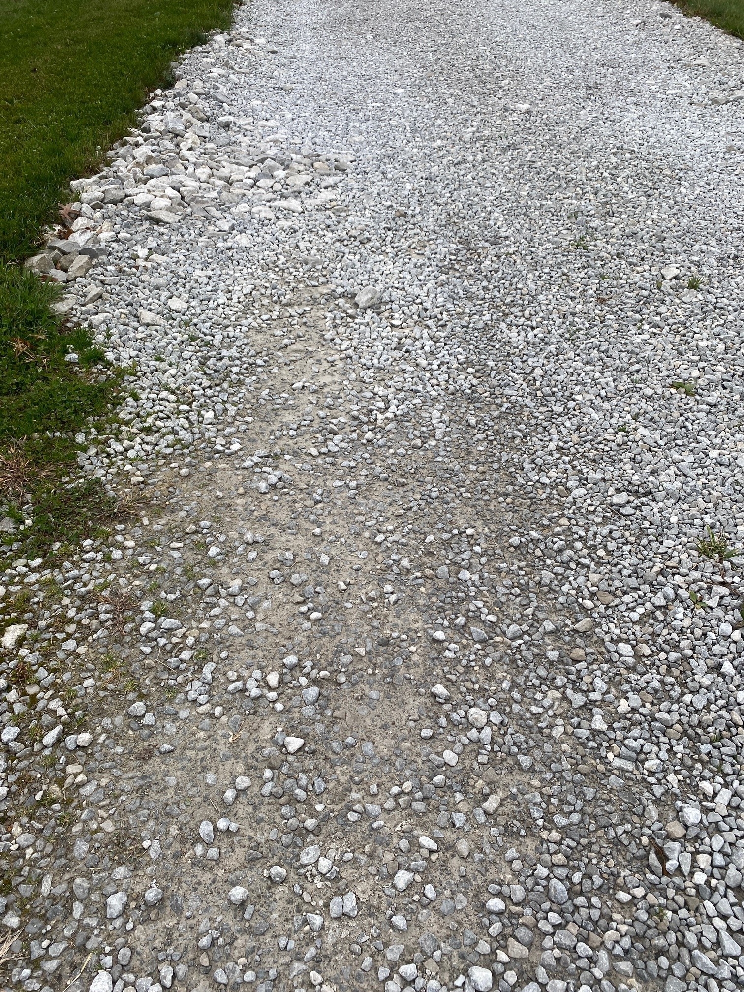

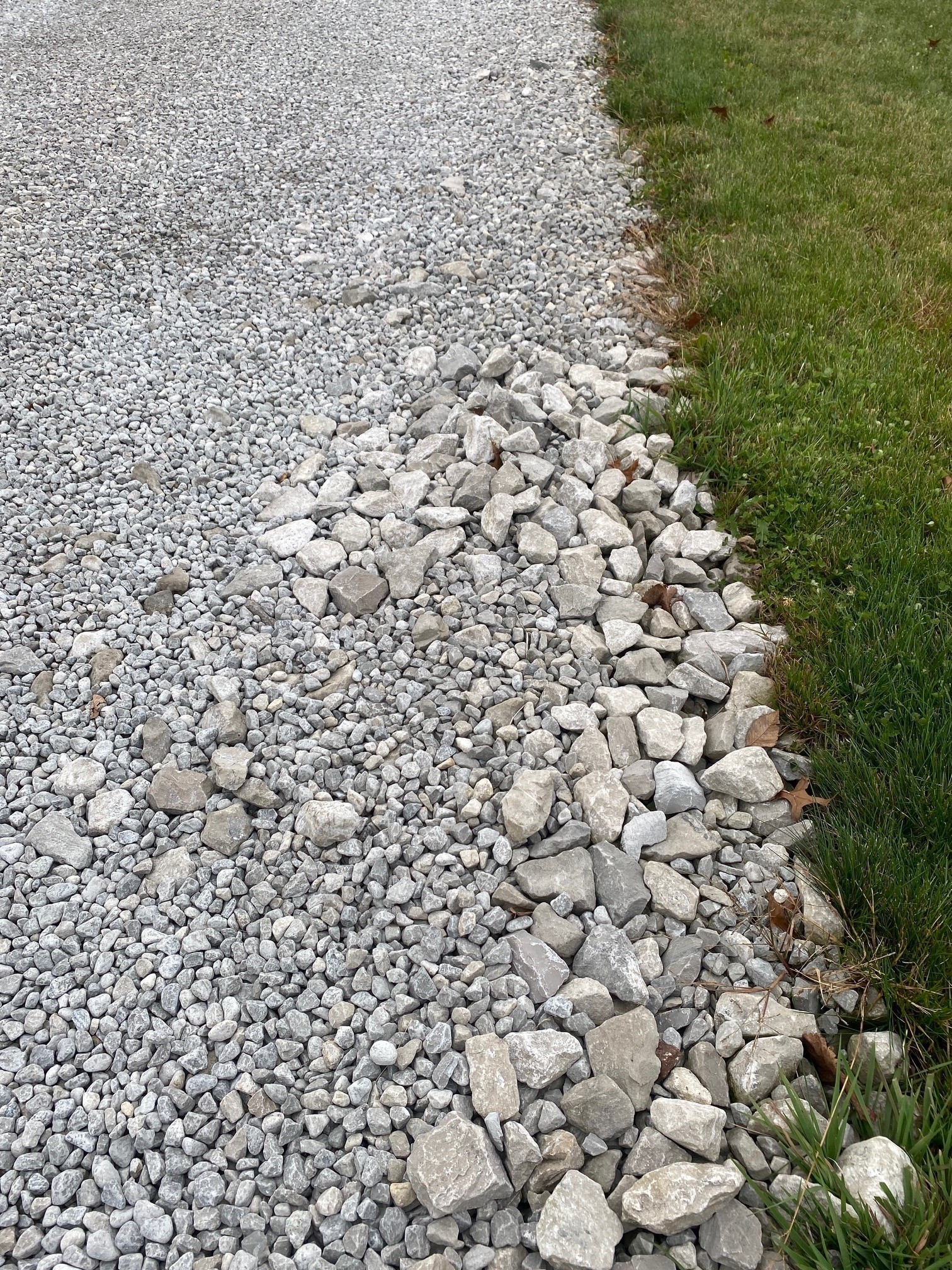

There seem to be some areas where the larger stones have piled up in loose piles. I think I'd rake or box blade them before adding a top layer of what we'd call crusher run that has a lot of fines in it. It would take a lot of material to cover those piles of loose, larger stones if you can't find a way of spreading them out or using them to fill holes somewhere.
Do you have a rake, box blade or dirt blade?

The contractor is correct on the working it will only bring the large stone to the top. The vibratory roller would be a good idea too, only I'd top it off with limestone screenings (#9's to dust) readily available at all quarry's here, and least expensive in Ohio to lock the larger stone together. 1-1/2"-2" would be plenty for now. You'd want them pretty damp, but not totally wet to semi compact.
Depending on what you have to work with, reversing a 3 pt. blade to smooth it out, and work it in some if they tailgate it then if you wheel roll it, or use a loaded lawn roller just to semi compact and keep in place, it will work its way down into the stone and lock it together after rains, freeze/thaw cycles and driving on it. Just try to drive in different wheel tracks to compact driving on it after the initial compaction. You can top dress in a couple years with more screenings if they disappear into the stone. Once that gets stabilized, if you need to do a deeper top dress 2"- 3" of 67D/411 (seems not all quarry's use the same numbers here in Ohio) It's 3/4" limestone down to bug dust. Back blade to smooth it out and wheel roll or roll with loaded lawn roller. You'll also want this pretty damp, and it will compact very well.
I haul my own when needed and prefer to haul after a couple days of rain, so the material is pretty damp in the pile they load out of yet tailgates half decent. It compacts very well. The only downside is it will track in on a concrete floor if you park in a garage/carport whenever it rains, or snows. Choose your poison.
   / Gravel Driveway Maintenance #17
I would get what we here call "limesand", it is not dust but just a bit more granular like... a course sand. It's easy to work with and when it compacts it is very tight. It also maybe more readily available than some of the other options offered here since any quarry that supplies aggregate to asphalt plants should have it.
   / Gravel Driveway Maintenance #18
Maybe just a load of "screenings", which is just the fines, to fill and pack?

M
My 420 ft gravel driveway needs some attention. I am having some of the larger base material (#1 and #2 limestone) come up to the surface. I would like to know what course of action is best to get my driveway back into shape and be noticeably smoother when driving on.
From my understanding, the driveway was built by digging away the organic material until a solid base was reached, base layer of #1 and #2 limestone was used, followed by some type of fines material to lock it in place, and finally topped with #57 limestone.
I live in Ohio so winter weather and snowplowing does come into play.
The driveway is 4 years old and has never had a box blade or land plane on it. I had a local excavation guy take a look at it to see if a box blade or land plane would be better to performance some maintenance on it. He said both would be a terrible idea because all it would do is bring more of the larger base material to the surface. He said once that base material comes up, it will never go back down.
He recommended using a large and heavy ride on vibratory roller that will break up and crush the larger material that came to the surface. Then, a blade of some type can be used to smooth it all out. Followed by another round of a ride on vibratory roller to compact it. He said I have plenty of stone on the driveway already and no new stone will be necessary.
What are your thoughts on this?
Do you have a different approach to this project?
Pictures are below to hopefully provide a better idea of the current driveway conditions.
View attachment 831288View attachment 831289
View attachment 831291View attachment 831292
My thoughts are if you got the big rock on the bottom it will disappear if you don’t blade it. Can be a box blade, I prefer the other if it’s heavy enough. If kept bladed the rock will not go in the ground and you want the rock to drive on. The ground with old the rock. For maintaining, keep it bladed twice a year

I got a box blade recently and used it on my second driveway and parking area and it did bring a lot of the bigger stuff up. I’m not sure that’s a bad thing if you’re going to add more gravel with fines on top, which I think is good advice like a lot of people are saying. If it’s already pretty even I wouldn’t blade it at all.
Im a retired land surveyor but my degree is in civil engineering and I did some material testing over the years. I don‘t think I ever saw any kind of roller break up larger stone into smaller pieces.
