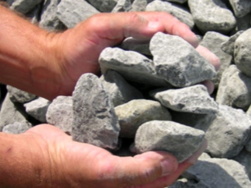

I've never had a pothole problem, just washouts which are running downhill if there's a "gully washer" rain, and I can just drag the gravel back in place. Do you have a solid base of #2 under the road pack? Road pack (or dense grade) by itself will not hold up when the ground turns to peanut butter.

I have probably watched a tleast 50 YT videos on grading gravel driveways, and have graded miles at our camp.
Best explanation I heard about fixing potholes, if you don't break up the hole and just fill it in, it is like punching a bowl of dry cheerios. Makes sense.
I lower the rippers on the box blade and rip the hole first, then fill and compact.
   / Gravel Driveway - pothole #14
Conventional wisdom is that the road should be scarified to a depth greater than the bottom of the pothole. (Pick-axe if it is small, and you do it by hand). A Calvanist philosophy that the longer or more difficult the task, the better the results, dictates that back-filling in multiple layers with tamping between layers is better than a single back-fill. While you could rent a plate compactor or a jumping jack, oosik's suggestion of driving over it (slowly) with the highest ground-pressure tire is probably most expedient. (Might be tractor front wheel with a load in the bucket or rear tire with a heavy implement).
   / Gravel Driveway - pothole #15
So just fill it with the #53's?
Yes, no need in disturbing 99.875% of your road just for a few holes. You have a road to maintain. Extra gravel is good to have. Just get a bag of Portland cement, fill the hole with gravel, sprinkle a couple handfuls of Portland on it, maybe water, and leave the rest of your good drive alone.
I do not know what is under the drive. We have been in the house 6 years. We have spread the #53's on top once in that time. It is time to do it again. The base is very solid almost looks like concrete, but clearly is not. It is limestone that has been packed down over the years.
