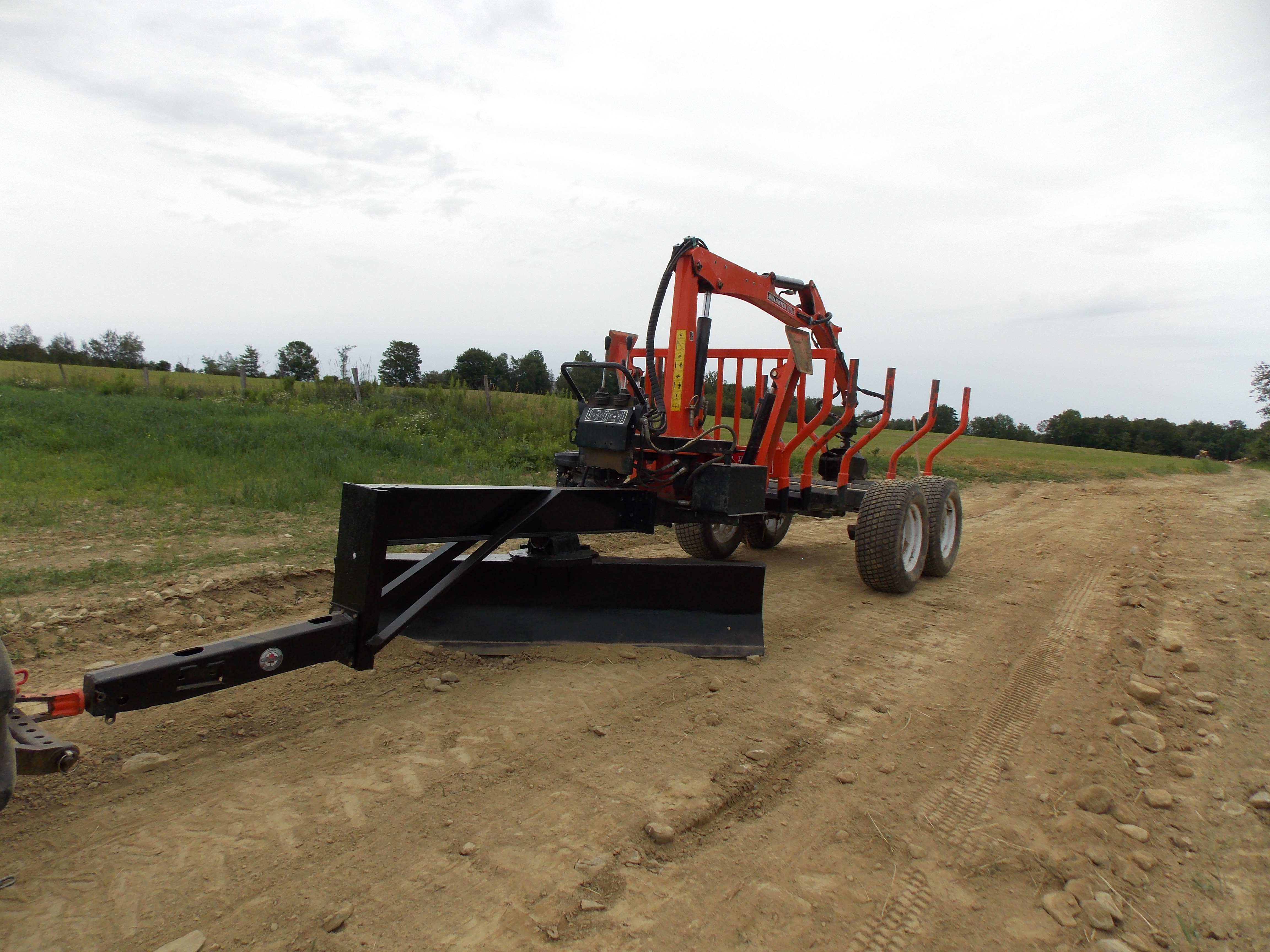

I use a tow behind grader with the blade set at an angle to roll the gravel that has been cast to the ditch from snowplowing, back into the roadbed, and thus fill the ruts.
I do not think you did anything wrong, it is just one of those things: big load once, or light loads more often. I think instead of rebuilding the road after many years of use, I would just lightly grade it every year. You could use your box-blade for that, but a tow behind grader gives a better surface.

Egon has it right I think, but I would not wait five years. I maintain the crown in my road and remove traffic ruts by grading my roads every year. It is just as spring task that must be done.

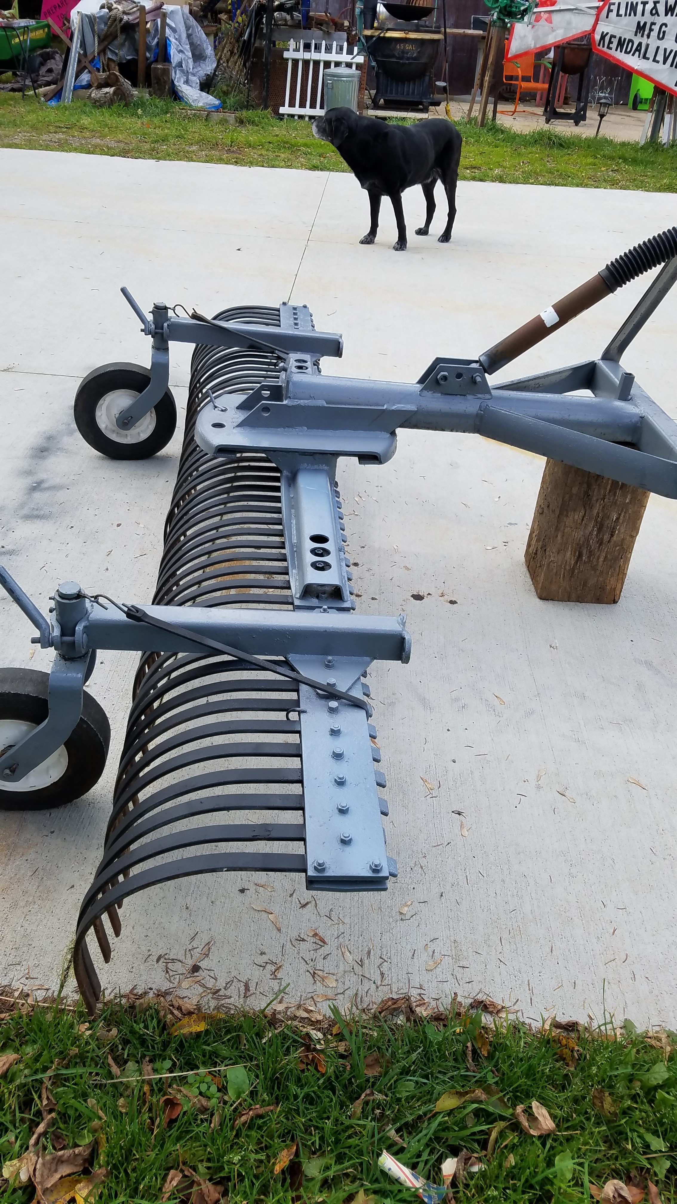

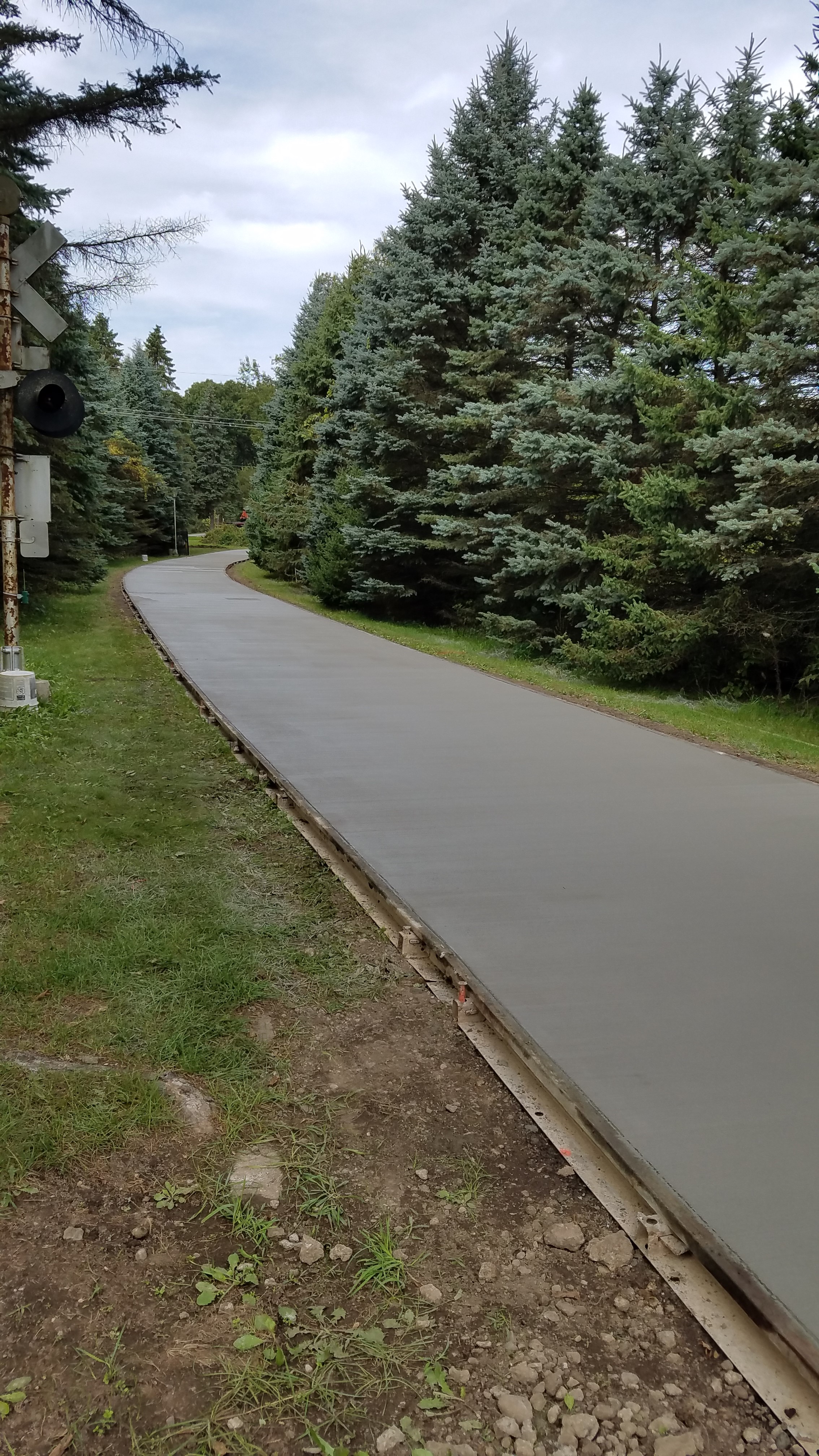

I used to use my rototiller on the gravel after a heavy rain. Loostened it all up. Then use a landscape rake angled at 45 degrees to comb it back into place. You need rear gauge wheels and no top link (I used a chain). Finally said THWI.
