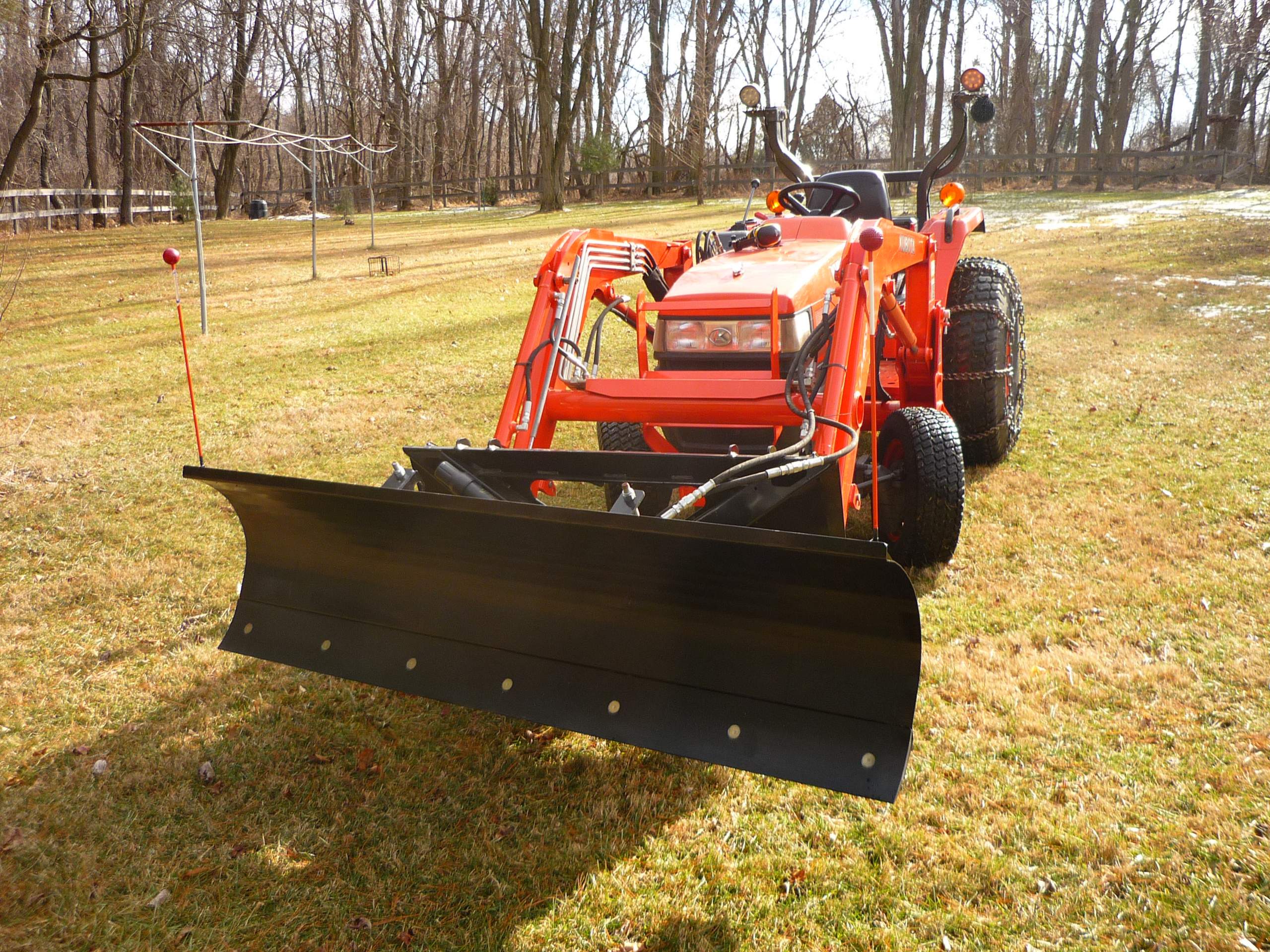

For years, I have cleared snow from about 750' of sloping gravel drive. I first used a 5' rear blade and a front loader bucket, but now I have a front blade with hydraulic swivel. Depending on how rough your drive is, you probably want to float just above it, since a blade, even with shoes, will want to dig in. Where we are in MD may be a similar climate, but we have had 30" snowfalls more than you'd think!
You might want to look at a small tractor, like a Kubota B2620 (not that it would be right for you, but it would be a starting point for looking) or something similar perhaps older, with a loader and rear blade. Ideally, a front blade, but you would want either the Kubota frame mount, or a SSQA loader. Such a set up would make snow removal almost pleasant. A box blade, also, for maintaining the drive. Now that our lane is paved, plowing will be a snap. There are many good small tractors, but I am partial to Kubotas, having had three and excellent experience with them all.
A small, 20-30 hp tractor, with 4 wheel drive, and a hydro transmission, will be ideal. You shouldn't even need chains, unless you get a lot of ice underneath the snow. Remember, with climate change, weather will getting worse, not better. My so-called avatar photo shows our present set up. With a heated cab, I would be having fun in the snow!
