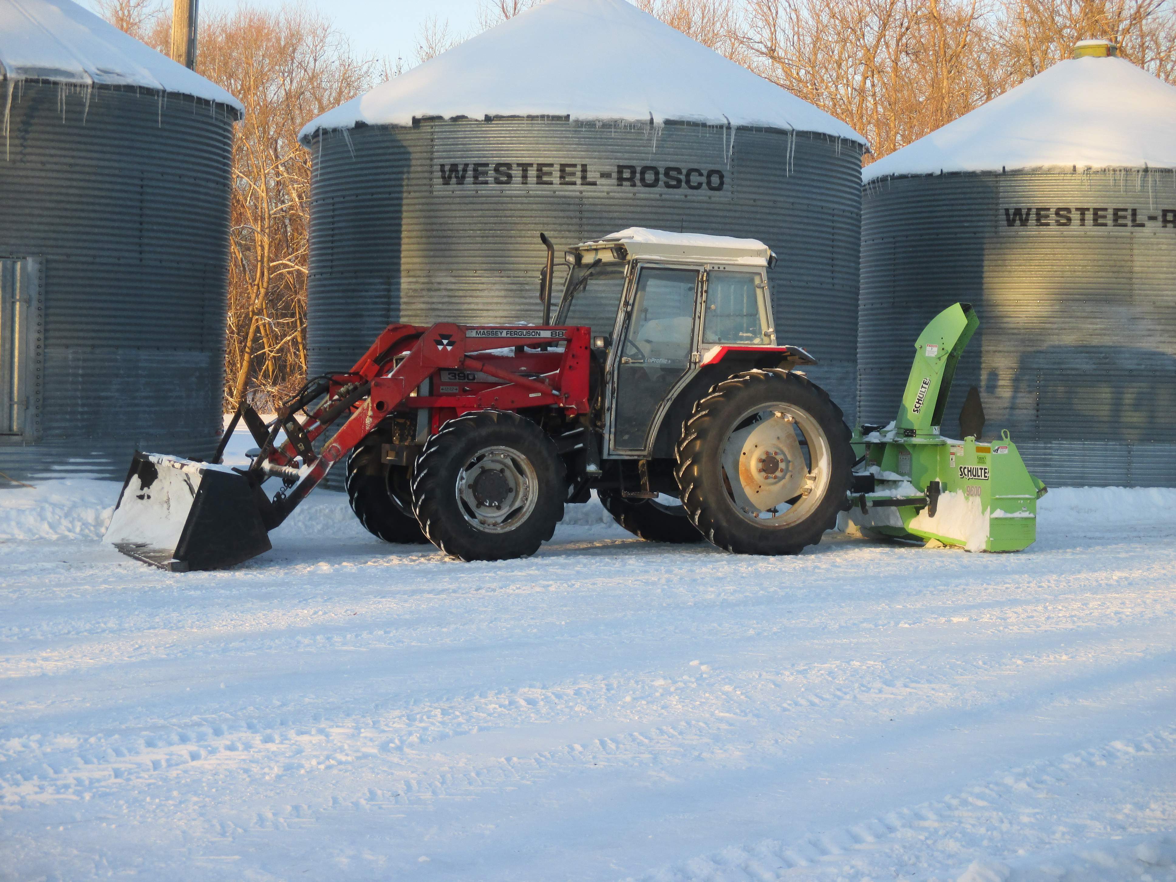

This is what I have for 1/4 mile driveway . Clear probably twice a week but definateley would not want any less .
