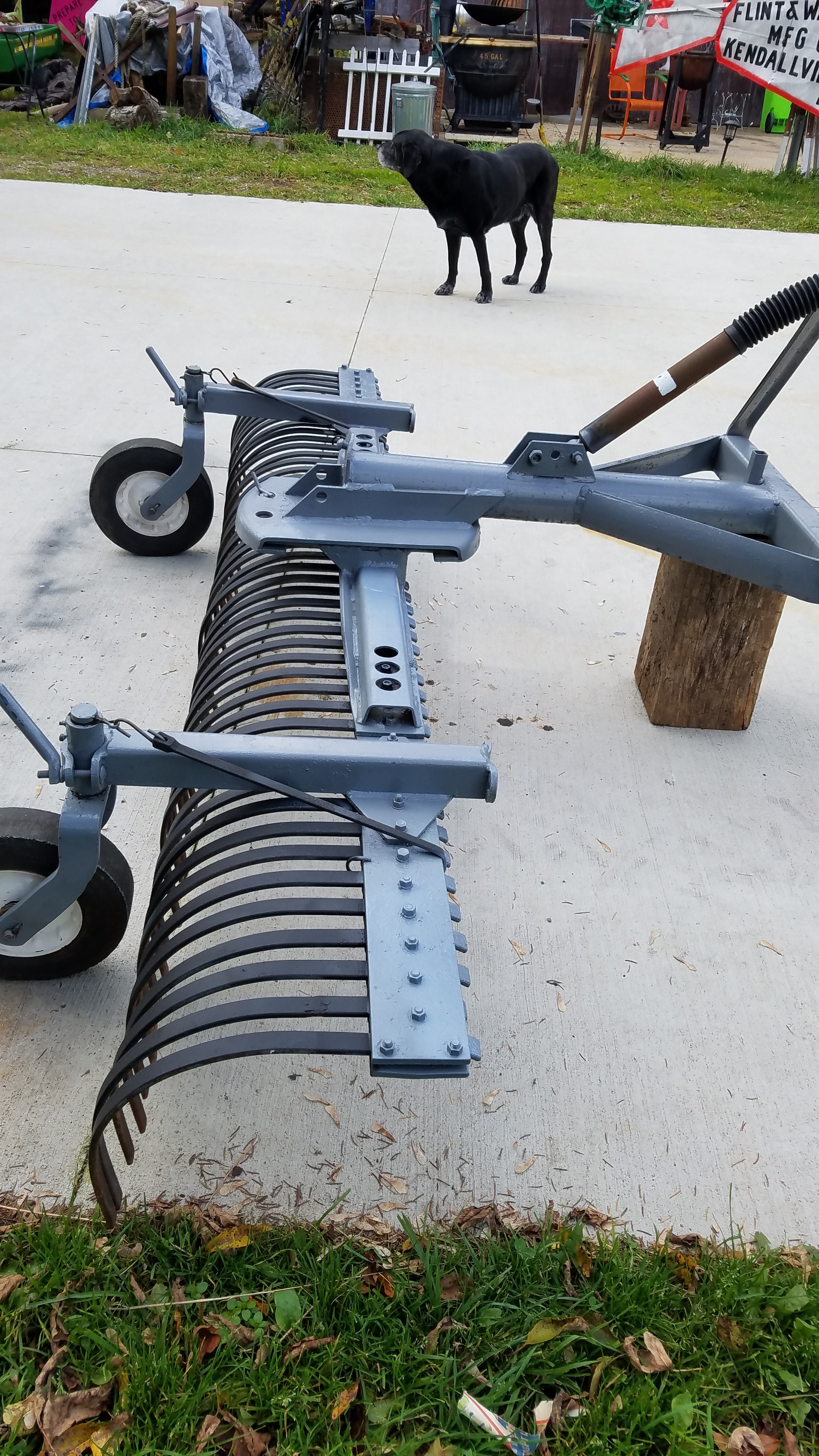

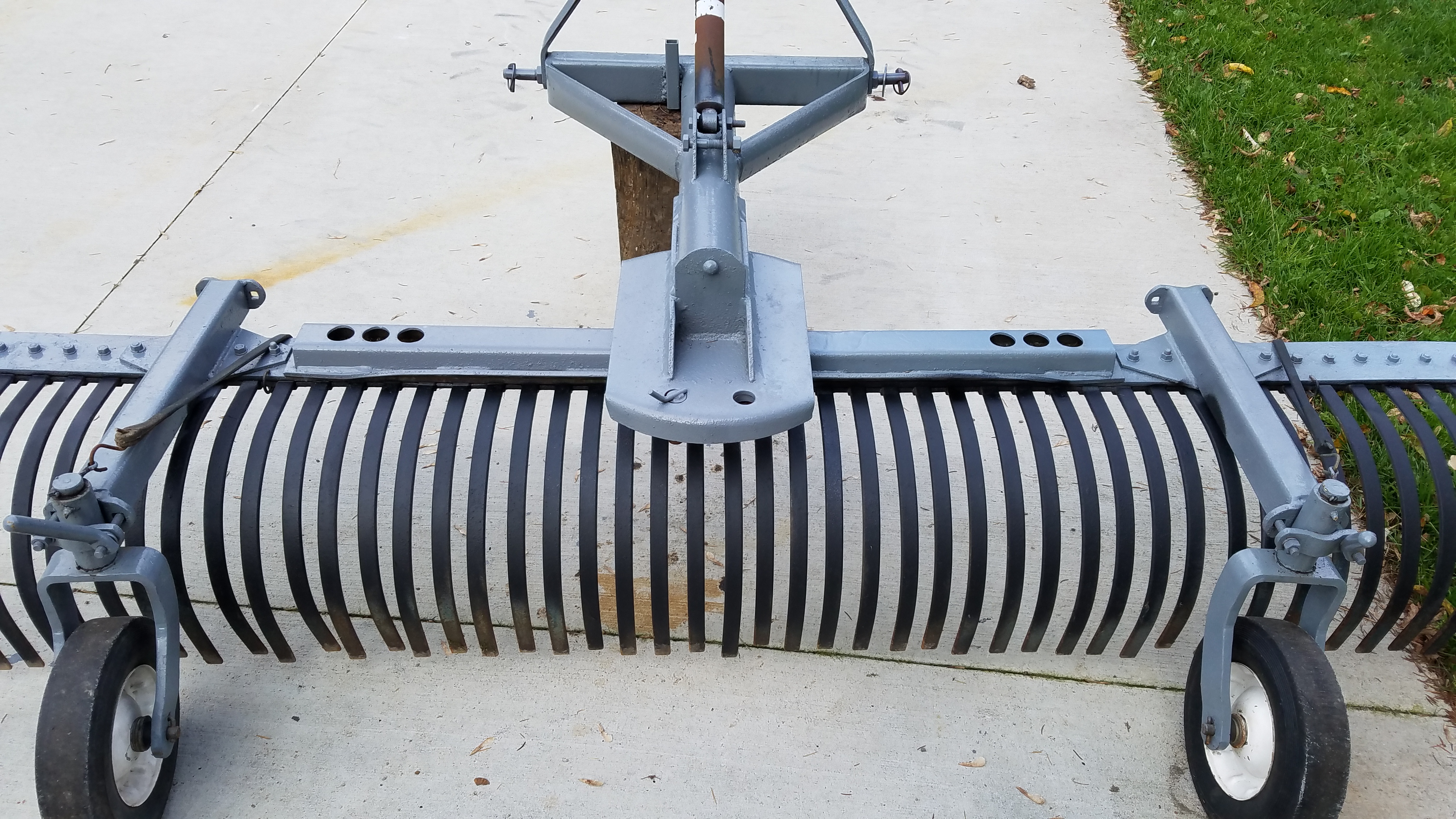

This is all you need. This is 8'. I add weights to the toothbar when needed. The key ingredient here are the gauge wheels and the floating upper link (Use a chain and keep it loose when grading the driveway. You make a 3 stage crown by swinging the rake 45 degrees with a slight angle on the hitch attachment. Then polish it off with a run down the center with 20191105_141816.jpg20191105_141805.jpgzero rake angle.
