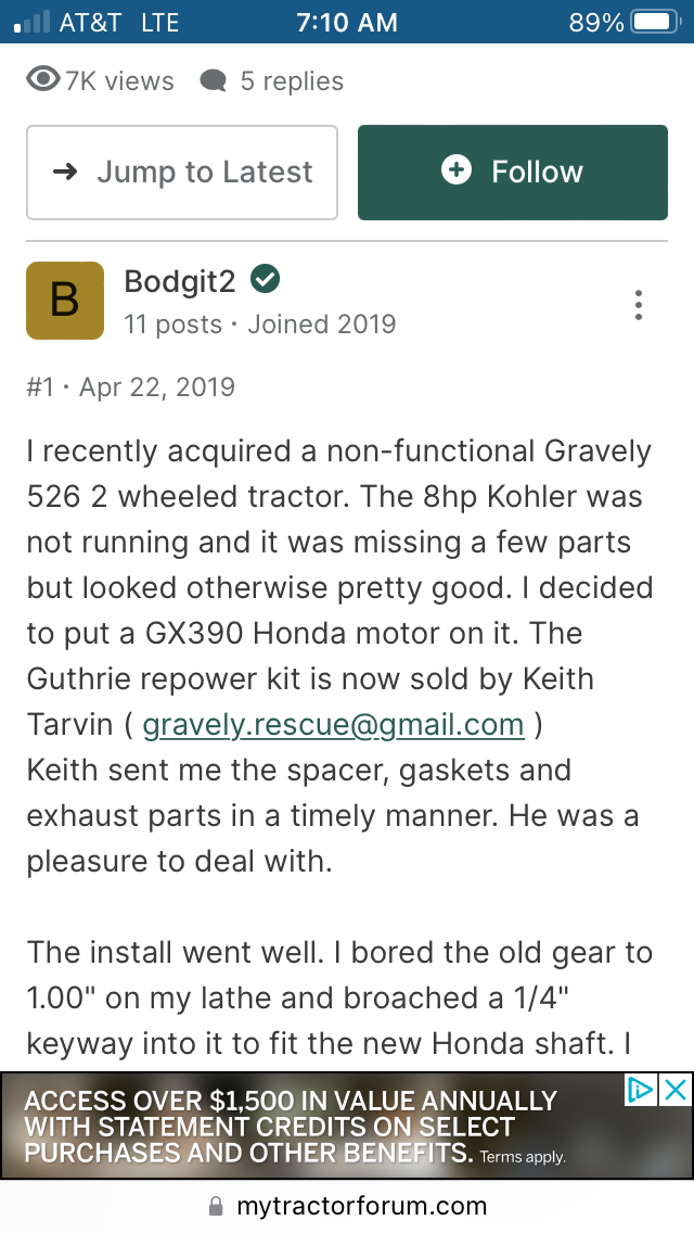

I have a Gravely 526. It has a Kohler K181 engine. I need a crankshaft and a flywheel for it. If I can't find parts for it, does anyone make a repower kit for it. I have seen in years past that gravelymay? made a repower kit for gravelys.

I read that there was a guy who took over doing the repower kits from gravelymay, but can't find his name. There is a private Facebook group on repower, but I am not a member to know anything about it. So many Kohler K series engines were made that I'd think you could find the parts somewhere?

Website My Tractor Forum has a good post with exactly what your asking about
