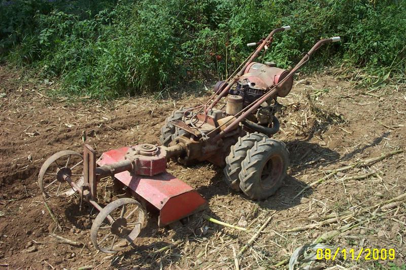

Here is a picture after tilling today.

Can't tell from your picture but it looks like there are no shrouds on the cylinder. That could cause your engine to run hot. Early models didn't have them and some people have been known to remove them. The engine can then run hot and have the exhaust valve stick. Does it crank back up when cool? Check your screen in the tank or the glass bowl filter and see if you have good flow to the carb. Check and make sure your cap vent is clear. If all that checks out, then your carb needs cleaning.
/ Gravely L8 not starting
The way it died this time, I thought it was out of gas, but there's plenty of gas in the tank. It also fired right back up after it cooled off.

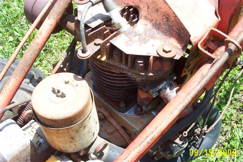

There is a shroud on the back of the engine where the fan is located but there is no shroud on the front of it. Looks like there are some mounting holes where a shroud would have attached?
From what I can tell, this is a 1964 model.

I will look silly here and answer my own post. The side air deflectors are missing, but just bought a new pair for $13 something each.
The paper air filter is dirty, but the local dealer says the paper air filter is no longer available. Any ideas or substitutes for it? I've got a couple of older machines with the oil bath filter, but I hate to rob one machine for another....
