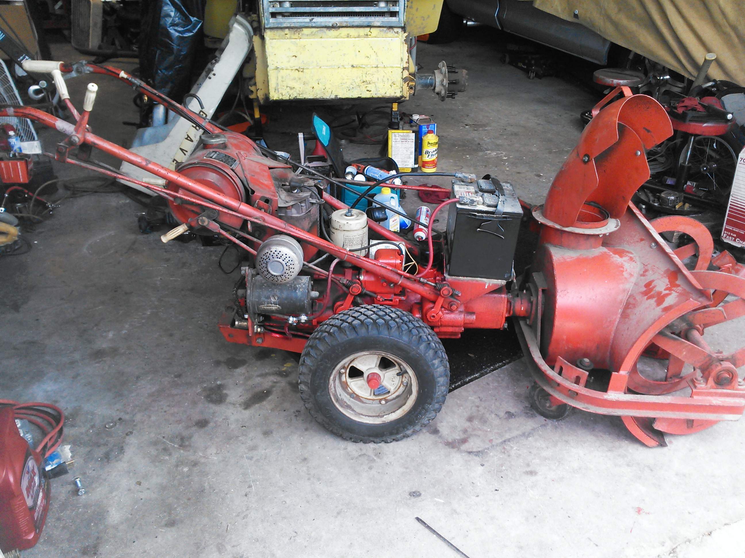

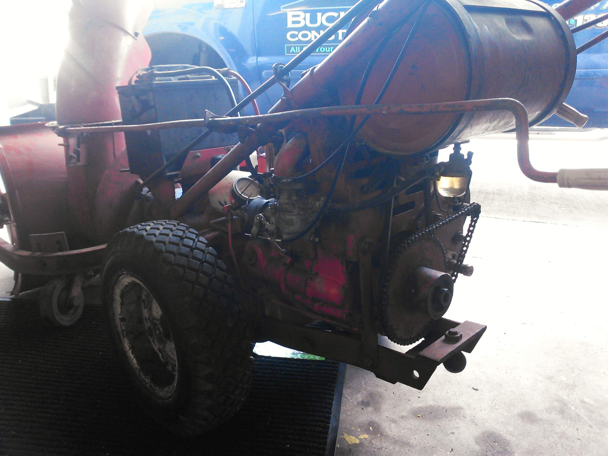

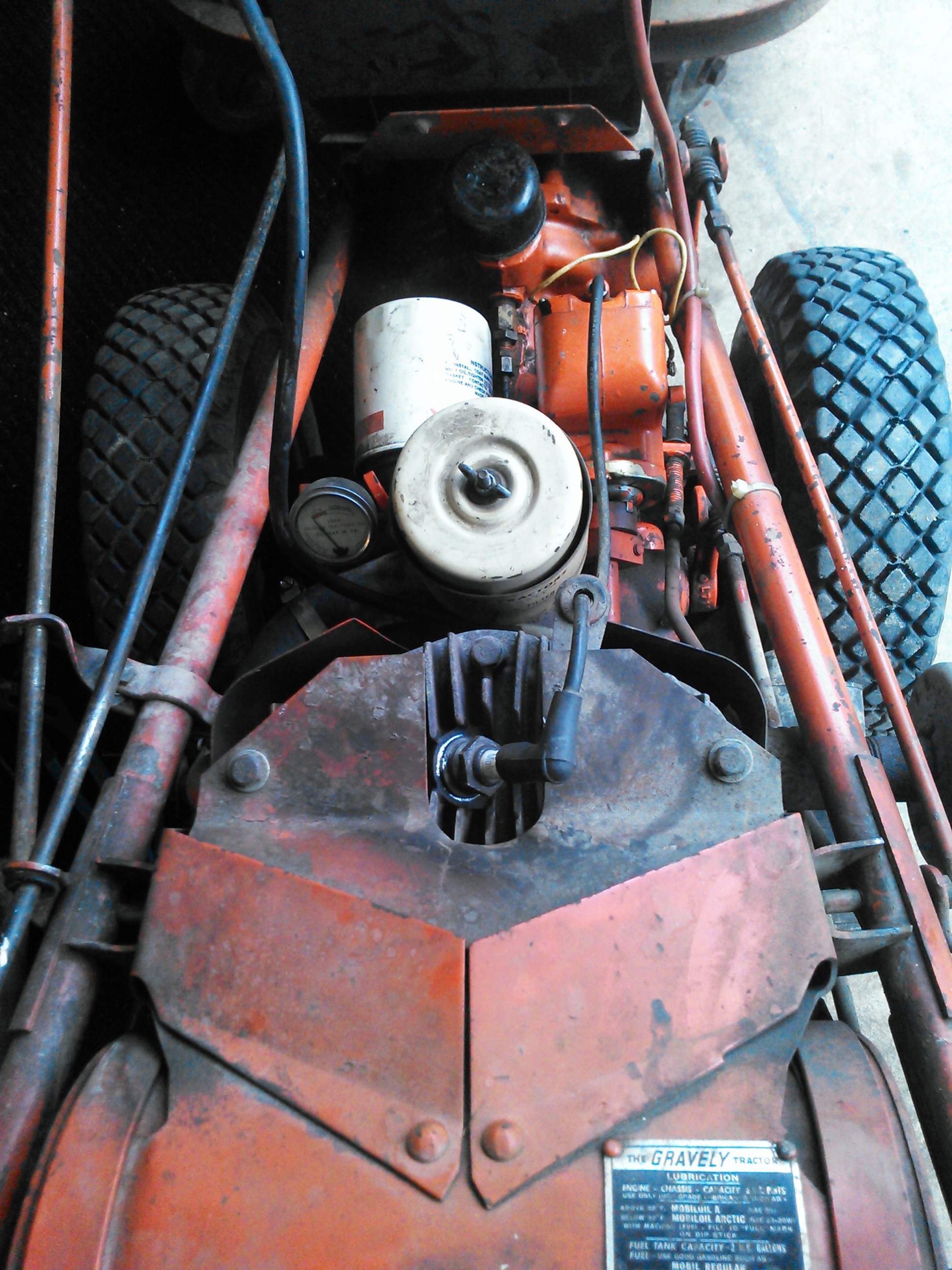

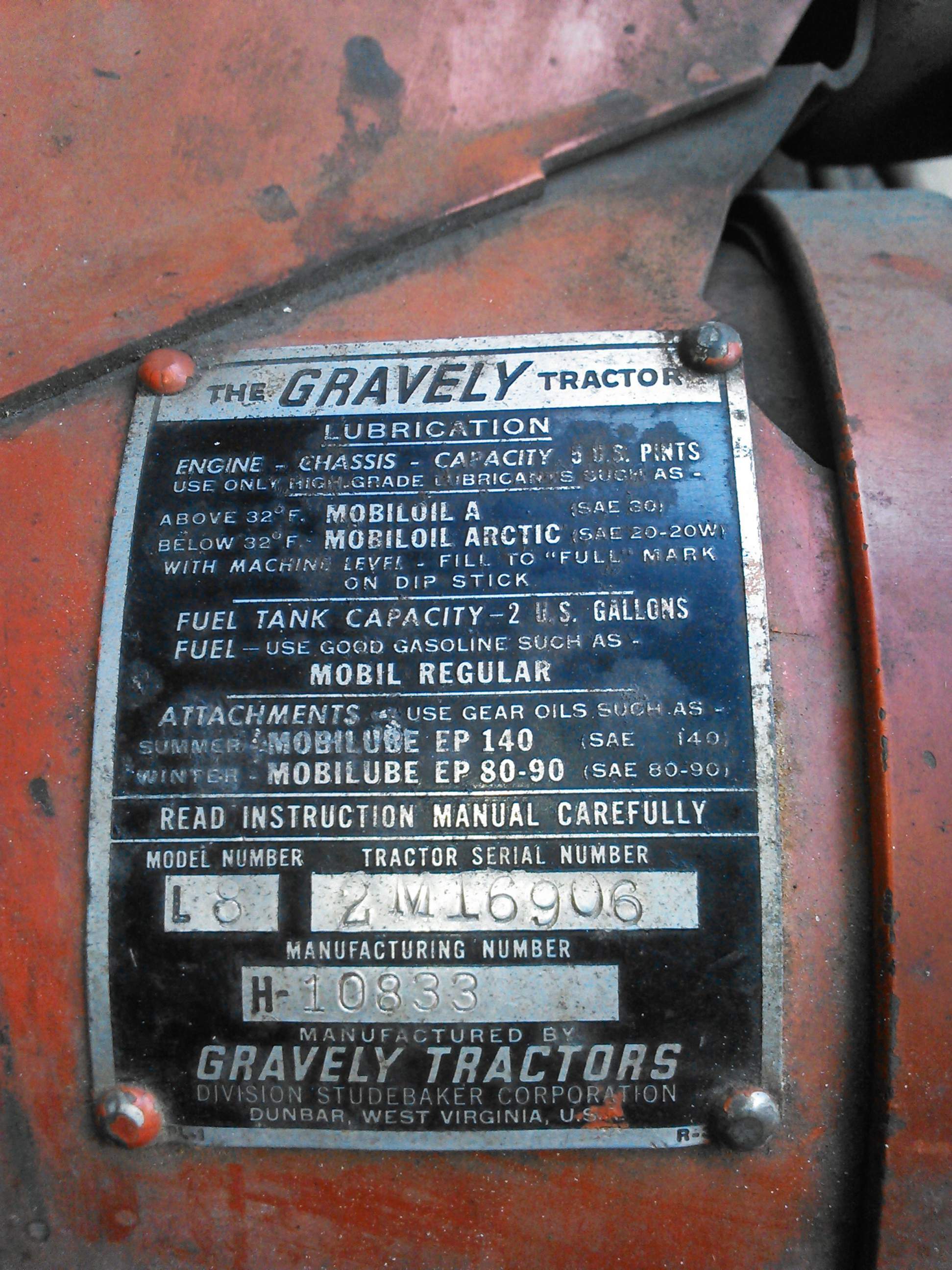

I took the magneto apart and got it working. I installed it on the motor and it fired right up! :thumbsup:
I still want to repower it. Just wanted to know that it ran before taking it apart. I was wondering what the value of the motor is? Is it worth trying to sell or should I scrap it? The carb may need adjusting, but it had good oil pressure and sounded good. Hopping to off set some of the repower cost.
View attachment 362859View attachment 362860View attachment 362861View attachment 362862
The engine and such is worth something to the right person so definitely don't scrap it. But if the engine is running nicely with no smoke or such, I would just run it until it goes. One major benefit of the Gravely engine is that it's pressure lubed, so they're excellent for work on inclines. If you re-power you'd have to go all the way up to about a 16hp twin model, like the Briggs Vanguard 16 hp motor, to get a pressure lube engine. Everything below that is mostly splashed lubed and to just touch the Vanguard new you'd be looking at over $1k just for the engine. IMO, run the Gravely engine until it dies as they're very robust engines and it will serve you just fine.
