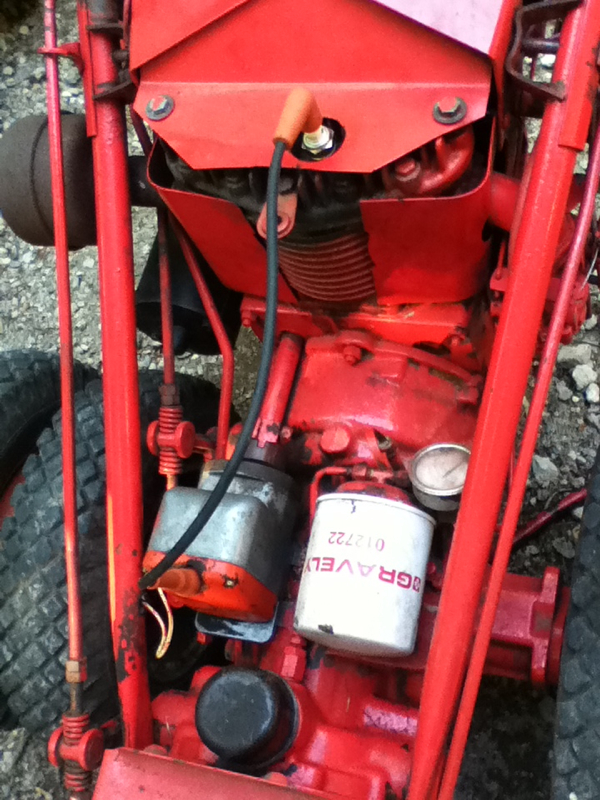

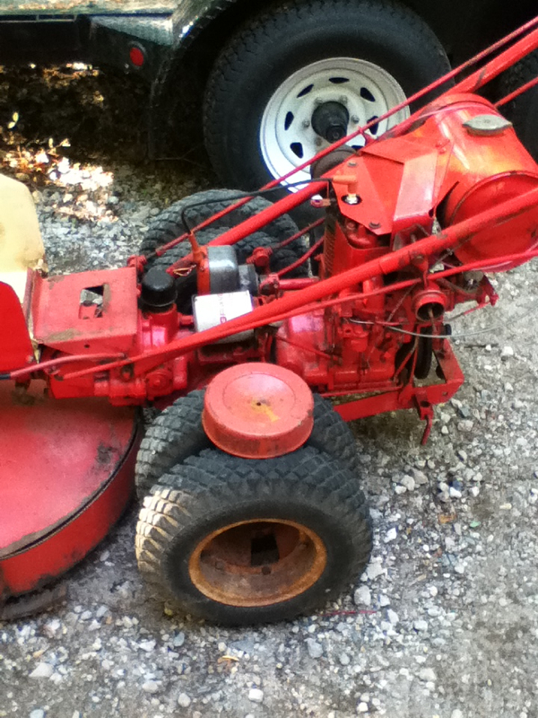

ok now today i figure out the prob with the carb the pin over the float was stuck now shes gettin gas and still no go hoss im confused i could smell it whill crankin it but she just wont go thinkin my mixture is way to lean just a guess
   / Gravely l8 #13
You said you swapped the timing 180 and still nothing. can you turn the engine by hand with the sparkplug out, if so put your finger over the plug hole and when the engine comes up on compression you should feel pressure, bring the piston to top dead center.set your timing.pour a little fuel down the plug hole,put the plug in , hook it up and try it. hopefully she'll at least pop.most carbs have idle circuits that are .015 of an inch, doesnt take much crud to clog them up

#14

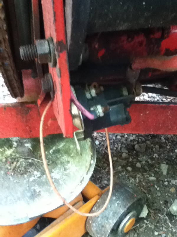

ok thats tomarrows project.. now one more question the startir sylinoid is all mashed up so is that part of the reason it wont fire?

#16

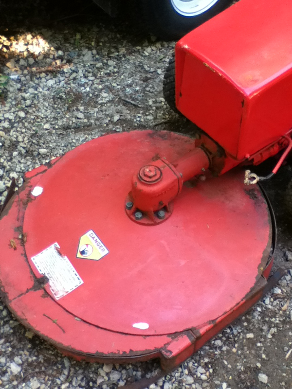

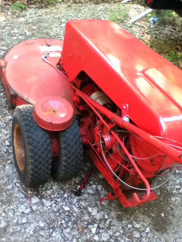

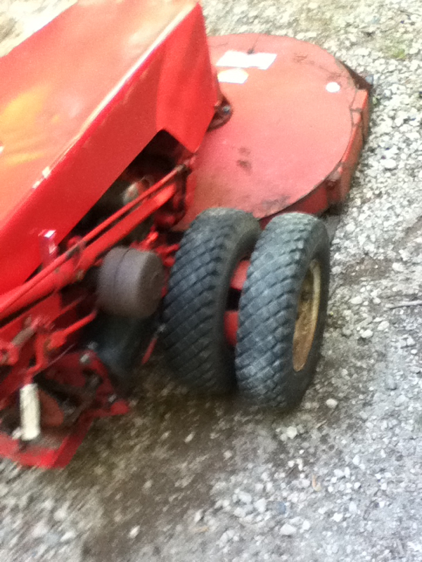

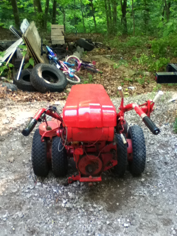

also, looking at the picture i posted, what do you think this would be worth in good running shape? thanks
   / Gravely l8 #17
Maybe between $200 and $400 depending on condition. Some more pictures would be a big help, side profiles as well as under the hood and of the mower. If you decided to sell, send me a PM, I'm just one county over.

here we go
