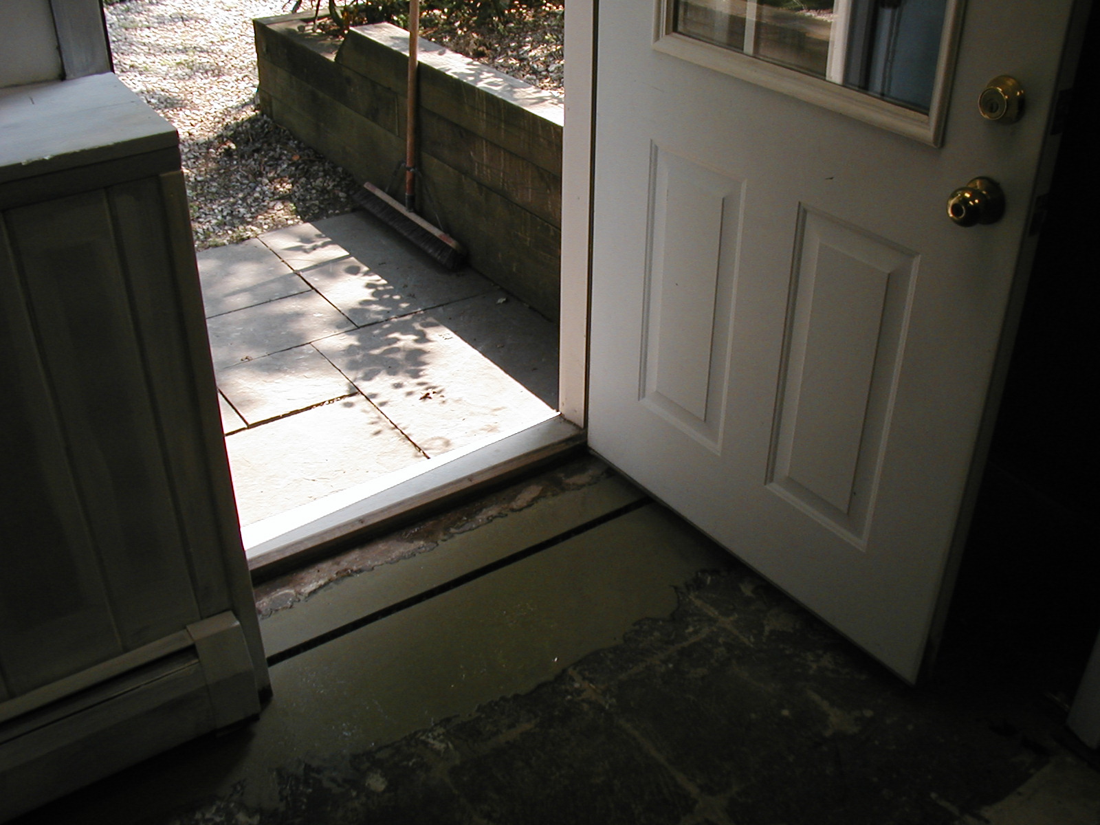

Hi everyone. I would like to finish our basement and am having water issues. There is no sump pump or gravity drain that I have found so far. There are cracks in the slab of the floor and during really big rains, we get water up through those cracks.
I'd like to install a gravity drain under the corner of the slab and run it out the creek behind our house. I'm concerned about digging under the footer to run the start of the drainage tile. Is there a possbility that the footer could settle and damage the foundation? Our basement is made of poured walls, would it be better to bore a hole through the footer rather than dig underneath it?
Also, assuming I can get this gravity drain in, I'd like to fill the cracks and add a sealer to the floor. Does anyone have any suggestions on any of these kinds of products?

The house is a ranch with a walk out basement. The drainage is good at ground level. The area that I considering running the gravity drain is the walk out.
My idea is to tie both downspouts that are on either end of the basement into the gravity drain. I would have to think this would be plenty of drainage and lower the water table (which typically isn't high at all).

Our place has the walk out level across the entire side of the house not just at one entry.
Good idea on the two lines in one ditch. I was planning on using a check valve to help with any clogs of slow drainage but two lines seems to make more sense.
Do you think it's possible to do all of this without a sump basin cut into the floor? Could I do everything under the slab without cutting a hole? Since it's very seldom that we have any water issues, i was thinking about using a 9 x 9 catch basin (or something similar) under the slab.
