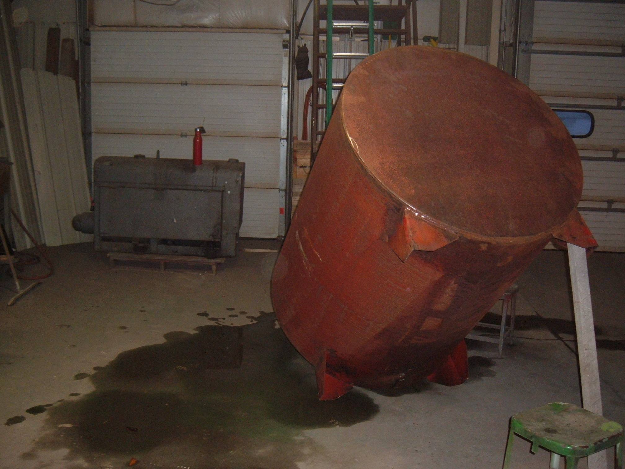

I agree, convenience is the only savings. I had a hole eroding in this one about the size of pencil eraser. Only hole in it. Steamer it out, cut a hole in to look, bottom as good as new, very surprised for a 50 yr old tank,,, new except for 1 spot.

I agree, convenience is the only savings. I had a hole eroding in this one about the size of pencil eraser. Only hole in it. Steamer it out, cut a hole in to look, bottom as good as new, very surprised for a 50 yr old tank,,, new except for 1 spot. View attachment 745318
