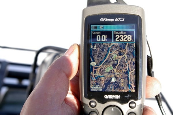

I finally got up to the cabin today. Quite a bit of snow on the ground but GPS'ed the altitude difference from cabin to tank. It was 74 feet which would equate to almost 35 PSI. I'm happy with that.

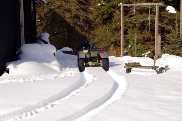

One more pic
