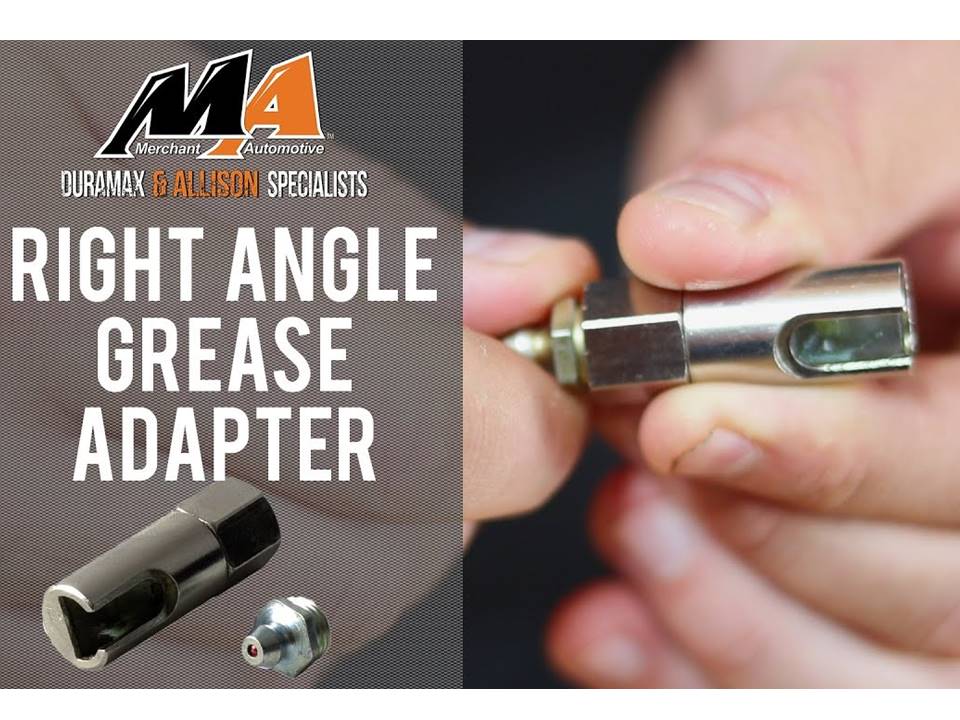

And for those just tuning in, Lock-N-Lube now makes 2 different units, the original, now includes a replacement jaw(s) and O-ring kit with the coupler, AND they now make a longer 'nose' XL model coupler to allow access to those zerk fittings that need a long reach extension. It also includes a parts for rebuild kit in the package. LockNLube(R) Grease Coupler | End Greasing Frustration
And as I searched for the link above I found what some other posters have mentioned seems now available - another brand of locking coupler, shown here:Univer-Co Lock-On Grease Gun Coupler (UC-312) by Univerco (213) Inc for $27.99 in Grease Guns - Accessories - Lube Equipment - Air Compressors - Automotive : Rural King
AND, James KOua made up an adapter to allow using a lincoln branded angle coupler with a standard 1/8 " zerk screwed into it that allows even more flexibility to reach the impossible location zerks, by attaching the angle adapter to any coupler, including a Lock-N-Lube, by clamping the coupler to the zerk attached to the angle coupler.
Here's the item; just add a 1/8" thread zerk into its threaded end and then attach the adapter to whatever coupler is in use on your grease gun hose. Amazon.com: lincoln Model 5883
With teh above info and say a 20volt DeWalt battery operated grease gun, like I received recently for Father's Day, one should be able to grease anything on Planet Earth with extreme ease.

James - after 5 years using the Lock n Lube I have to say it works really well and I probably use it 90% of the time. It does make it harder to get at Zerks in corners and other tight spots, though. After 5 years of getting covered with grease every time I had to change the tip, I found one of those mini grease guns that I'd bought & promptly lost, even before I got the Lock n Lube ... much density, I know. Now I keep a right angle tip on the mini & no Zerk I can't deal with - even without a screwdriver!
   / Grease Gun and a Screwdriver #198
Yep, you are fully armed. Cocked, Locked, and Ready to Rock. :thumbsup:
