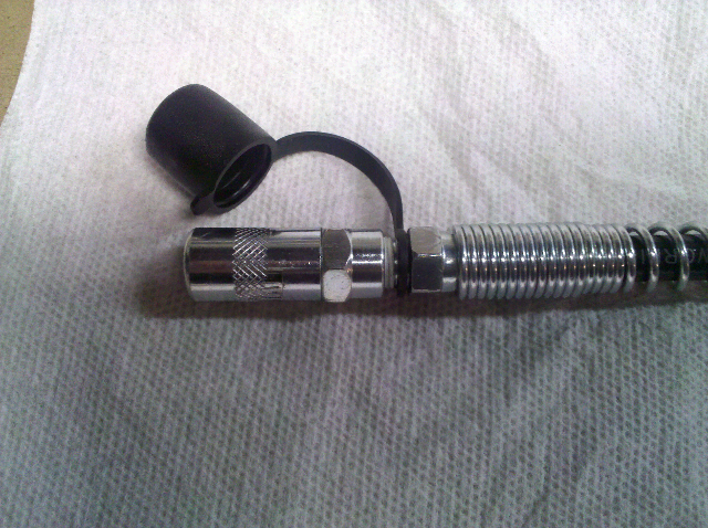

Hey all,
I justhad to attach the pictures below. I am pretty dang sure that there is no knurled knob that retracts the four jaws of my grease nozzle.
As you can see I tried to use force and it failed. Oh well I am guessing that I will have to go out and buy a new tip. Grrr...!!!!
I am quite please to see that it has only taken me 29 years to learn how to properly use grease guns.
~Kevin

Well looks like you were trying to unscrew it, and that is what you need to do to loosen it, are you saying when you had the wrench on the flats of the nut, and the vise grips on the knurled area you were unable to unscrew it? If it was me, I would put as much torque on it as I could, even if it broke into 2 pieces, as it is no good to you as it is. Give it another try, or get a cheater bar or put it in a vise, or whatever it takes to break it loose, because all screwed down tight, it it useless. and you have to get it off to replace it anyway.
James K0UA

Just loosen the tip on the one you have. I have never seen one that didnt loosen.. Of course if you loosen it too much, then grease will squirt from around the threads and it wont stay on by itself.. find the "sweet spot" or happy medium.
James K0UA
