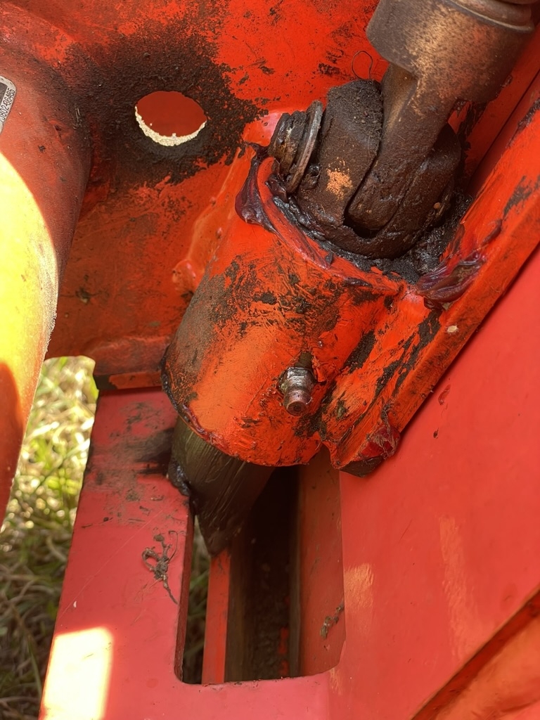

I've had a few of those. In each case, I pulled the pin and removed the rock-hard grease from the passages in the pin. The zerk usually works fine, it's the dried grease that blocks things.

OP, post 10, Oldtrix, this is what I meant, just without removeing the pin entirely. Most likely only the grease at the pin end of the grease gallery is a solid plug.
OP could you please post a photo of the pin so we can see exactly what we are dealing with?

Now there's something I didn't think about. Hell, I didn't even know there was such a thing.
Since I can't turn it, I expect it will be very difficult to pull out.

Fixed!
I took the pin out and used a wire coming in from the back side to clean the area out. A couple times of doing that and using the piston grease zerk cleaner and it finally broke loose.
Below is a photo of the zerk. Taking the pin out was not too difficult. Has a cross pin holding the big pin to the linkage. A cotter pin and it was out.
I cleaned everything up and reassembled and all is good now.
