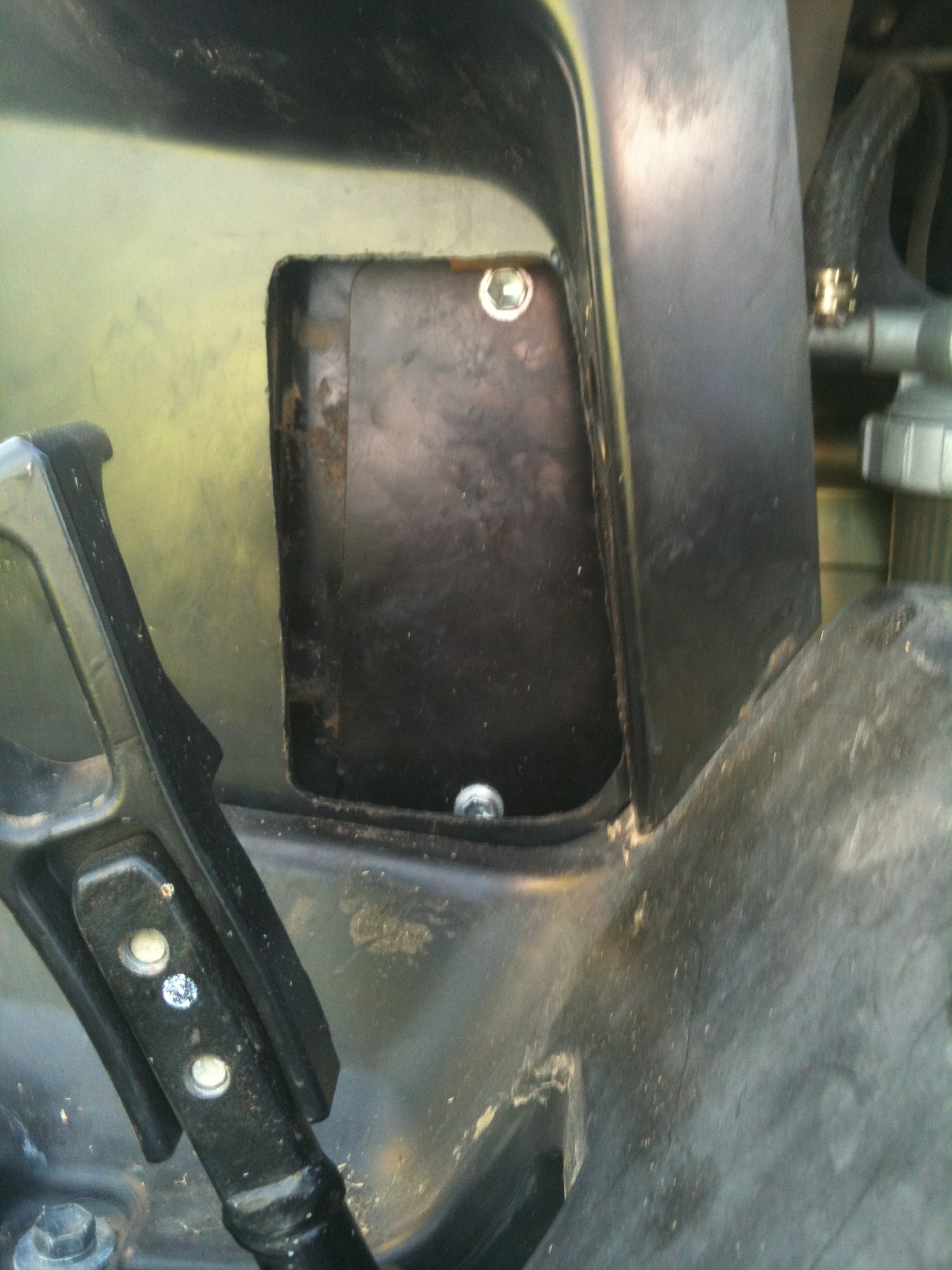

I cut a door in the plastic so I could get to the access plate.
If you do this becareful of the wires on the back of the plastic.
I'll try to attach photo.View attachment 258884
Well I greased that shaft this past weekend. Here is my observations.
Rear u joint: It is accessible from underneath. You can rotate the shaft by grasping the harmonic balancer at the back of the engine.(turns stiffly but it does turn). Once the drive shaft was lines up so I could see the nipple, I just had to adjust the nipple a bit in the u-joint cross so it would allow the grease gun on. I used a pry bar to line this up. Make sure the grease come out of the four caps. Mine was 268hrs and supper dry.
Front joint: NO NEED TO DRILL ANYTHING(really guys it's a Deere, no hill billy stuff PLEASE!). Remove the throttle level, one bolt, than two more bolt on either side of the upper dash, now its as loose as it needs to be. Remove the 6 or so bolts that hold the lower dash, remove the two cotter pins that hold the cruise control and park brake levers. Voila the lower dash comes right out! Now you can see the famous side access panel, remove it. now you can see the drive shaft again. You can access from the panel if you so choose or go from the center of the floor board(I found this easier). I bet things would be smoother with needle a adapter for the grease gun, I didn't have one.
Extra thoughts: The first time will take an hour or so, but the second time can be done in 15 minutes. The worst part is actually getting the grease gun on the fitting as those u-joints are so small.
Good luck, (not as bad as it sounds but there is a lack of engineering!!)
