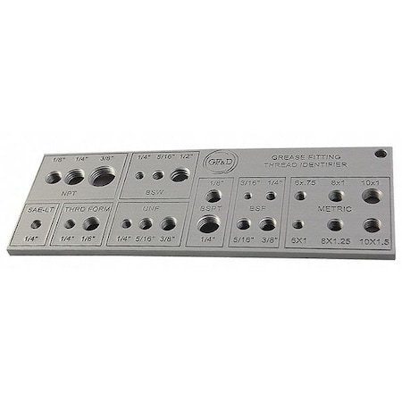

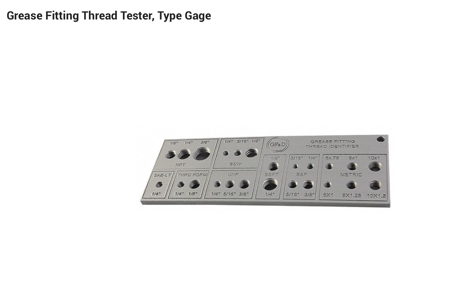

Someday I am going to get a "Grease Zerk Thread Gauge". Zoro.com has what looks to be a nice one for under thirty bucks. It identifies twenty some odd different zerk threads & is made in the USA....maybe.
They also sell a plastic one from India that is more expensive. You gotta wonder why?
They also sell a plastic one from India that is more expensive. You gotta wonder why?View attachment 712124

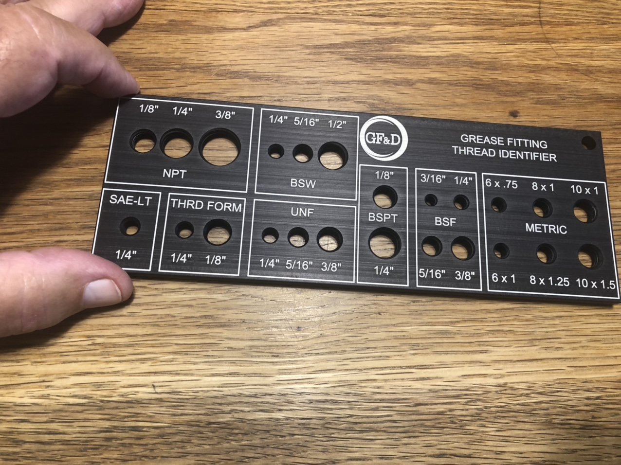

Zoro tool frequently have coupons up to 30% off. Used 15% discount coupon and ordered two zerk thread gauges for $45.22. No tax and free shipping. 2nd one will be for my BIL. Now maybe I can finally get a better handle on the different types of fittings.
Have an assortment of metric zerks but have only found few import pillow block bearing they fit. None on the tractors. Similar assortment set for British threads cost 10x$. Hopefully with a gauge now can know and keep a few of the right kind on hand for replacement.
/ Greasing a B21 BH Pivot #12
From ZORO tool. Anodized aluminum plate.

Fitting out some zerks for the old JD today. Thanks to SmokeyDog I ordered a thread gauge from ZORO last year about this time.
Looks like there at least 3 different thread sizes on the tractor...maybe more. Nothing Metric or British so far.
Not sure just what the difference is between 1/8 NPT and 1/8 THRD FORM.
