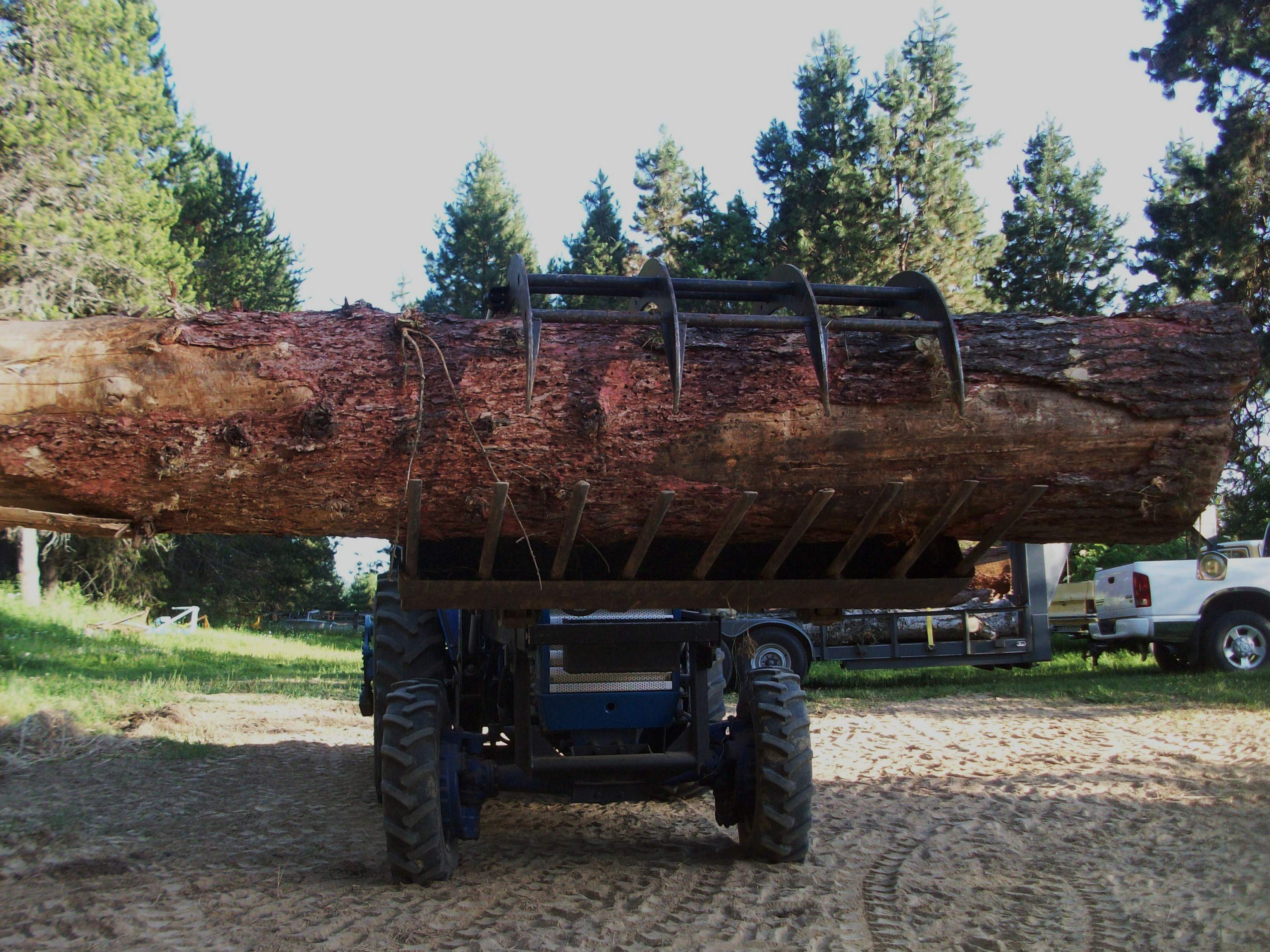

Nothing wrong with the Koyker's here's a shot of mine carrying a good sized stick of fire wood- and it has over 20 years of use under its belt firewood load 2 2013 008.jpg and it is still going strong

wow. and thats the Rhino carrying that.. impressive strength.

Holy cow! I thought that picture was a fake when I opened it at first. How heavy would that log be?

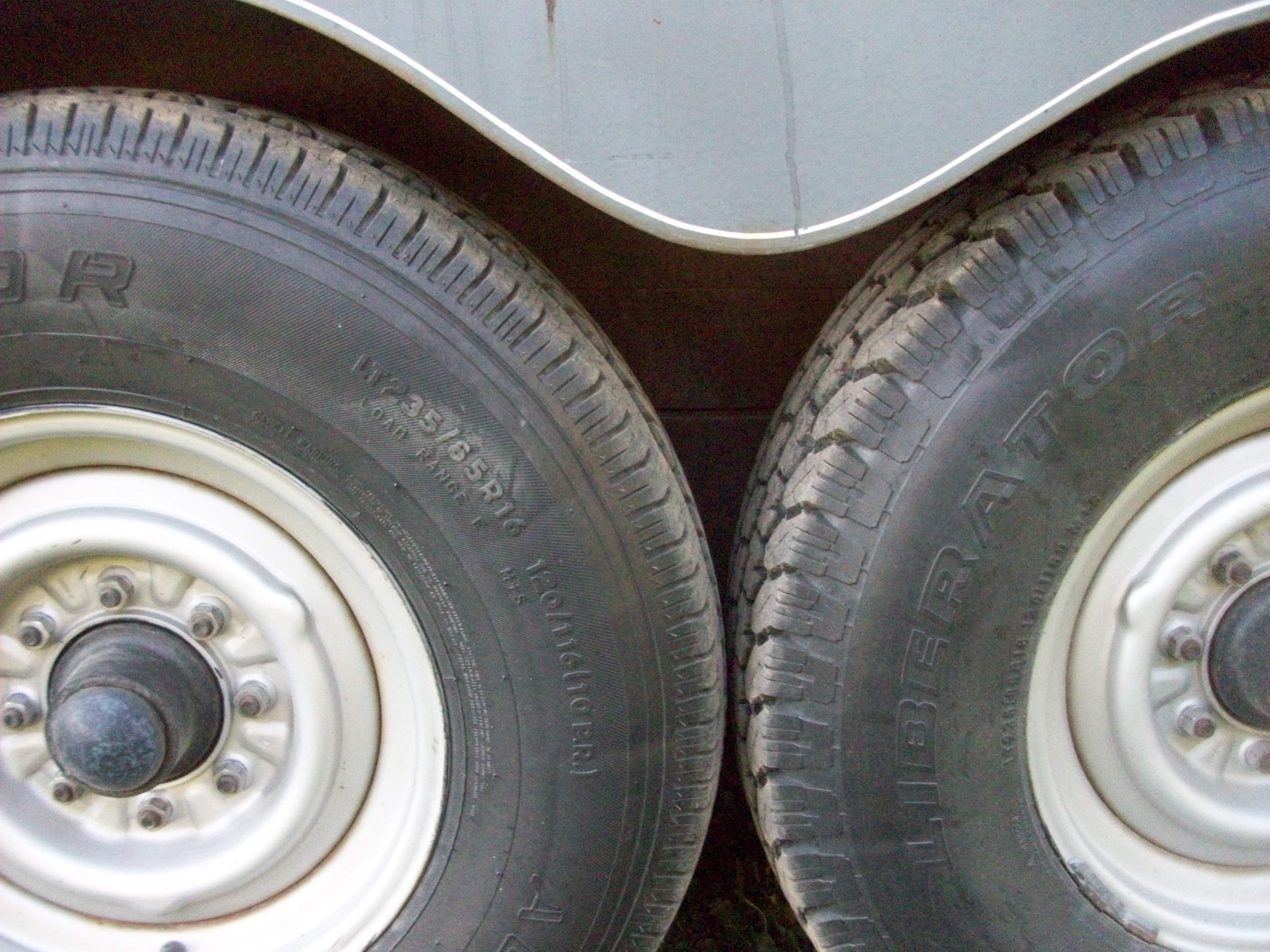

Fairly heavy, but i'm pretty sure the smaller diameter birch i got in the same load were actually heavier- all the trees were alive when cut- and when i bucked up some of the birch water actually ran out, the loader picked it all up and non of it pushed the hydraulics into bypass although it was about as heavy as I would want to carry especially with the added weight of the grapple, here's what the trailer tires looked like firewood load 2 2013 002.jpg 10k load rated 5th wheel, not going to load it that heavy ever again either:laughing: at least it was only a 5 mile trip.
