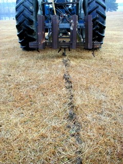

I think I would mark my sprinkler locations (and elbows/Tees), dig a hole with a shovel and then connect the dots with the plow/pipe.
One would have starting/ending places and a hole to work in.
Just an Idea.

</font><font color="blue" class="small">( I can see how this would work with wire or cable and or flexible pipe but I dont see how it would work with PVC as some have stated they are using. Are you gluing all the joints together and laying them down behind where they need to be buried and then pulling them in? )</font>
Yes. You pull the glued-up PVC pipe underground like a rope. No kinking, no reels, no barb fittings. I've used both roll pipe and PVC, and PVC works much better. Plus you can get telescoping dresser couplings in PVC for cutting into or repairing a line.

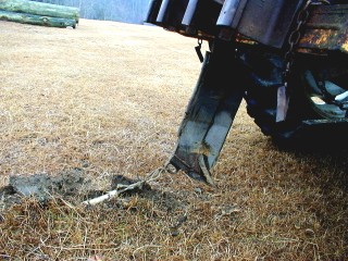

Here's a picture of my plow foot. The pulling head on the pipe is just a cap drilled for an eyebolt.
gabby

Nice rig gabby.

So, my questions are: 1). Have you ever put down large diameter (2" Schedule 40) PVC using your rig? 2). If so, how did you handle the horizontal curves and bends?

Yes I have plowed 2" pipe but not for long distances, plus I have put pretty good curves in it.
I can't believe you need 2" diameter pipe. I have a line that goes at least 3,000 feet to a water trough for 135 head of cows and calves. It's 1" reduced to 3/4" for the last several hundred feet and it keeps the 150 gallon trough w/float valve full with no problem. I bet that doesn't calculate, so don't get too hung up on your calculations. It's city water so there's plenty of pressure.
Your biggest challenge is the 2' depth. You will definitely have to make multiple passes with a stout plow and a stout tractor before going "live" with the pipe, but it will be much quicker and cheaper than trenching.
Trenching is not an option for me because you can never completely fill the trenches and they get boggy and settle and become potential leg-breakers for galloping horses. None of this happens with plowing. Good luck!

</font><font color="blue" class="small">( I'm thinking I may need a connection between the loader and the cap on the pipe that's more than just an eye bolt. Any suggestion about strengthening the connection link?)</font>
Protect it from rocks with metal wings on each side. I have never has an eye bolt fail due to the friction load.
