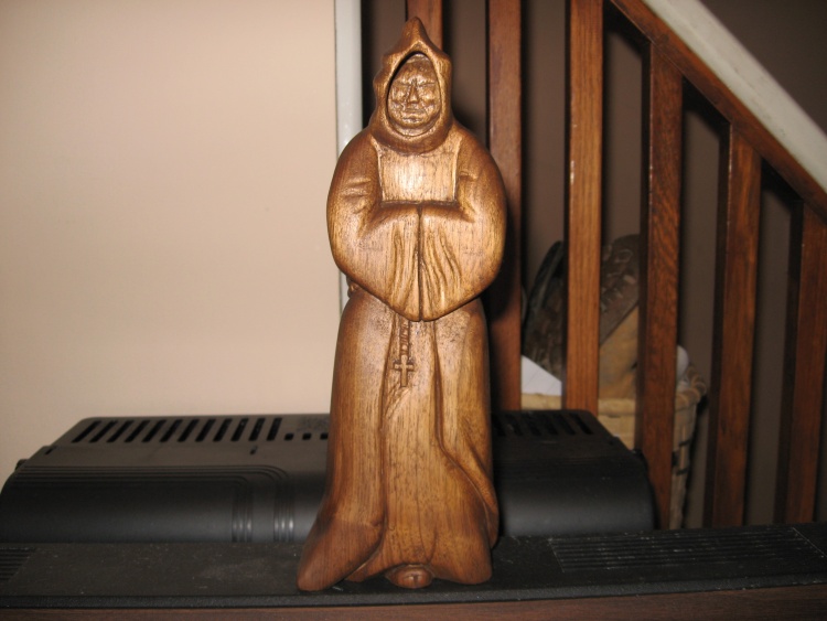

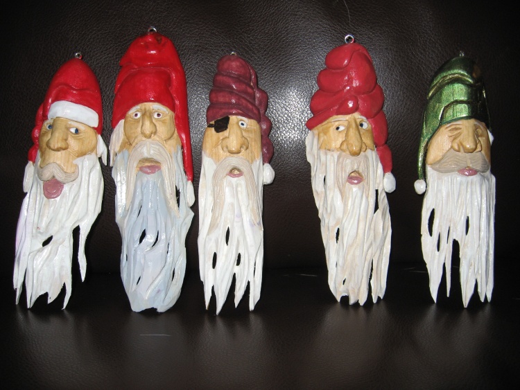

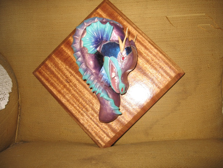

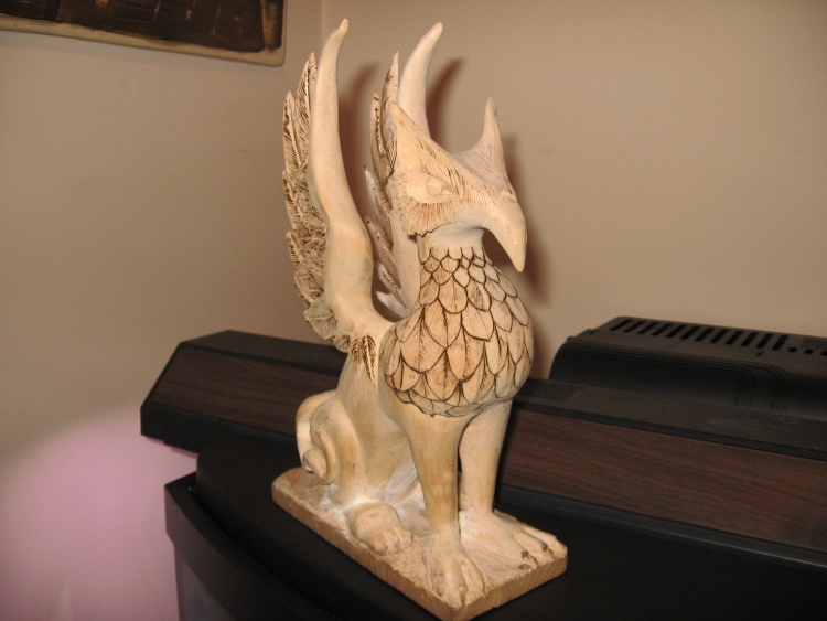

On e of my hobbies is woodcarving (see pictures) and I use a felt wheel with compond to put a final edge on my tools. One thing that makes it easier is to rig up the grinder so the wheel turns away from you and not toward you. This way you can see the edge you are working on without the chance of getting the edge caught in the wheel and sending the tool flying.
