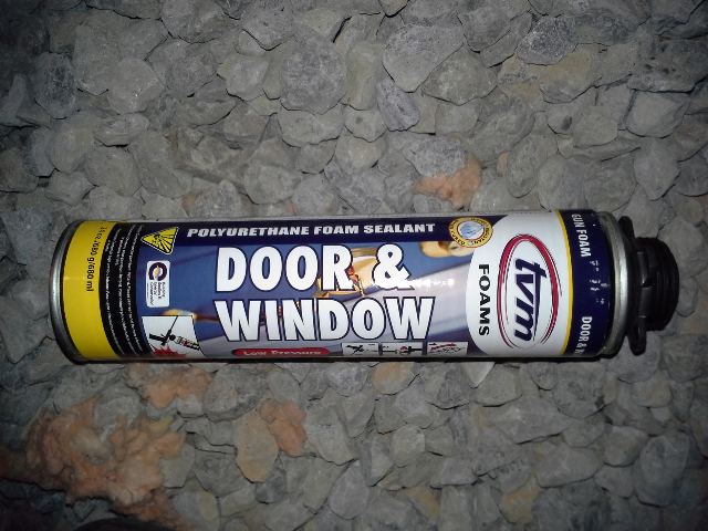

What brand is better for larger gaps??? (only heard of "Great Stuff")
There's a few dozen different brands that I have crossed and likely just as many that I haven't.
This is my personal favorite at the moment:
About 3x the yield and don't have to clean the gun 1/10th as often. Another huge plus, the surface sets very quickly that if you happen to touch it before fully cured, you aren't covered in the sticky mess.
We used about 300 cans this summer of various brands. This was hands down our favorite. If the gap was anything above 1.5" or so, I'd run a double pass with about 15 min between.
