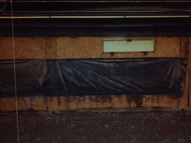

I have 4 20,000sqft barns. I am trying to tighten them up and make it easier to heat. 6 foot eves. I was looking for commercial equipment. As I know of a few more guys around that maybe interested in it also. They all have more barns than me. Figured it up and I was going to need 33 of the 600ft kits just to do one. That's like 30k. Needs to be more cost effective for me.

We have had a lot of it sprayfoaming done at work and it isnt cheap. Are you trying to spray the whole interior or just the seams?
I would get a couple of sprayfoam contractors out for quotes and possibly arrange with your neighbors to spray their places at the same time with the same crew to save on travel/setup costs.
Material costs will be cheaper per square foot to use a 55 gallon drum with a heated pumping system (like a contractor has), they should warranty their work and they will have less waste for a learning curve. If you do it yourself, look for bigger kits, 1200 board foot kits (such as FOAM IT 1202 Class 1 Open Cell Anti-Microbial DIY Spray Foam Kit - Weatherproofing Window Insulation Kits - Amazon.com ) are common and will generally be cheaper per SF than a smaller kit
You might look to find a cold storage warehouse near you and see if they recommend a particular company.

You don't want to use the 600 board, NOT square foot, froth packs for any job near that big. They can vary in consistency, and are somewhat date of mfg. time & extremely temperature sensitive, especially in winter months. They're good for a bathroom/kitchen remodel.
IMHO, you want your job done by a highly recommended professional outfit who can send you to see their existing work/customers. You could get a huge job quote for the all at once approach with your neighbors, and possibly save significantly.
The only place I know of even remotely near you is:Contact Windows on Washington Your Home Improvement Specialist
They are very active on another board I frequent: DIY Chatroom Home Improvement Forum
I suggest you contact them via the link above, and see if they can recommend a contact in your area. Also go to diychatroom.com and see out answers to your question there. They have many pros who answer questions about what you want to know.

Looking to mainly seal for better ventilation. Here's a picture of a wall panel.
The building is modular built. Steel trusses every 10 feet. Boards cover them. Prefab panels between. Lots of air leaks here. The plastic is covering a hole where a ventilation curtain use to be. Added double bubble and metal to outside and just covered hole with plastic. No insulation left in wall. Bugs have eat it out. Looking at a high density closed cell foam. So I haven't decided if I want to do whole wall or just problem spots.
Thinking of buying the equipment because I think I could pay for it with labor savings.
