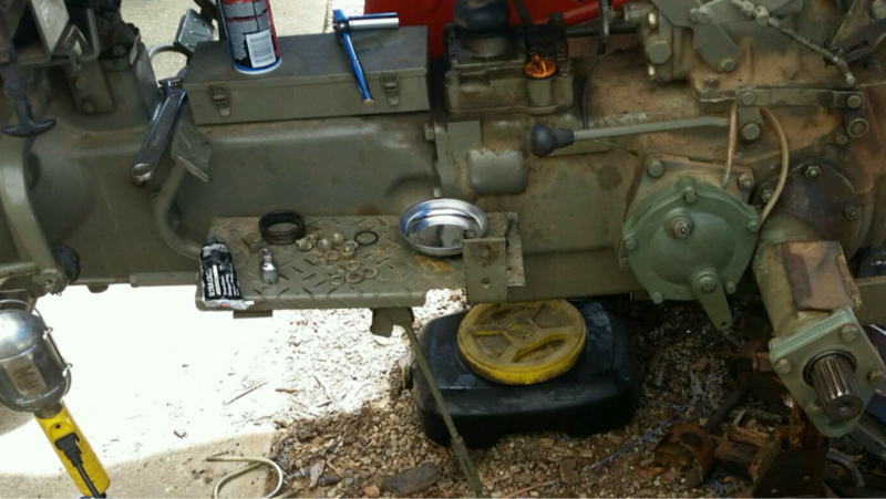

Did a little more looking and see that the 1700 has a combined transmission/rear axle housing and the 1500 has a transmission housing and a separate rear axle housing. Maybe that could add length? :confused3:

Hey hey Winston!! I think you have it! Now that you mentioned that, I do remember reading or seeing that somewhere. If I can find the pics I will post them. I'm glad you found that. I'm pretty sure that's why it is shorter....Now if I only knew about the foot room between the 2 of them.

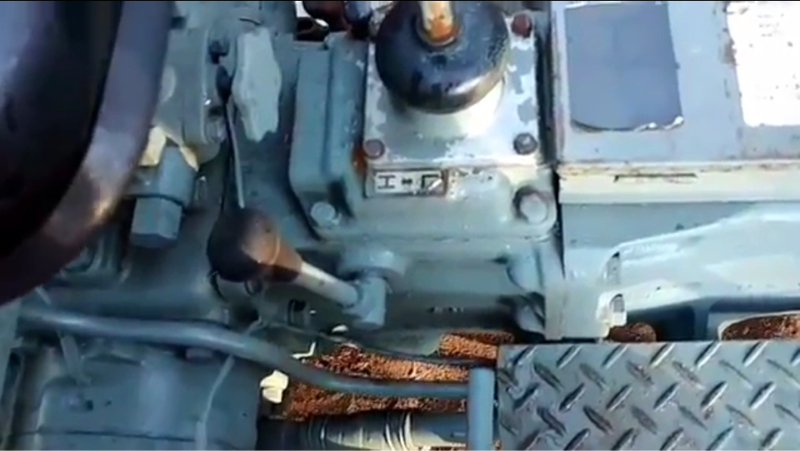

Winston I found the pictures. First is the 1500d. You can see the bolt on piece between the rear axle and transmission. The second picture is actually a 2000d but same as a 1700d. It's molded like you said. Glad you dug into that for me. I don't know how I forgot about that. image-1865841496.jpg

Somebody was asking about the clutch hold-down lever but I can't find the post where that was asked. Anyhow ... it is visible in this second photo.
It's hinged from a bolt at its top. Push down the clutch pedal, swing the lower part of the lever forward to hold the pedal down.

You are correct California, that second photo does show that lever. I remember seeing a thread that asked about that but don't remember where at the moment. I believe that is to keep your clutch depressed, & should be used if your tractor sits for an extended period of time, or used in high humidity areas to keep your clutch from getting stuck to the flywheel. Correct me if I'm wrong.
