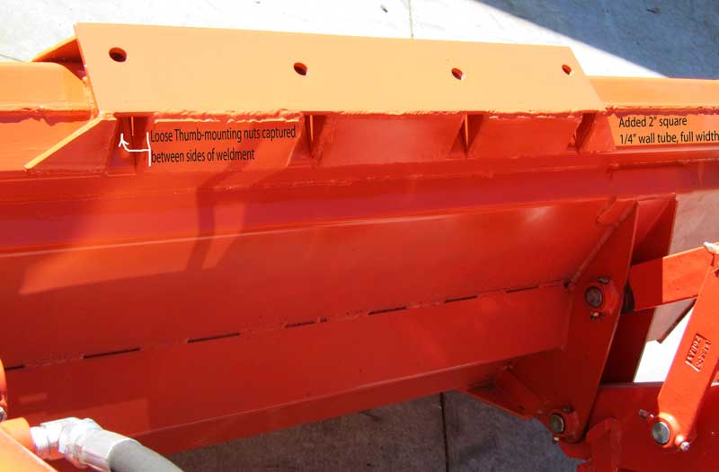

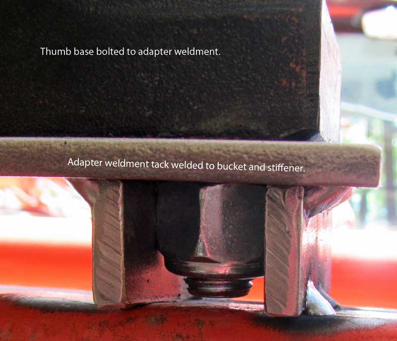

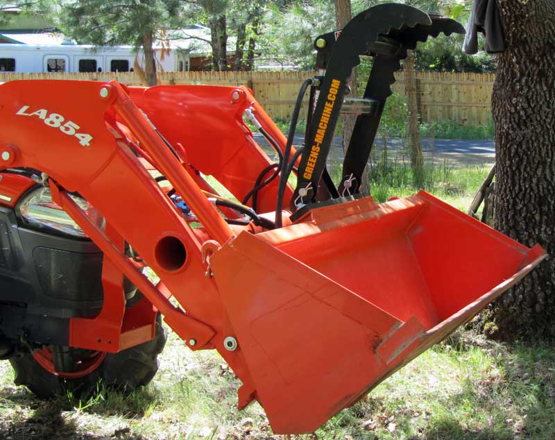

Well the Thumb arrived to my door in less then two days. I odered Tuesday morning and it was on my doorstep today when I arrived home.
It was packaged in three boxes for weight? The thumb in one, #2 had the cylinder, and #3 the mounting bracket.
Now I just have to wait for my tractor to be done at the dealer. He said it would be done on Monday.
I need to figure out how I want to brace the bucket. Im thinking a piece of C channel across the top. That will give me a place to weld some hooks to as well.
Here's how I mounted one.

i am about to start this project myself. did you do the set up for the hydo. power to the unit or did the dealer do it? would love to see some pics of how its plumbed. any info would help
   / Greens-Machine The Thumb #13
My dealer already had my hydrualics done(for my snow plow),check other post on doing your-self(WR Long divertor I believe).
