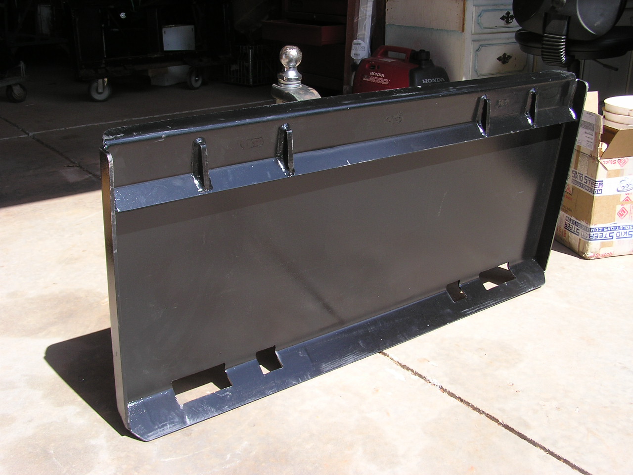

Got it today, Friday.
It is the strongest plate that I have seen on a hitch and the receivers are a one piece casting. Came with grade 8 bolts for the tapped mounting holes.

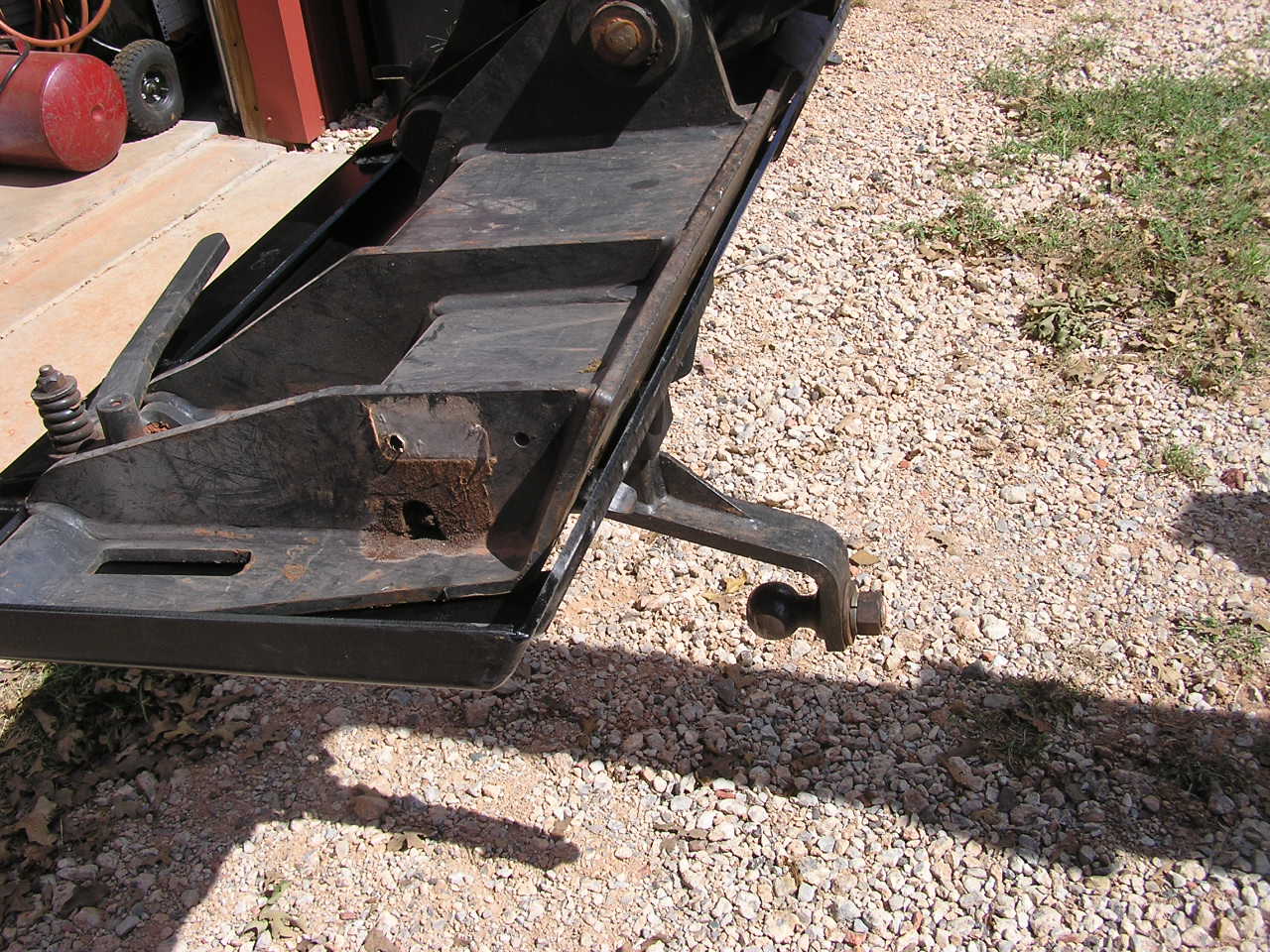

Good fit at the top, a little gap at the bottom, but the latch pins have good penetration.

Well that turned out great and I see what you mean by that added vision :thumbsup: And yes, sometimes their can be a little space but you are correct by realizing that as long as your pins penetrate, then it will work flawlessly. Thank you for the excellent photos and well thought out review, we really appreciate the detail and of course those photos.
All of the Eterra products are over engineered for added reliability and resiliency. All pieces are powder coated and Eterra only use the finest components, castings and hardware. :D

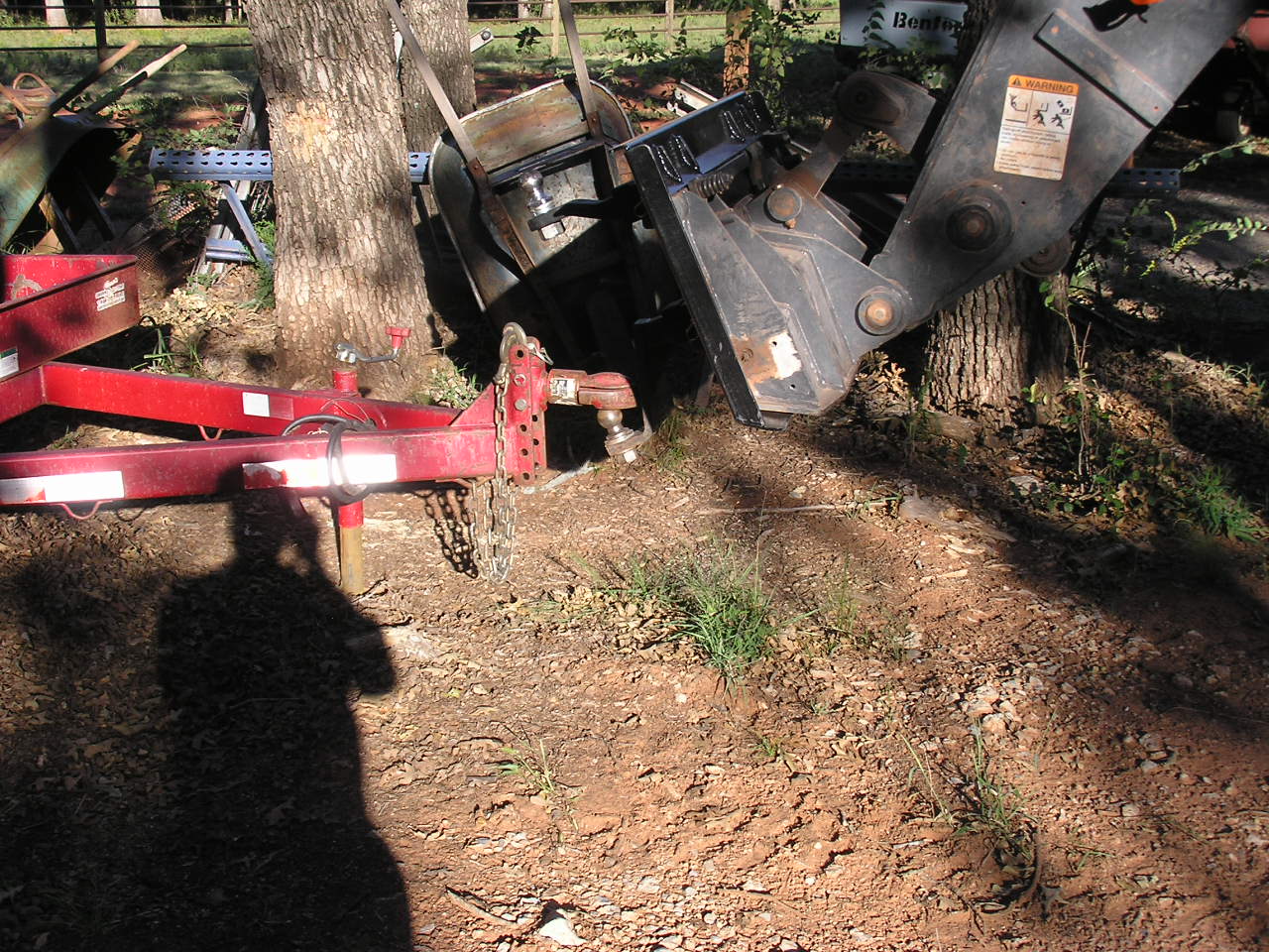

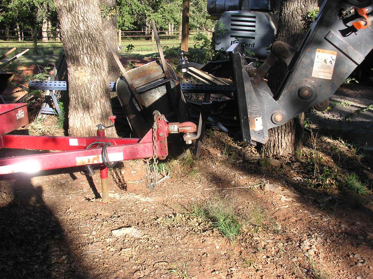

The view from the seat, hooking up a trailer with the lower ball mount.
Raised the boom and curled down enough to see the top of the ball.
Moved forward until the ball was under the coupler.
The side view.
Curled up and moved it, don't even need to latch it on to park it.
Sure like the Dual Hitch Plate. :thumbsup:

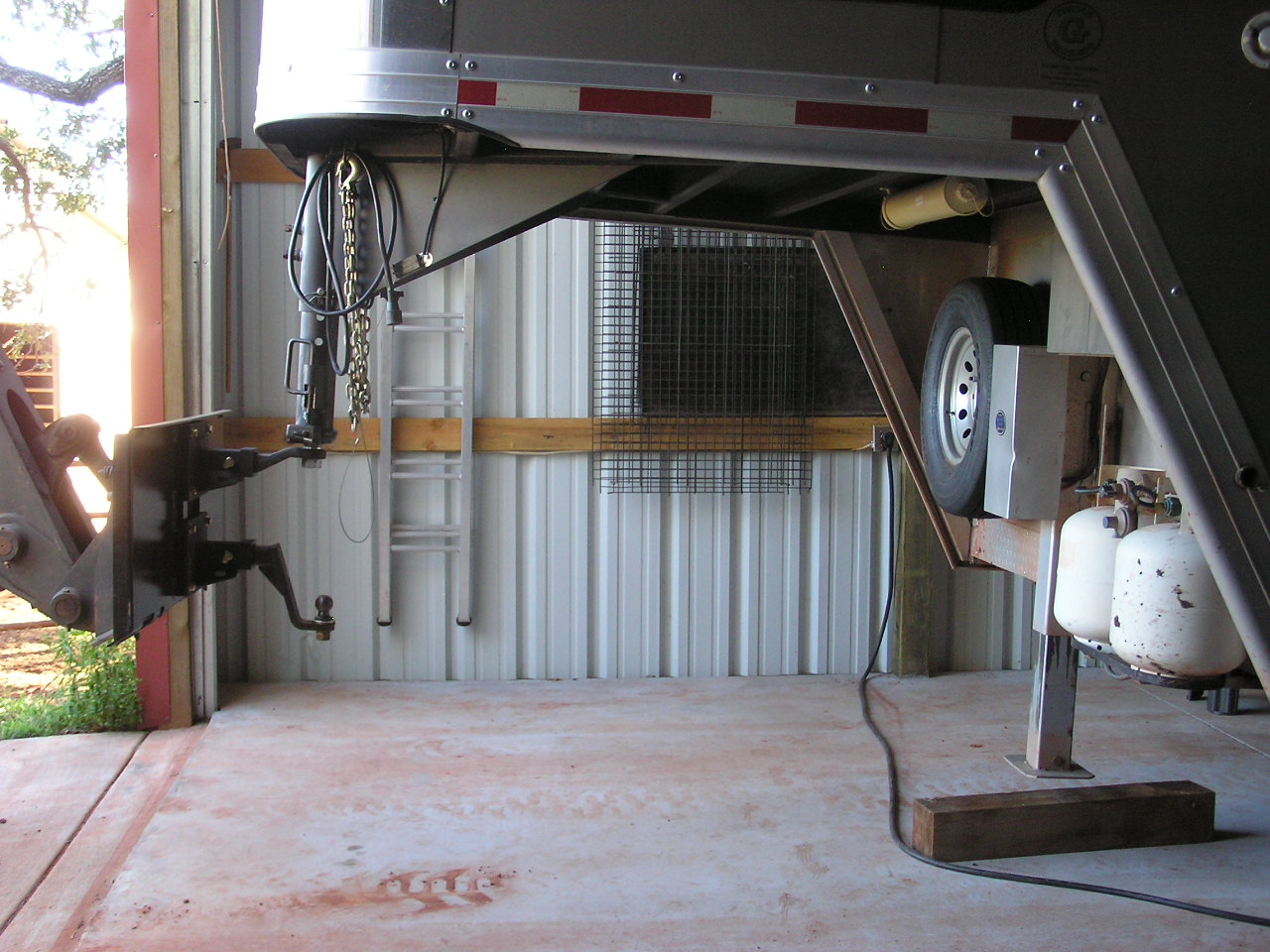

Here is another view from the seat showing the ball.
Opened the door, pulled forward until the ball is under the gooseneck hitch.
Raised the boom.
3,560 pounds on the ball, note the jack plate is off of the wood.
I have used the Eterra Dual Plate Hitch many times to back the horse trailer into the barn. :thumbsup:
