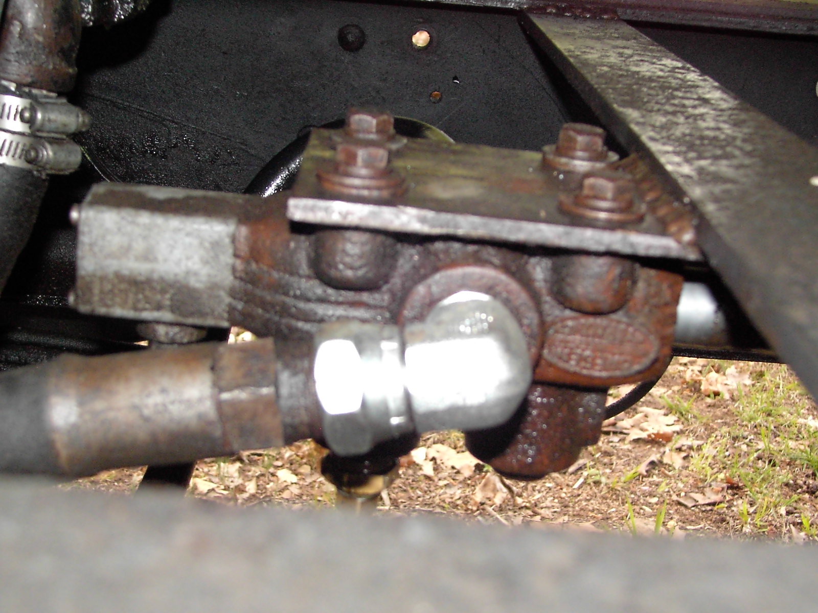

Hey JJ. Here is some pics of the valve and the way it is plumbed now. There is now, no "external " tank, only using cylinder as reservoir. Yes, there was an external tank before, even though the cylinder is of the "self reservoir" type, but when external tank was in the system, would time after time, blow out the gasket of the piston end "end cap", so I bypassed the "external" tank, and now, no blowing out of the gasket. Before with external tank in system, gasket would blow when piston reached the end of it's travel. By the way, there are no "port" markings, so I have no idea which port would be A, B, etc. and thanks so much for your time.

/ Gresen 550 #47
Your center picture shows both work ports plugged, with two other hoses connected to something.
How is anything working as cyl need the A and B work ports to function.
A single action cyl needs one of the ports to work, or it can use two just so the relief doesn't go off.
Something is wrong with that picture.
/ Gresen 550 #48
the center pic is showing the valve mounted inverted. The two hoses, one comes from the PTO and the other goes to cylinder. I did take the "cylinder" hose from its side mounted location and revered locations on the "bottom" with the "brass plug". Operation of the bed was the same.
Here is the plumbing - large hose from "cylinder return"(external pipe into base of cylinder), then to PTO, out of PTO to valve, from valve to cylinder.
You are calling the two ports on what is now the bottom as A & B?

/ Gresen 550 #50
Thanks and yes, but from the pics, can you tell me which is "in" ports and which are out? There are no "bossed" markings, only the logo of
Greson Hydraulics. If the valve were right side up, there are two ports on top and one each side.
/ Gresen 550 #51
The side port are the IN and OUT.
In the center picture, the relief valve appears to be close to the IN port which is on top in the picture.
/ Gresen 550 #52
So, this valve will not work in this system as it is now? or do I need a "T" installed in the "reservoir" line? Remembering that now, there is no "external" reservoir tank, only the cylinder acting as "self contained" reservoir.
/ Gresen 550 #53
