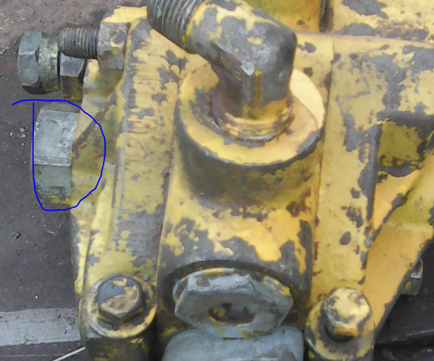

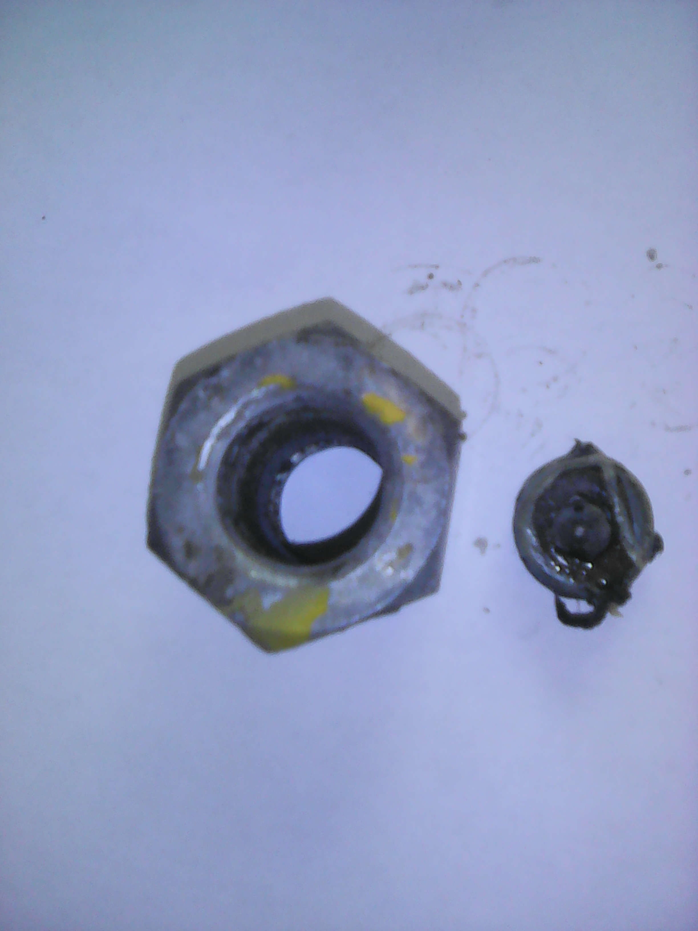

I've attached 2 pics that I took of the valve. hope that it helps.

Some hyd valves are convertible from closed center to open center & vice-verse. Can you remove plug outlined in blue and post a photo of plug & it's components? When JD announced tractors in 1960 utilizing closed-center hyd's their representatives talked about the "fuel savings" of closed center pumps not having to pump oil when not required.

Tx Jim - you are amazing! I have removed the outer (the big) nut and underneath there was located a plug with an allen socket. after removing it - blowing air into the inlet yield air output from that port. now, please let me ask this: as far as I understand I have to connect this port to the tank so that the oil running during idle will flow back to the tank. when I will push or pull the operating lever, the flow should cease since the pressure is diverted to the cylinder. am I right? one more question, would you know if this valve contains a build in relief valve?
one more thing regarding the closed center mode and it is meant to save energy, but in this mode of operation the pump is constantly working against load since the center is closed, or I'm missing something?
Thanx.

Ding,Ding you're the winner. Yes you're correct on routing hose from PBY fitting to tank for open center hyd system.
Closed center hyd pump has a stroke control valve that when established pressure is reached(2250 on most JD's) SC valve causes pressure to be diverted to pump crankcase which pushes pistons away from rotating pump shaft causing pump to stop pumping the pressure is also contained in the hyd supply lines. When a hyd function is activated pressure in crankcase drops allowing springs to push pump pistons against rotating shaft causing pump to commence pumping.

One more thing that came up (for me) is that after the modification the new PBY port will be where the plug originally was, as Tx Jim said. so, my question is what is the port next to that? it is the port next to the one that TX Jim circled in blue on the pic that I've posted. is it the original PBY port and if so, should it be plugged now?
/ Gresen Hydraulics valve #20
Fitting next to plug outlined in blue is the out port which should be connected to tank. In an earlier post I mis-stated that PBY on should go to tank when in reality it should be attached to next hyd function.
What hyd system or tractor are you desiring to utilize this valve on?
