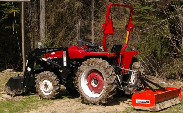

I see puddles of oil under a lot of Harley Davidsons so whats up with that?? I have a chinese tractor and it works fine. Eveything has its problems. You's are all looking for a justification of why you own Japenese, Asian or whatever. You probably drive foreign cars also... Easy to slander what you never owned..Relax.....It's only a tractor...
