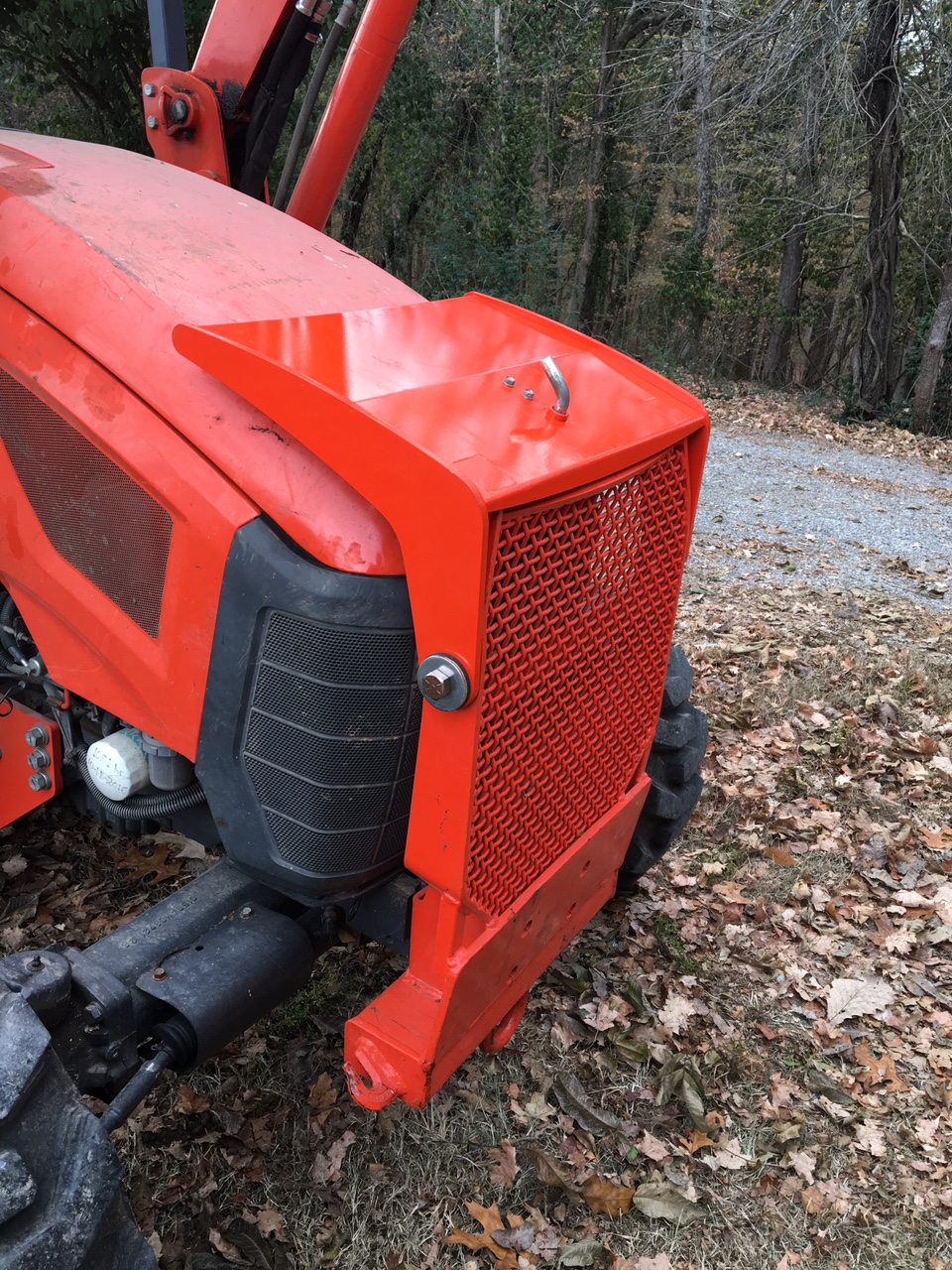

JMC - "what is OEM & what is fabbed". OEM is the frame. This includes the entire outer band and horizontal bar & vertical bar on the upper half. All the expanded metal and "tongue" were added...
Thanks, oosik. My frame is solid and yours appears to be hinged. I had assumed you fabbed the hinge as well.
/ Grill guard improvements #22
The OEM guard IS hinged. I have to tip the guard forward when I lift the hood. That's why the "tongue" is tipped forward also. It allows the guard to tip forward sufficiently.
BTW - I DO NOT do brush very often. Almost completely big rocks and big lengths of Ponderosa pine trunk. However - the few times I have done brush - that expanded metal addition has save me two times - that I know of.
The OEM guard, as it came on the tractor, is just great for stopping things such as garbage cans, 55 gallon drums, large root wads, etc.

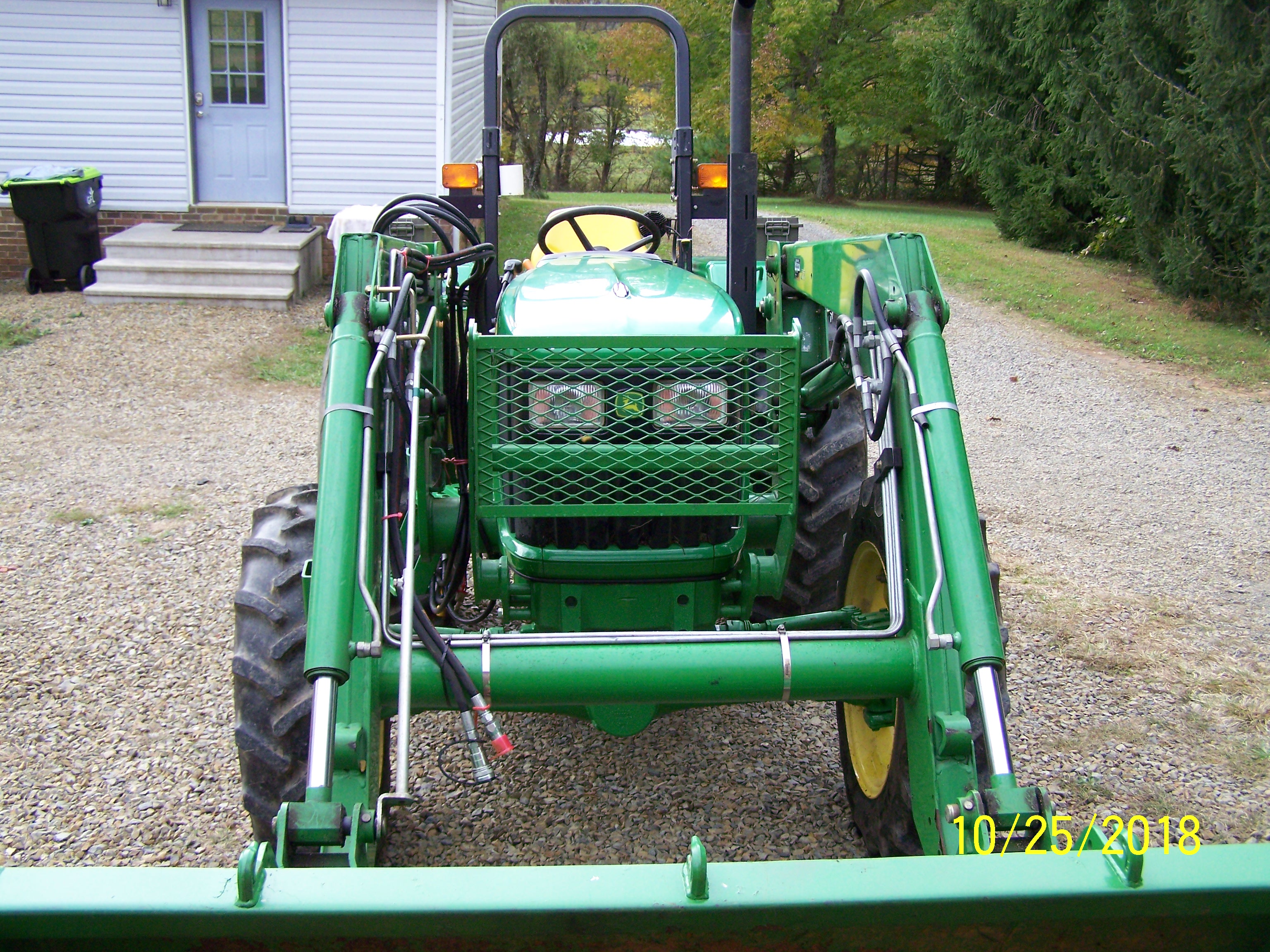

Here is the factory (optional) grill guard on my JD. It wasn't great, but it did cover most of the grill.
It's actually sold in two parts!
Without the screen it's pretty worthless.

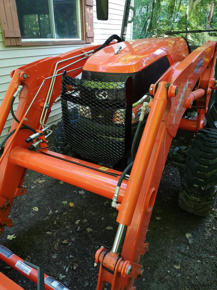

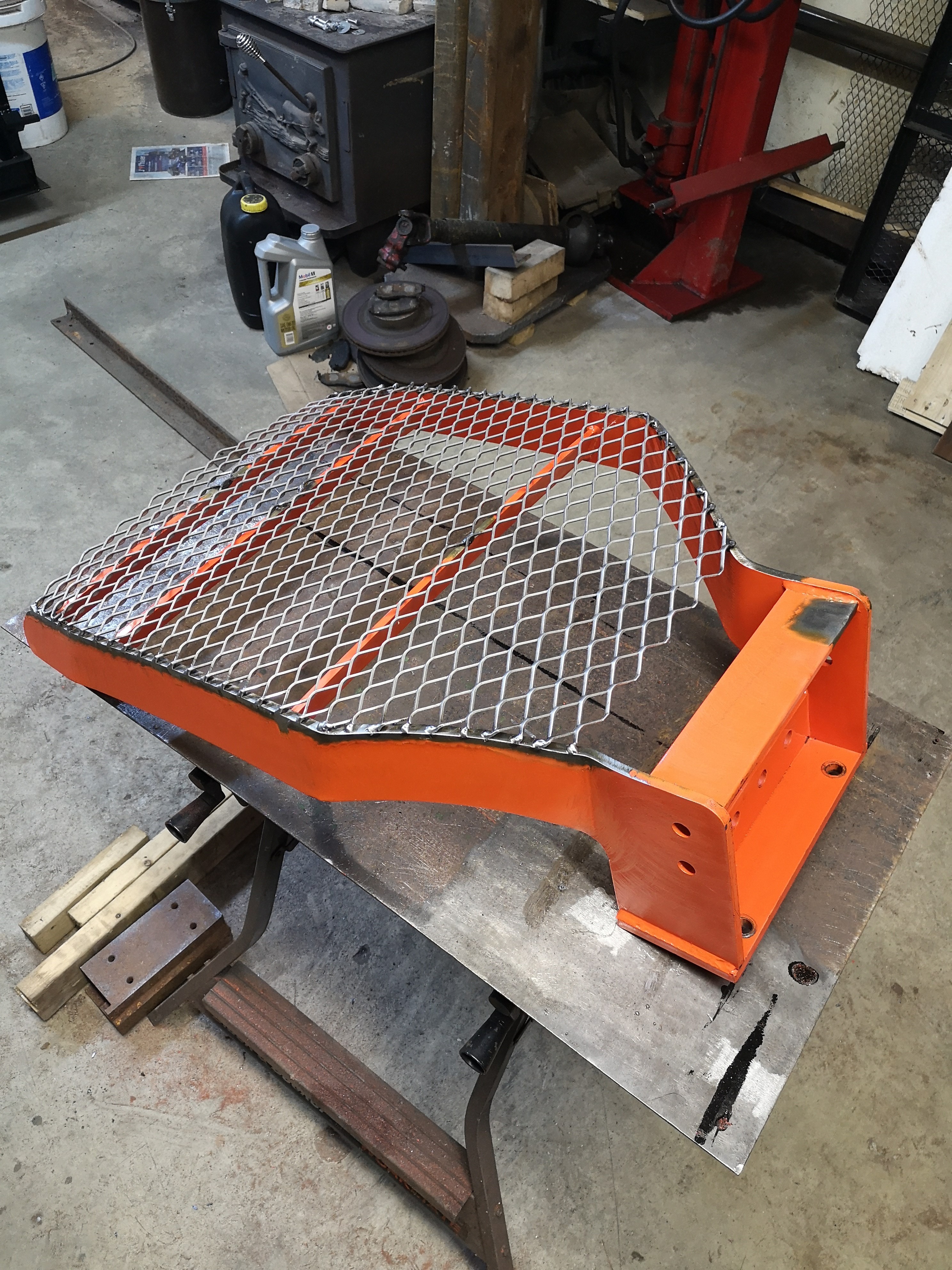

My version built onto the OEM guard.

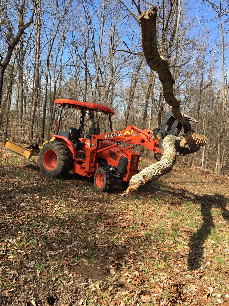

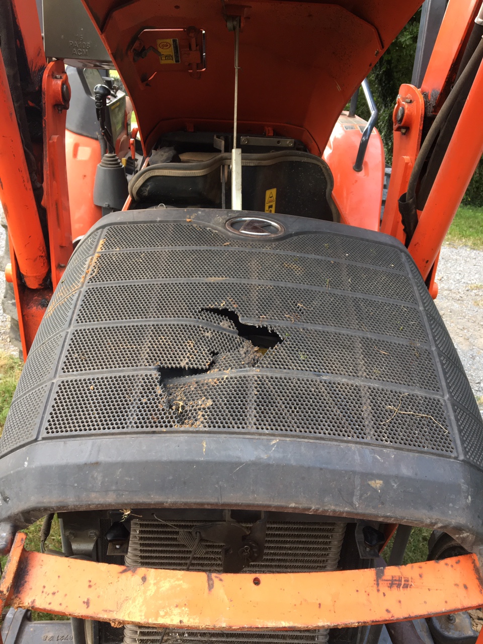

Tying some topics together concerning grills. With the grill off to install brush guard screens would be a good time to install a good tie down point. Hooks, D-ring, receiver hitch or whatever. The front axle is a poor choice for routine trailering. Front bumper protects and pushes down brush when bush hogging. Just today had 6” limb snap out of the pile while stacking storm damage debris with the M59. Scuffed some paint, but no damage.
Adding some bars to secure the expanded metal around all edges helps to add strength.
IMG_0663.JPG B26 grill guard.
Stainless steel expanded metal from scrapyard. Choose to install behind the bars. 3x5” angle iron bottom supports the screen and keeps sticks from coming up. Hitch makes for a good tie down point but really pretty useless with a FEL.

Thanks jmc, everything modded on the tractor gets painted corrostop gloss black enamel because I don't have the heart to pay top dollar for kubota orange.
jbacon2 nice that you were able to protect the sides as well those grill parts sure are expensive.

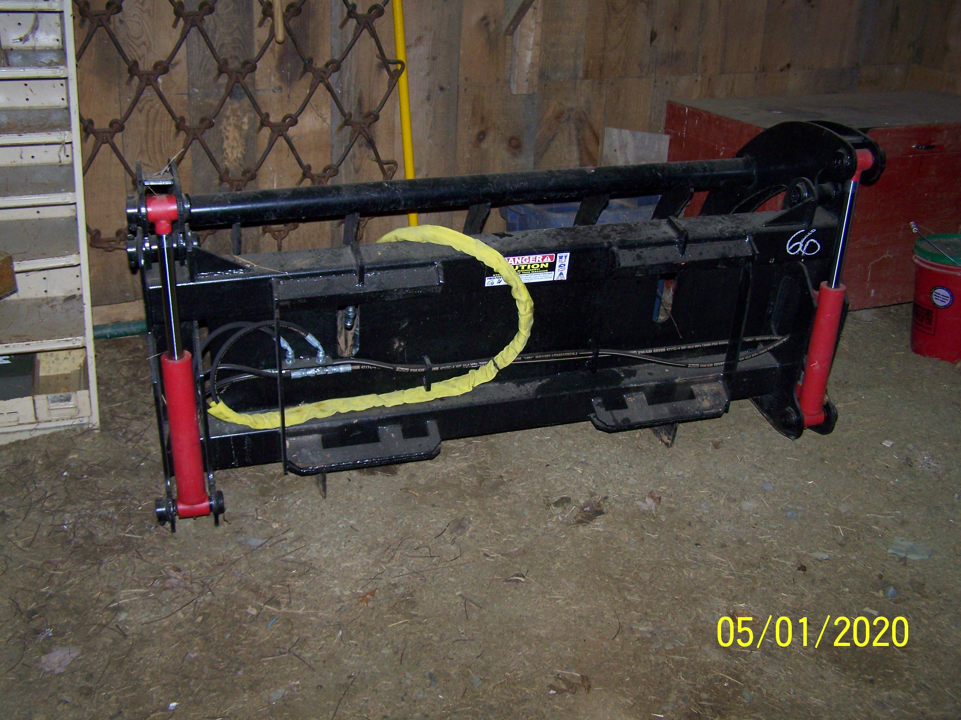

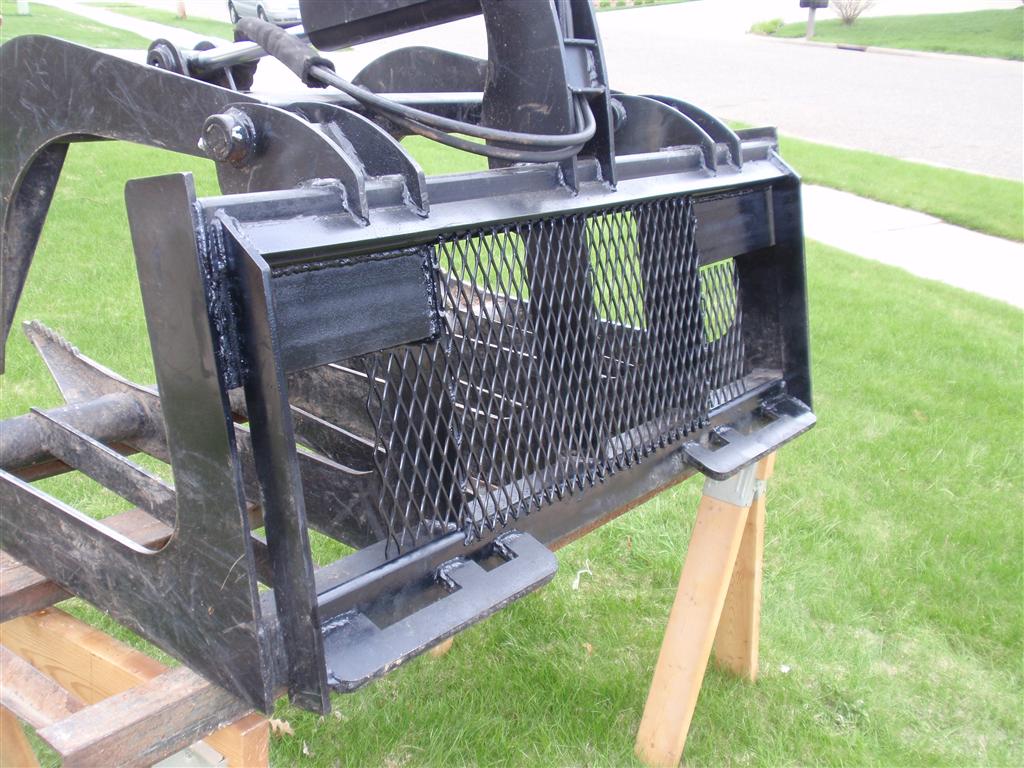

There is another trick I did on my grapple that also helps do 2 things - 1. Protect the tractor and 2. help you munch a bigger bite of brush. See pics below
/ Grill guard improvements #39
Mr. Dstig, do you find brush gets hung up more with the expanded metal when you dump?
/ Grill guard improvements #40
Very rarely and nothing of note. Maybe a small stick once in a while gets stuck. As long as the openings are small enough and the mesh sturdy enough you get a lot of benefits from it with basically zero downsides.
