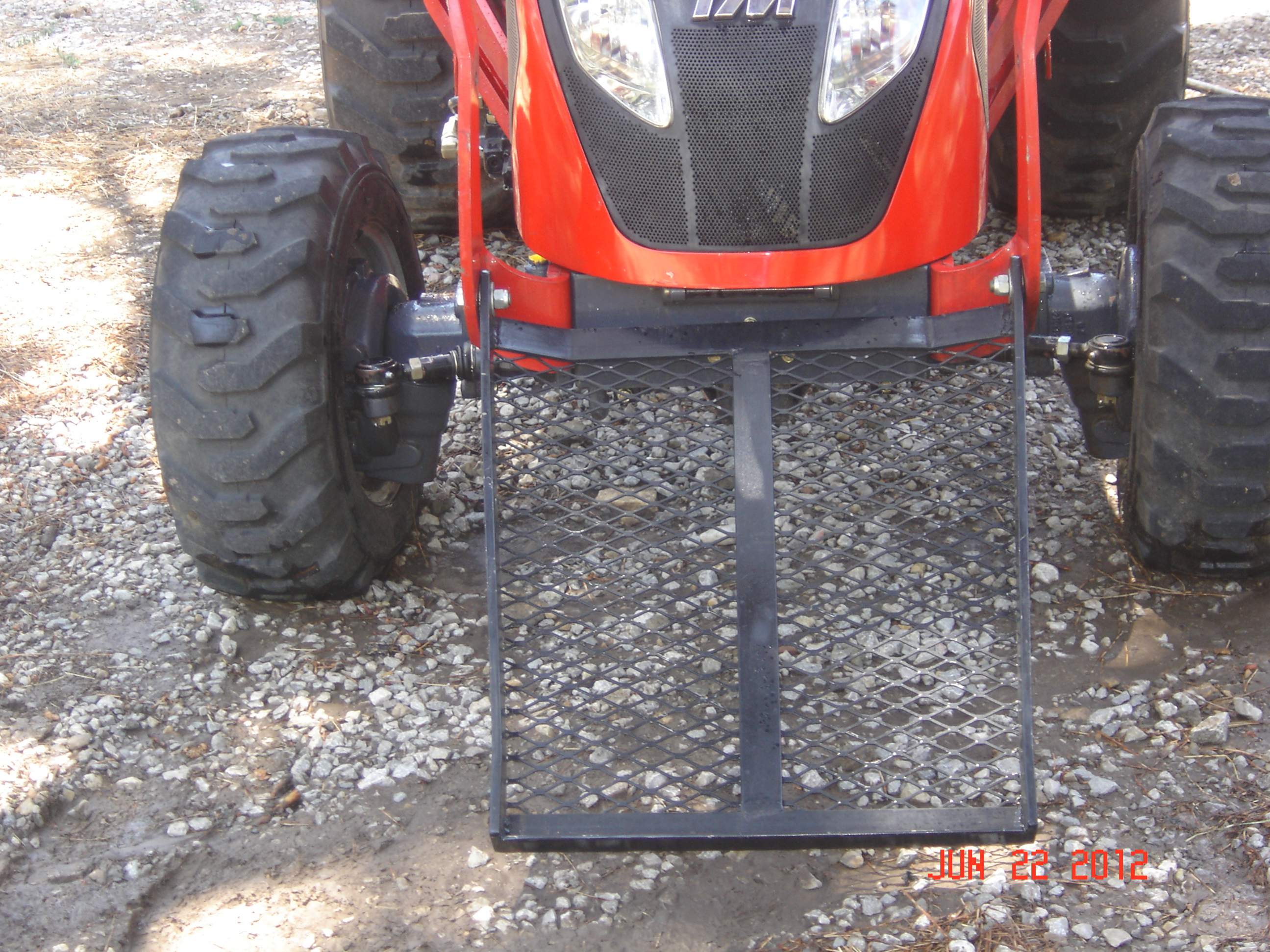

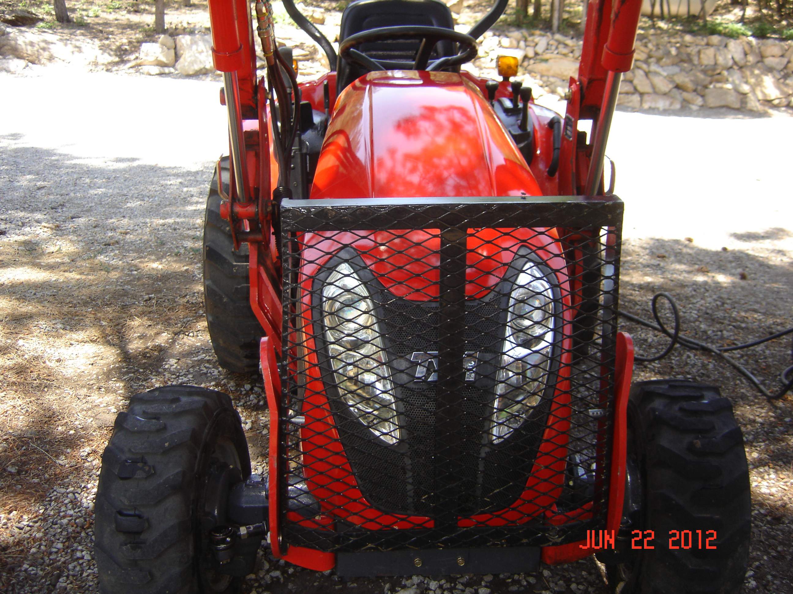

I work with a lot of trees and needed to protect my grill on my T273. I came up with this grill guard. It isn稚 very pretty but it sure works well.

It looks like a good solution and a nifty installation.

Looks Good, did the stock guard not protect the front end enough for your application?
/ Grill guard
No the stock guard did not stop the trees from damaging my grill. I have a forest on my property and when I move downed trees the branches damage my grill.

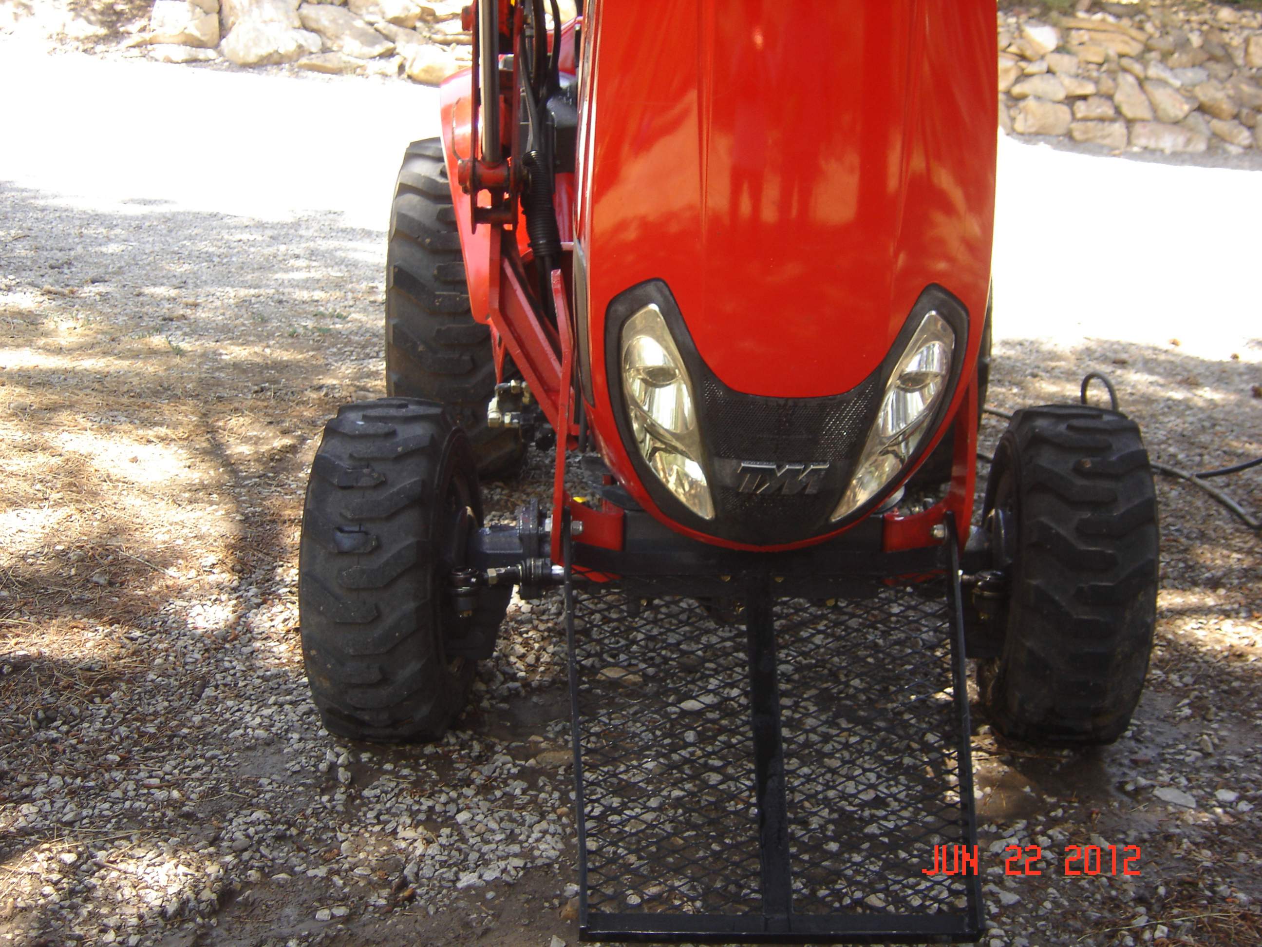

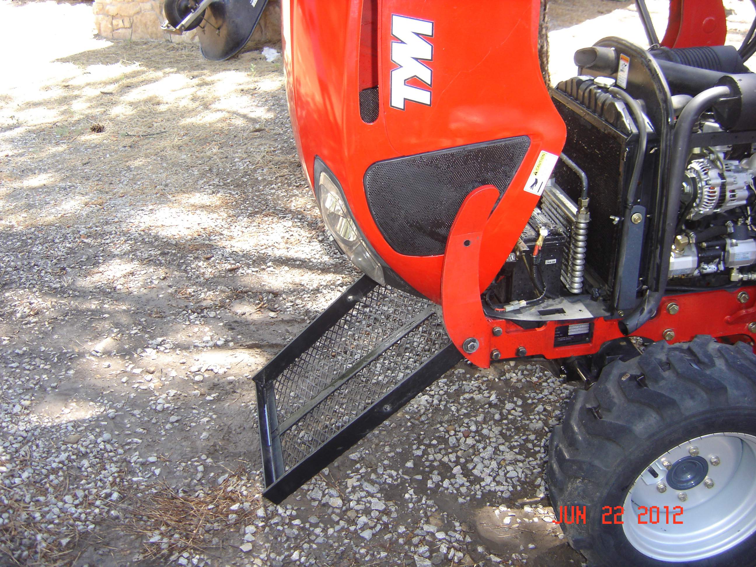

Looks great to me and I like the way it folds down. Good job.
/ Grill guard #9

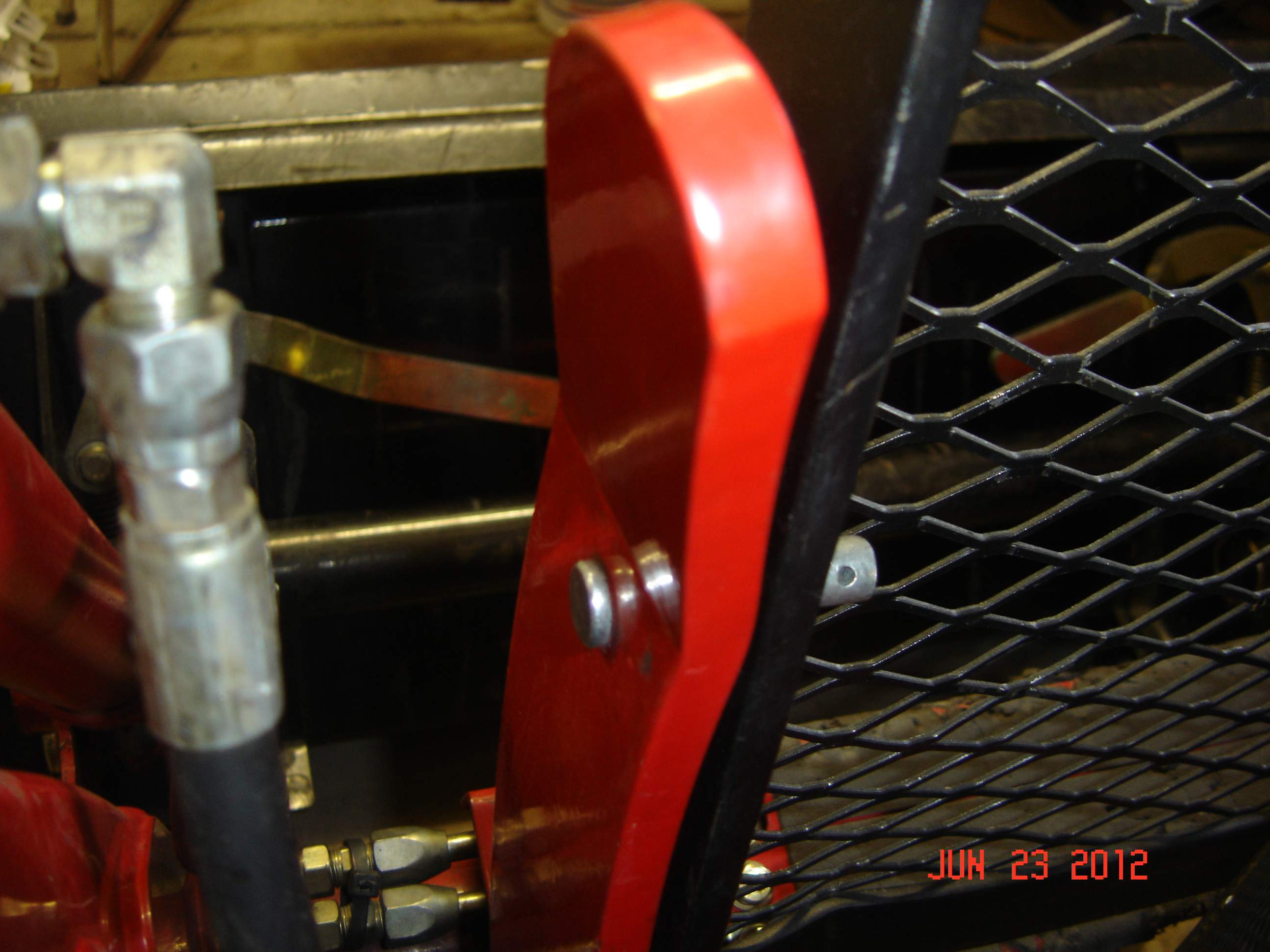

Yep, that has merit. I was goint to put a mesh on my grapple but this looks like a better idea for those of us that live in the woods. Is there some kind of latch that I'm not seeing in the pix?

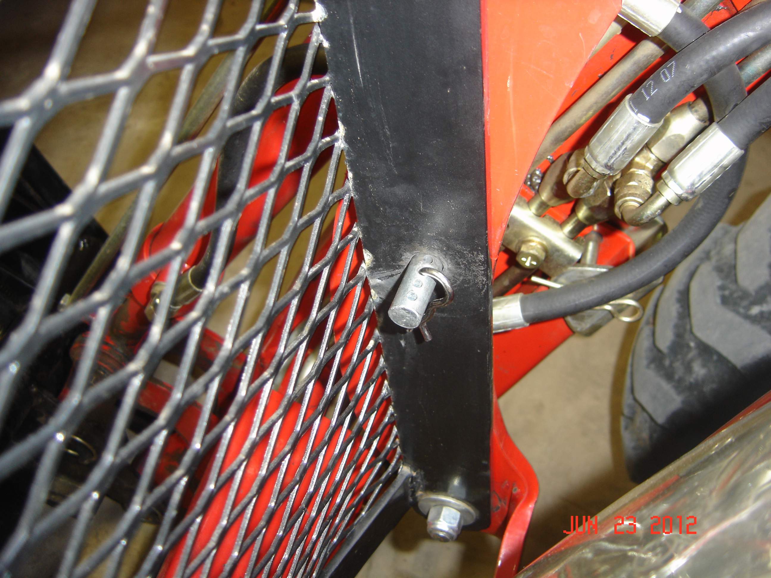

/ Grill guard
I used two clevis pins at the top to hold it up. You can see them in the first picture. They are easy to remove and make it easy to fold down. I also used two lock nuts and bolts with shanks at the bottom.
/ Grill guard #11
Thanks for the detailed photos. You are a fine chraftsman. Pretty decent photographer as well.
