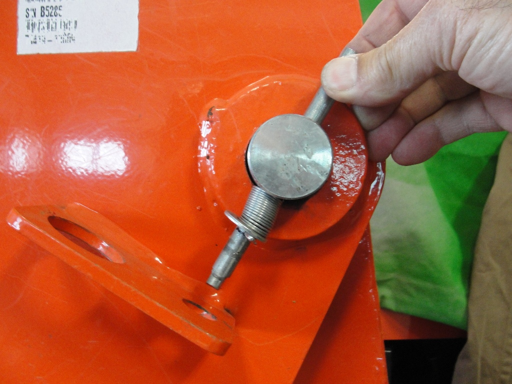

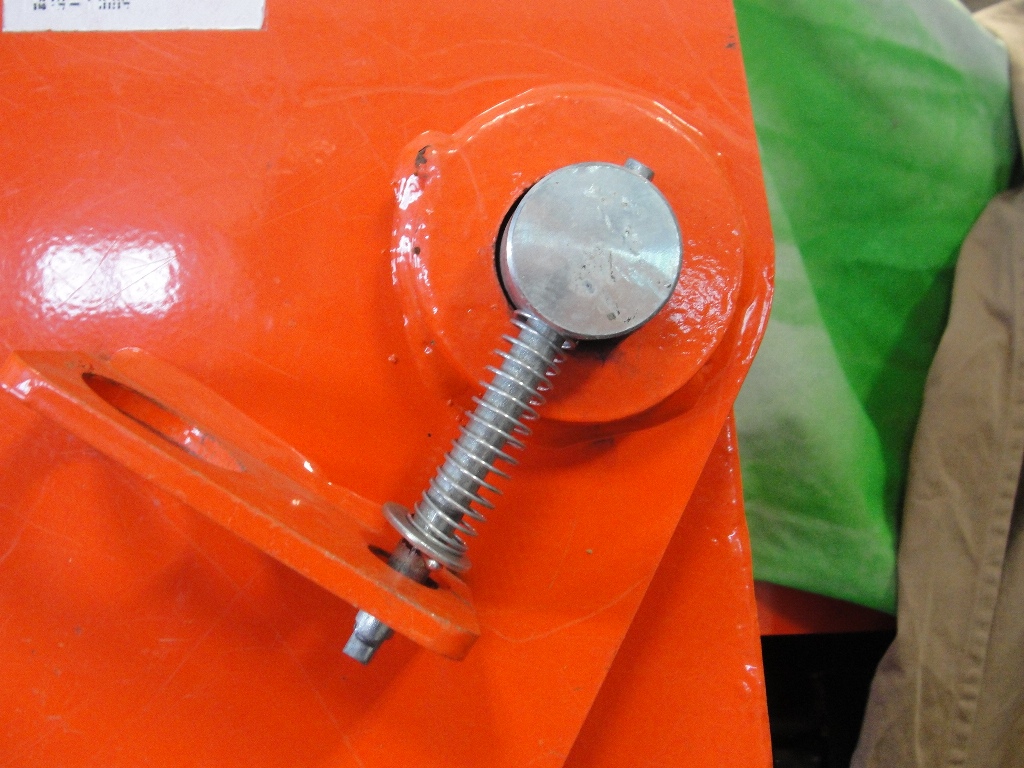

Don't bother with the Kubota engineer thing. I once modified the FEL latch pins with the addition of a spring which holds the latch pin in place all the time. I sent an email to Kubota with pictures explaining the modification. I also explained that I wasn't looking for anything in return. Just thought they might want to adapt something similar. I got an immediate response. It was a stern warning that any modification to the FEL frame and/or it's latch mechanism would void my warranty if problems occurred........
Not surprised. Stinkin' liability lawyers...
/ Grille Guard #8
Nice guard Paul.
View attachment 424408 View attachment 424409
Reminds me of the old saying --- "No good deed goes unpunished"!
