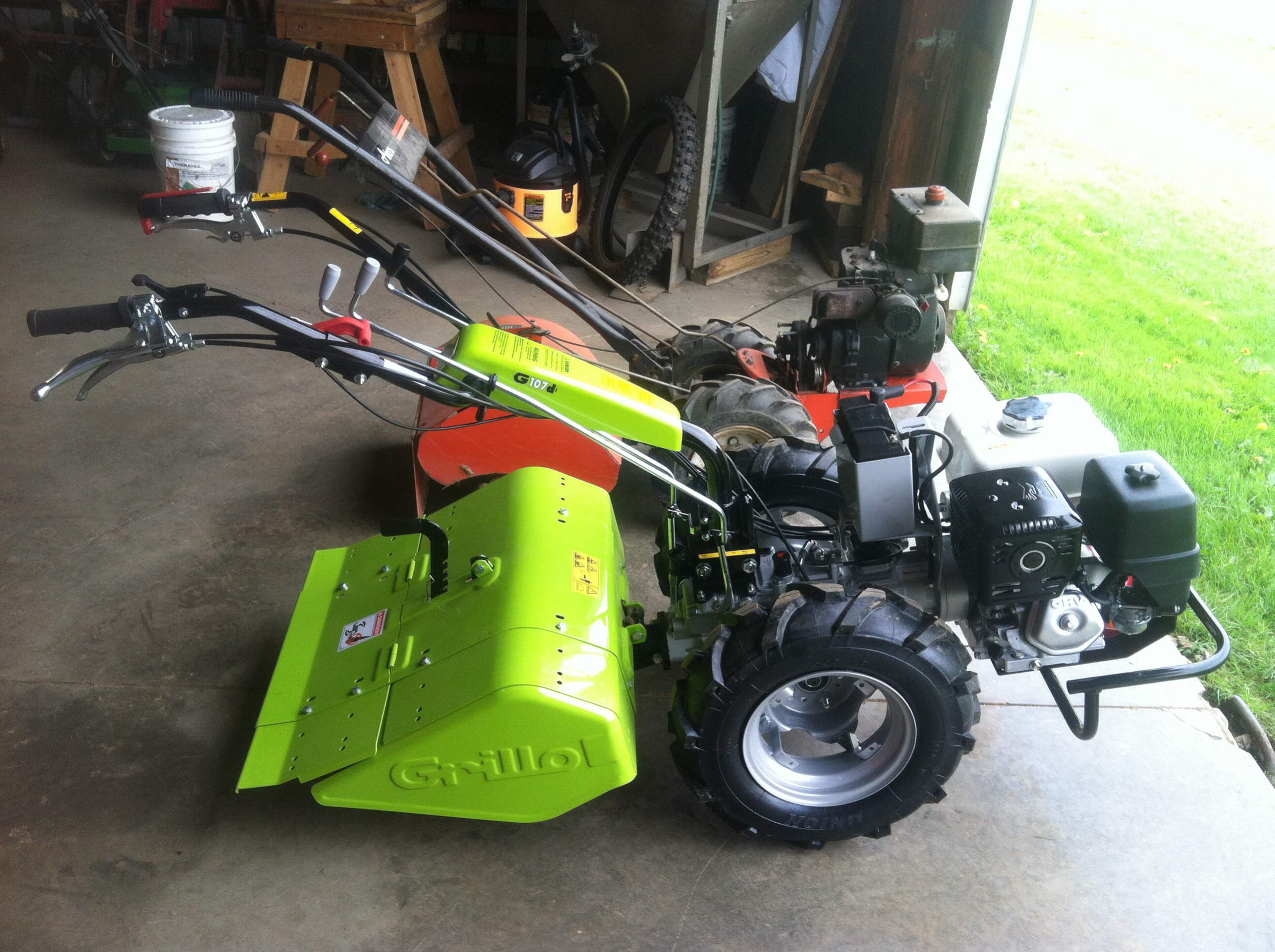

I like the generator. It's greatest feature is portability. There is something wonderful about not having to drag out a full sized genset. But the tank is small. I get an hour and a half of run time. I started to look into larger tanks, but can't find anything.
The wheel extensions are excellent for balance, that's why we bought them. But the also make the tractor turn slower when one wheel is stopped via the brake. This is a huge plus in my opinion. In third gear the "turn on a dime" move can get away from you, it's manageable with the extensions. We didn't account for how wide the tires remain in the shortest position. It looks like they need to be removed before installing the snowblower.
I bit the bullet any bought the cast wheel weights vs the barbels. The barbels wouldn't work with extensions anyway, and I didn't want to hear clanking weights. They are just want we wanted, but I would get filled tires if I did it again.

Timber, thats a bummer about the fuel tank. I hadn't thought about that. Don't know your capability to fabricate, but what about building a bracket that would mount under the engine or in front above the grill and run up to mount a matching Honda tank or clone tank? Would double your capacity. I hate to say it, having ordered electric start, the perfect spot would be where the battery is. How much gas does it use on the generator? Specs say 1.6 gal, is that exaggerated or does it really use that much?
I don't blame you on the barbell weights, that would drive me nuts hearing them clank around. Im a machinist, so was thinking of machining some wheel weights if i can do so cost effectively.
That flail mower does seem very popular. Do people use them as lawnmowers?
   / Grillo g107d tire size #14
Since I only need the extended tank for the generator when it is sitting, I was considering to install a fuel Y valve. Then attach a marine 6 or 9 gallon tank to the other end of the Y valve with a quick connect. I haven't even looked if those fittings are available.
I see fuel burn between .65 gph and .8 gph (yes I measured it that carefully few times).
I don't run the tank dry because I worry what that would do to the tractor, does anyone have an answer to that?

Motion pro makes motorcycle accessories, they make both a quick disconnect and a y fitting. They also have inline fuel petcocks but that isn't as hard to find in a lawnmower shop.
If you run it dry, that creates a lean condition. If something runs lean for to long it will destroy an engine. And i dont like to shut engines off at anything over an idle, which when it shuts off on a generator its going to be full throttle with a load. I think id try to keep fuel in it like you are.

Finally picked up my grillo Tuesday, what a machine! Didnt realize how big it was at the shop i saw them at. Next to my Ariens tiller it seems huge. Spent today tilling my garden and my inlaws. Makes the ariens seem like a joke. glad i didnt get the bigger tires, these seem plenty big for now.
I was tilling for about half an hour and kept thinking man its hard to keep straight with the diff lock disengage. Then i remembered, oh yea i have wheel brakes! Thats a handy feature.
Have a question for you guys. My differential lock seems to take quite awhile to engage, is this normal? Almost like you have to rock to back and forth awhile to get it locked in. I thought it would be instant?
