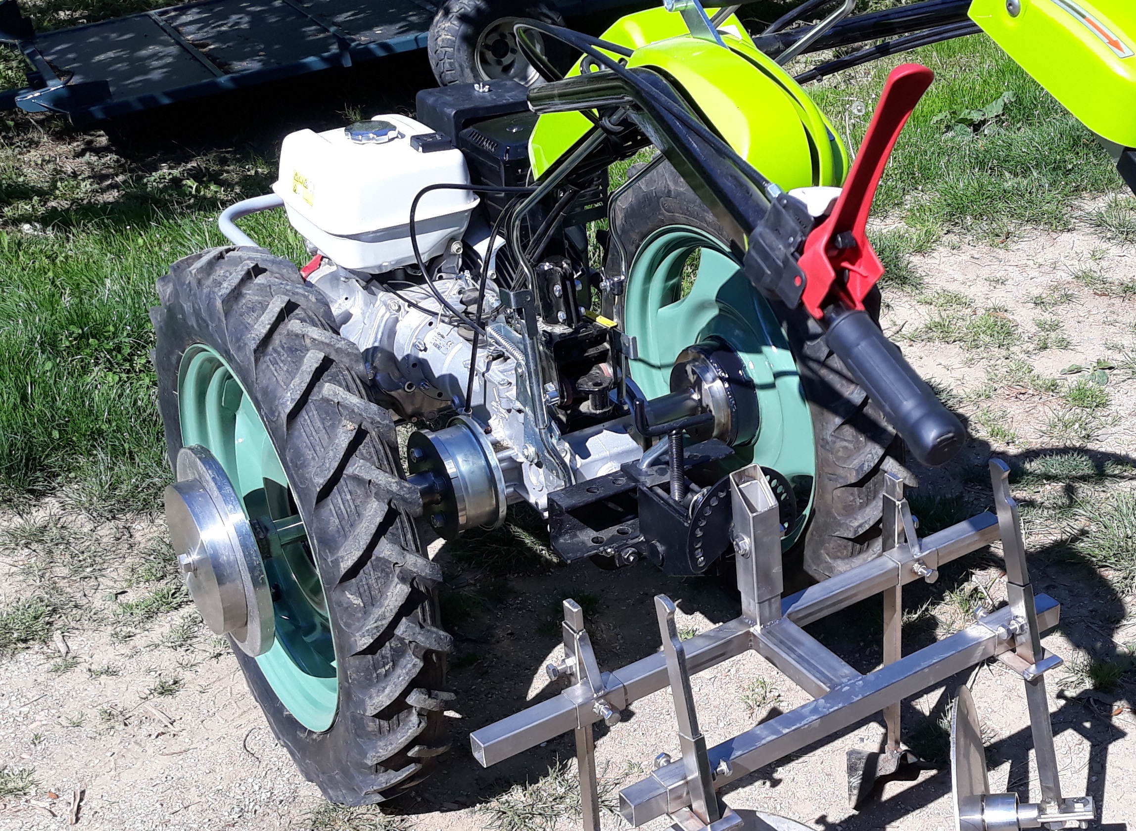

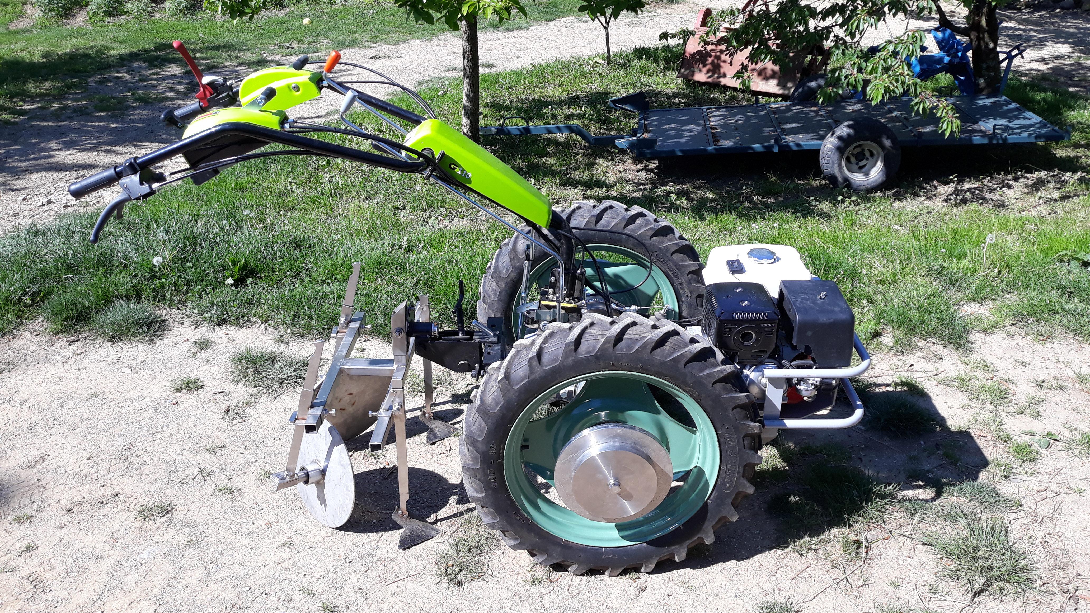

Ever since I got my g110 ground clearance was a big issue. And something had to be done especially when cultivating already growing plants. So this monstrosity :confused3: was conceived with 4.5-19" wheels 130 mm spacers and 16kg stainless steel weights per wheel. Now it has 280 mm ground clearance. Yes it is 40% faster and all jumpy if you are not careful with the clutch, but it was worth all the work put in to it. But now that gearbox looks really small and fragile with those big wheels on, I wonder how long it will hold together.
Any thoughts? You guys are usually full of ideas.

Trying to understand why ground clearance was an issue, are you tilling over the top of growing plants?
Not familiar with Grillo but they seem to be similar to BCS - built like a tank!

That's pretty crazy looking. All of that stainless and/or aluminum gives it a unique look too. And those tall narrow wheels! Maybe you could make them dually and eliminate the weights and get more traction too!

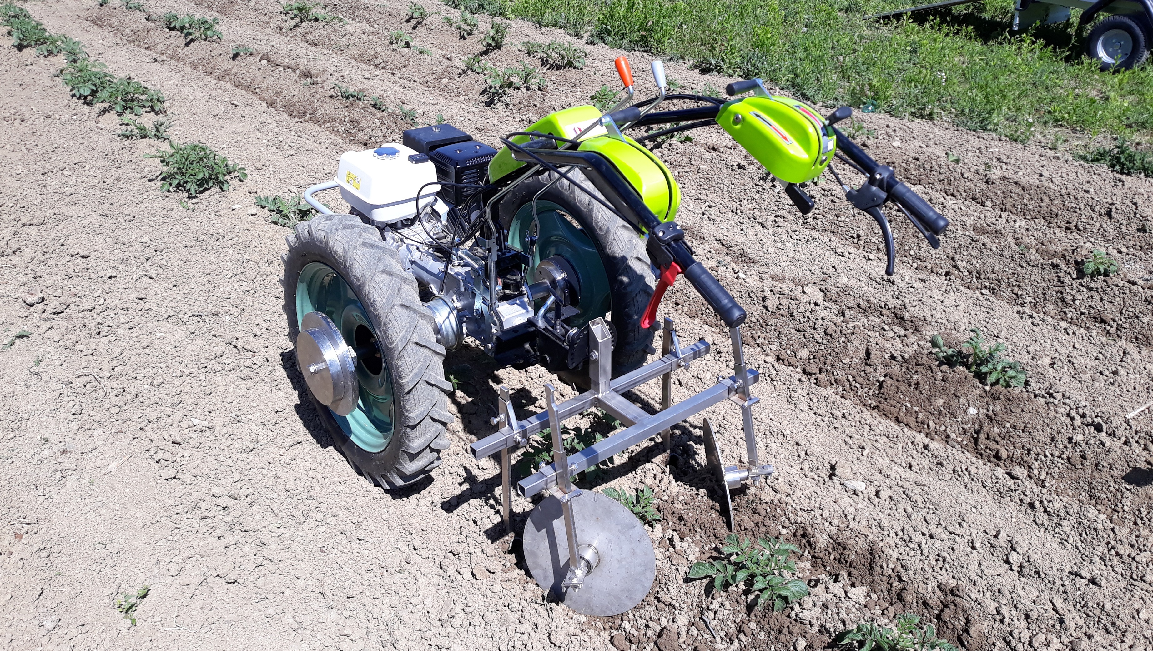

Well thank you. For tilling 5-12 wheels are still best but for cultivating and weed control I use my 2 wheel tractor like a regular 4 wheel one, like in this picture cultivating potatoes:
Similar setup is used for corn when it is still small and beans so I don't have to use chemical stuff to kill weeds.
I never thought about another set of wheels, that is a good idea, but I don't know how much stress can the aluminum housing take, I have never seen those tractors been used this way.

Well thank you. For tilling 5-12 wheels are still best but for cultivating and weed control I use my 2 wheel tractor like a regular 4 wheel one, like in this picture cultivating potatoes. Similar setup is used for corn when it is still small and beans so I don't have to use chemical stuff to kill weeds.
