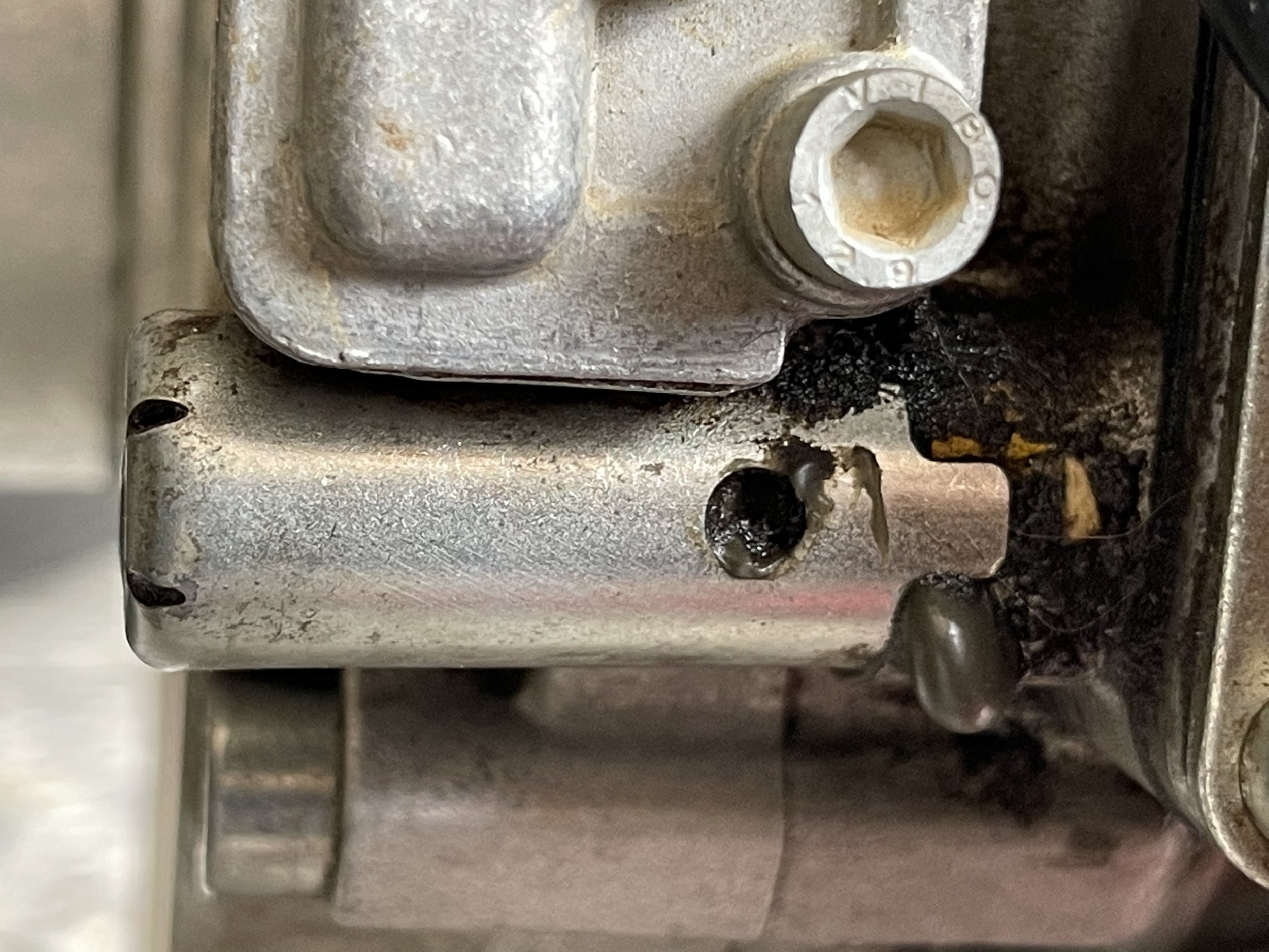

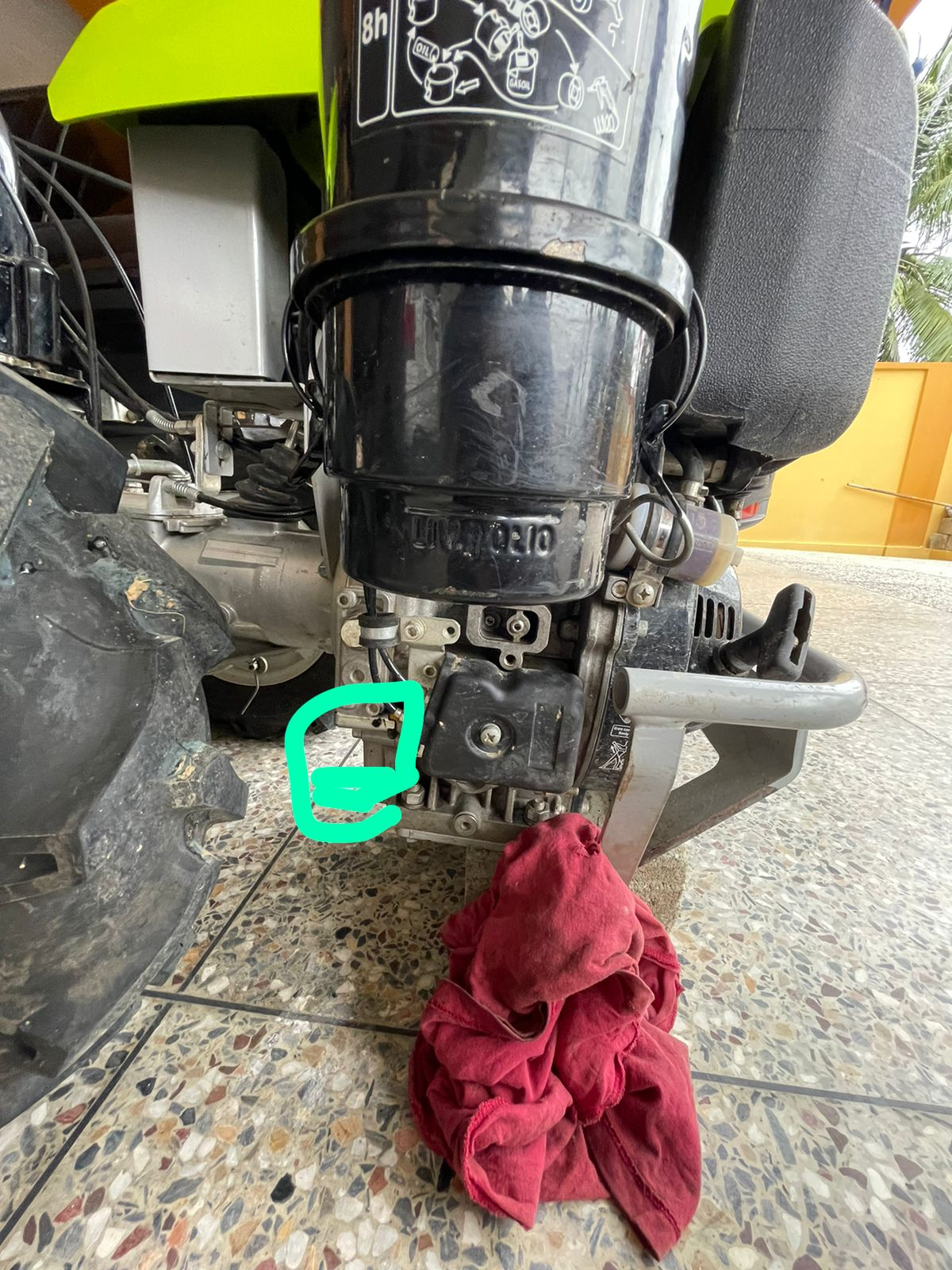

I did some inspecting and notice this
Saw when the machine was as running oil was coming out from here like a drop every 20 seconds

When it’s park up no oil is running out
