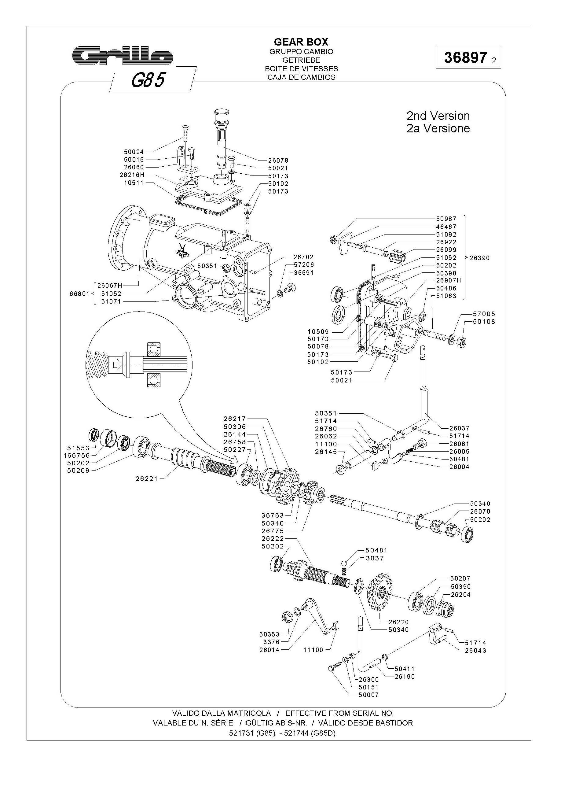

Udder, sounds like you have the same problem I do. I have attached a page from the parts book for the G85, is the spring you refer to part 3037 on this page? I haven't taken the machine apart to have a look. You added a shim, but would replacing the spring or ball bearing solve the problem. Is the spring getting weak for example, or the ball bearing worn?
SageBrush, my machine is ex hire so has seen a lot of use. I would think it's a worn part that's causing my problem, and would doubt if it would be an issue with a new machine.
   / Grillo G85d PTO lever slipping out of gear #7
Yes texanjim, that's the spring I referred to. I slipped a shim (supplied by Earthtools) underneath the spring. Joel also supplied me with a new spring and ball bearing so I changed those out too. The only other thing I can think of for my own problem is to insert another thin shim.

You will need to clean out all the grease from the socket, which is a good idea to do yearly anyway. The grease is there to lubricate all the moving parts in the socket, but it is also to catch dirt and grit. If it doesn't get cleaned out, you end up with a grit suspension that's as bad or worse than a dry socket.
Once it's cleaned out, look at part 26204 and part 26043 for wear. The splines in the PTO coupler (26204) should be nice and sharp all the way out to the edge of the hole. If the splines taper in, it's worn and will jump out as you described.
The Slider (26043) can also wear on the side that pushes the coupler out. You can get a welder to put a bead on it and grind it down, or you can just get another one. I elected to put a bead on my BCS 715 when I had this problem. You gotta be careful to not have too much, though. If the coupler can't slide back far enough, the attachment will run engaged or disengaged.

Thanks both, that's really useful info.
I've also just found this PDF on Earthtools web site with a step by step for replacing the spring, ball and adding the shim. Having not taken the tiller off yet, it also gives me a really clear view of how things work down there. Which means I can see exactly what your getting at Farmerboybill.
http://www.earthtoolsbcs.com/Grillo_PTO_Coupling-_Ball_and_Spring_Replacement.pdf
Next stage is to get the machine apart I think, and see what's going on.
