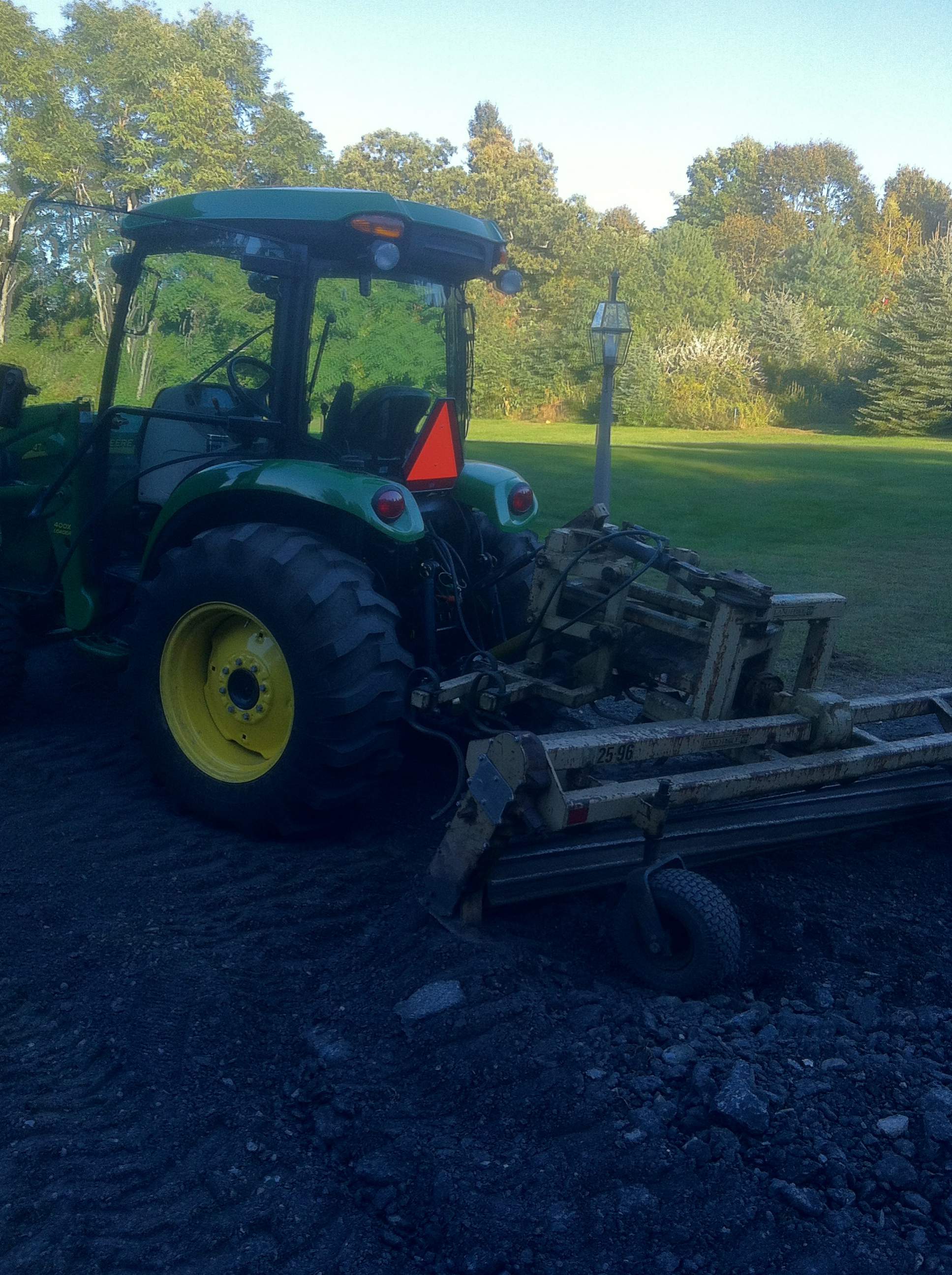

I'm a big fan of using milled asphalt. As a matter of fact I just did my 500' gravel drive with asphalt millings. A buddy has an 86" Landpride power rake that I borrowed and my 4720 handled it with no sweat. Also borrowed an Ingersol-Rand vib roller (rubber drive tires, about a 48" front drum) and it came out fairly well. Real test will be after we get our first freeze and out first heavy snow and we will see how it holds up.
As for your plan, I can't believe you are going to get good "break up" with yor Harley. How big is it and what do you power it with-weight and HP count. My millings came right out of a stockpile that came right from a road job-so I had my share of "chunks" with the fines. My guess is you are going to have nothing but "chunks". As such you are going to need one big vibe roller to get any kind of decent compaction.
One other thing, the Landpride I used doesn't have individual teeth on the rollers-rather it has rows of horizontal bars. Worked great as when rotating the bars would grab the "chunks" and pull them up against a screed bar that would further break up the chunks-not that I didn't do a fair amount of manual work pulling the big stuff out before I hit it with the roller.

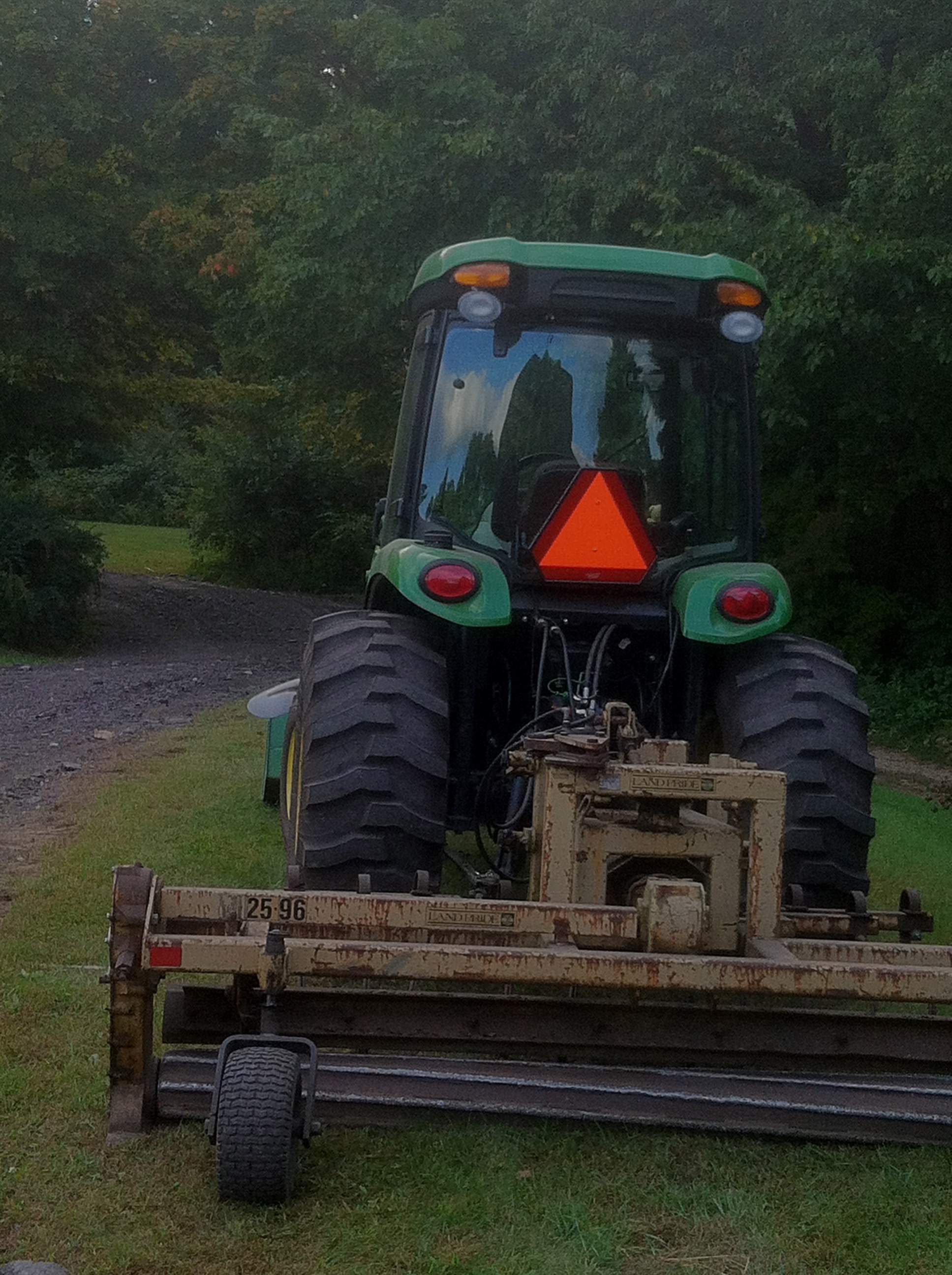

By the way, couple of shots of the Landpride I used. And Randy B- you guys do it right. Like I said, the stuff I used came right out of the stockpile from a road job. The biggest outfit in the area will no longer sell you millings because the State of Mass. now allows asphalt producers to use up to 30% millings in new asphalt.-- Sooo-these guys now will sell you a blend of 33% milling, 33% asphalt shingles and 33% concrete/brick. Good subbase at a fair price but no way a good stand alone finished product.
There is another outfit that is running their millings through a pugmill of some sort getting it to a 3/4" minus product that they sell for 12 bucks a ton. In the spring I will do any repair needed with that stuff
