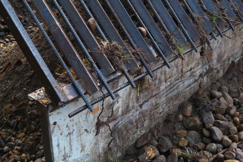

I tackled #4 above and created an add on screen to reduce the pass size.
Material is running low, so I tried Rebar attached to the 1" square tube.
I welded to vertical pins to the main frame that holds the tube from sliding down the tube.
It is also constrained from moving sideways.
At the bottom, I have a small pin that sets into the center angle bar to keep the bottom edge from sliding sideways.
Still working well, But I sure have a lot more rocks. (and smaller ones at that) to move out of the area.
Since the angle iron takes about 1/2 the force, rebar seems to work 'ok'. The slight flex of the rebar does make clearing stuck rocks easier than when he bigger rocks got jammed between the rigid angles.

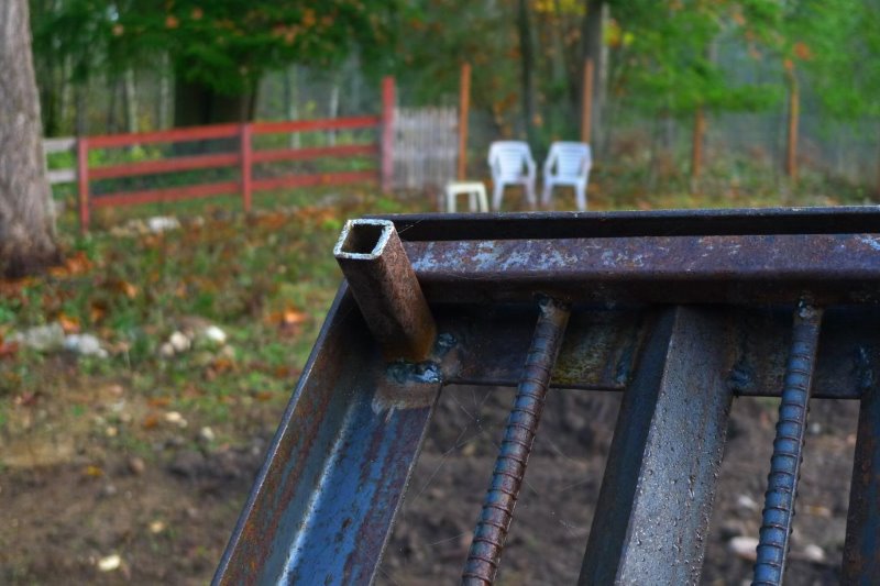

Here are the pins to hold the rebar grill that reduces the pass size.
Two 1" square tube on the frame top. only one corner is shown
One 6" piece of rebar on the bottom center. slides into the angle on the main screen frame
rebar grill slides up, locking the bottom with the pin, then drops over the square pins on top.
Last photo shows the rocks out a couple of previously run material.
