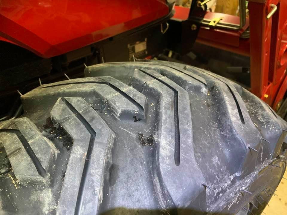

How hard is it to groove Industrial Tires?
What tools, how wide, how deep, unit of measure?
Assuming this will not decrease the life of the tire?
Might be a good summer project as a proactive measure.
TIA

Is that the same as siping?
   / Grooving Industrial Tires #12
No, grooving tires is a little bit more intrusive.
   / Grooving Industrial Tires #13
Is grooving better than siping? What is used to sipe(sp?) a tire? Jon
   / Grooving Industrial Tires #14
Siping is just cutting a line. Grooving cuts a small trench & actually removes rubber. Siping doesn't remove any rubber. Its suppose to let the tread flex a bit more & give more corners to dig in. Sipes are OEM on a lot of road tires these days. Basically a industrial razor blade or knife for siping. Grooving uses a U shaped chisel or heated U shaped knife.
