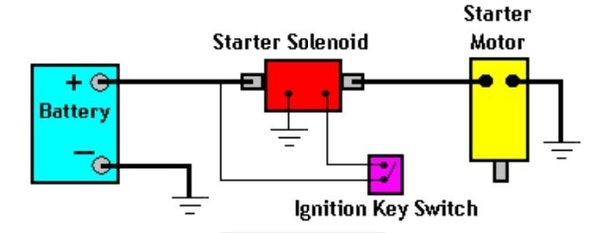

1 through 3 are OK. 12.78v means really good battery. 2) is OK since starter isn't cranking (should be roughly 10 to 11 volts while cranking.
"4) now meter positive + lead on battery positive +. Negative lead on starter terminal.
Should be zero volts off & cranking. off 0, ignition in on position 3.49, crank 12.43"
Your battery + positive cable goes to solenoid big terminal, other solenoid big terminal goes to starter. When cranking the solenoid small terminal gets power which engages solenoid so starter gets power.
If you use a jumper cable battery + positive to solenoid big terminal and it cranks normally...you need to replace battery to solenoid cable since you just bypassed it.
If you jumper battery positive to other side of solenoid which goes to starter it should crank. (Careful...it will spark...lots of current there, but it's just a quick test). If it doesn't crank, try at starter itself. If it does crank, replace this cable solenoid to starter since you just bypassed it.
Step 4) getting voltage from battery positive to solenoid & starter proves you have a bad cable or solenoid. NOW...meter negative lead on ground you SHOULD measure 12 volts battery side of solenoid and small terminal and at starter when cranking.

It's a simple test: "4) now meter positive + lead on battery positive +. Negative lead on starter terminal.
From battery + he's measuring a voltage drop from there to starter. When solenoid is engaged then battery + goes through it to starter motor.
Voltage drop means bad cable, connection (corrosion) or solenoid.

Thank you to everyone for your help. It is now up and running as it should be...
For future reference, ALWAYS CHECK YOUR CONNECTIONS! (and I open myself up to public ridicule, it is well deserved)
Long story short, it ended up being the new ground terminal on battery that was not clean (had black paint on the inside). Because it was a brand new terminal, I overlooked making sure it was clean and making good contact!
