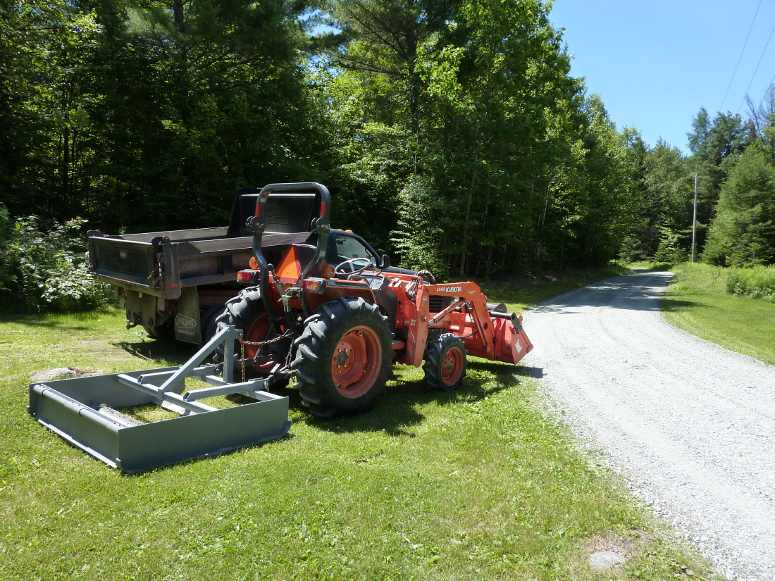

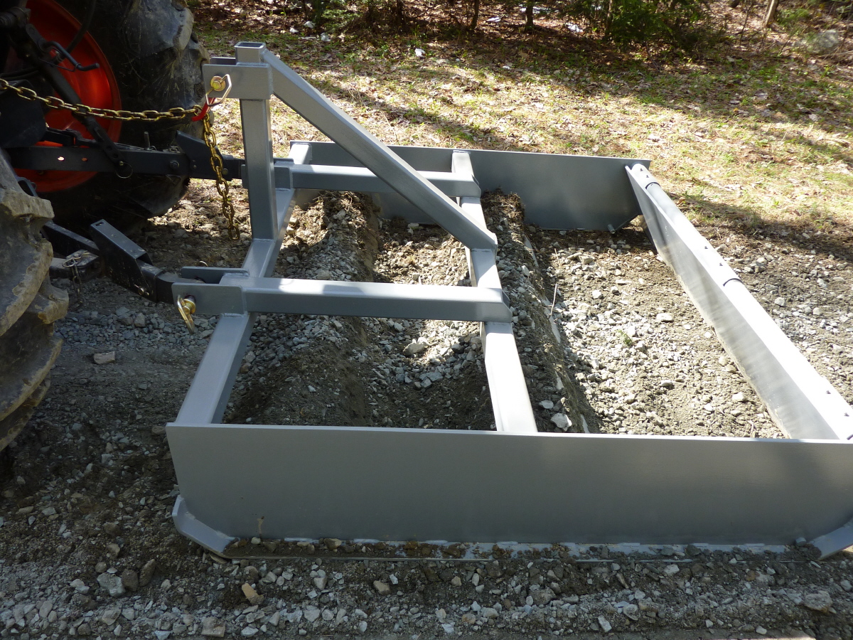

One of the reasons that I show pictures of my stuff, to show that I have experience with what I'm talking about.

I understand that and do the same, people who are interested in maintaining a nice drive recognize the importance of using the right tool.
I posted Monday in the attachments forum here about the equipment I use to develop large lawns, I included pics of the equipment and the finished lawn, seven pics in all, no response. I thought everybody likes pics. The landplane grader works extremely well for smoothing seed beds.

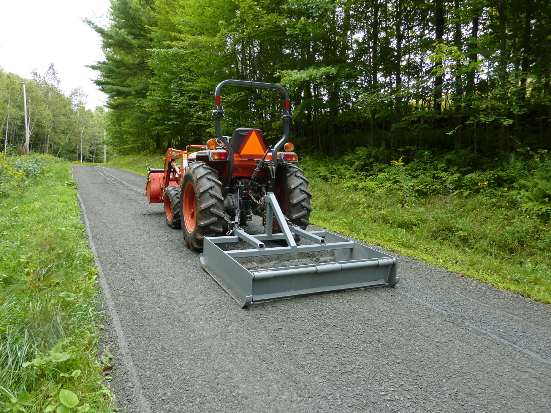

Using the plane pictured in the video you could expect fair to decent results. That plane was light duty to medium duty at about 75-80 lbs/linear foot.. If you use a plane that is roughly 125 lbs/linear foot you will get better results. If you use a plane with longer skids you get less deviation in the finished grade.
I good 7' plane with 72" skids and enough strength not to allow any flex in the blades should weigh close to 1000 lbs. For better control it helps to have the hydraulic top link too.
/ Ground Plane or Box Scraper? #33
That driveway appeared to be in very good shape already when they started planing it in the video. I wonder how well that plane would work if the road needed serious work. I dunno, I've never used one.

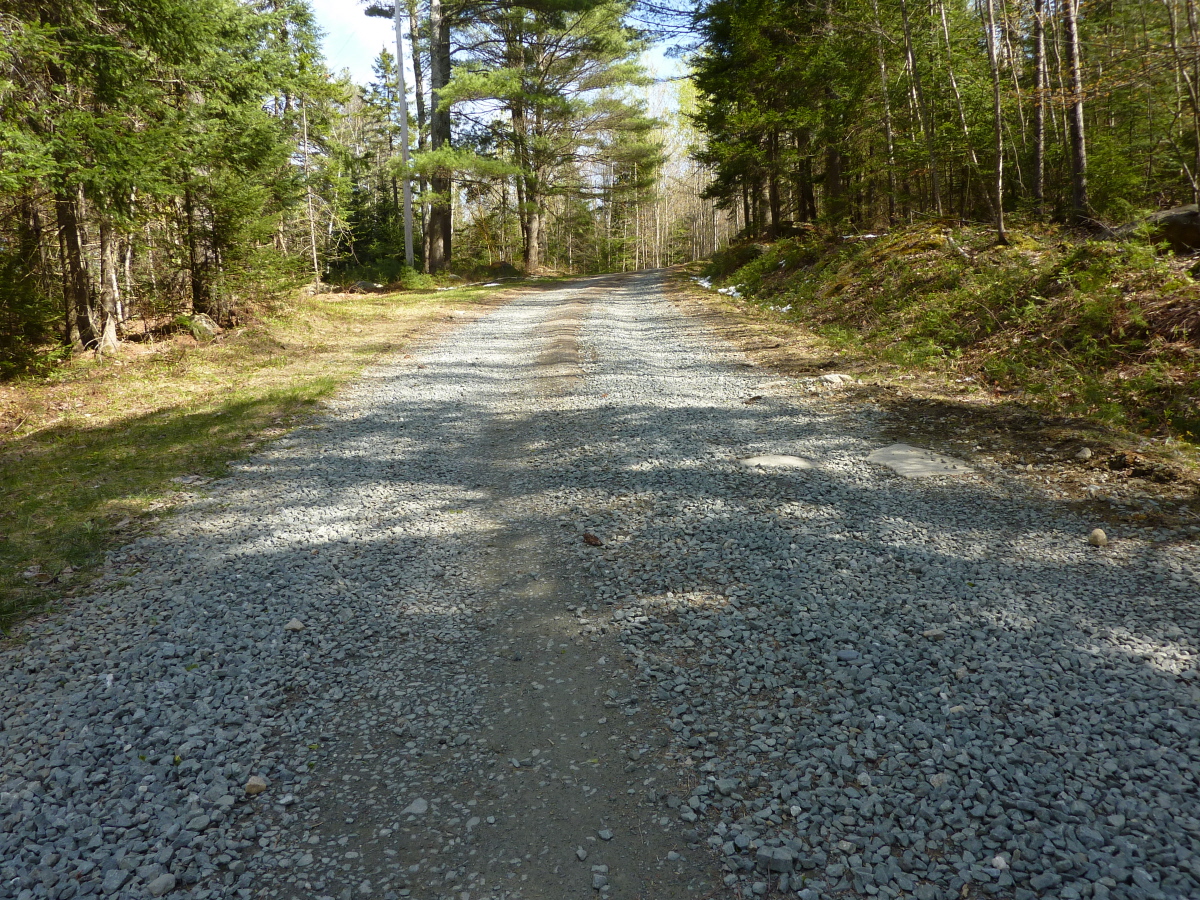

It depends on what you mean by serious work. If you need to recrown or change the pitch for drainage its not the tool to use. If the general contour of the road is ok but you have wash board, shallow wheel ruts, or pot holes then they work very well. On mine if we have a bad mud season I use my rear blade first to get the crown and drainage pitches reset then I use the grader plane afterwards and for the rest of the year. Here is a before and after pic of a section of my road. They're not a real good example but they are the only before and after pictures I have. This section is still pretty primitve. No proper road material at all except some crushed stone that I put in the mud ruts one spring before it dried up. I went over it with just the grader. Maybe this will give you an idea. But you really need to try one. The other important thing the grader does is it remixes the surface material so it is just like it has been resurfaced.

It depends on what you mean by serious work. On mine if we have a bad mud season I use my rear blade first to get the crown and drainage pitches reset then I use the grader plane afterwards and for the rest of the year.
Yep, same here. It is a lot faster for me to use the plane to keep the road in good shape. I have to use the back blade once or twice a year to reshape everything, depending on how much moisture, amount of traffic, and how big the potholes are!

A box blade does not even come close to cutting out wash board like a land plane-grader blade does. But you are right, if a person only has small chores to do, not much sense in spending all that money on all the more specialized implements.
I know that I would have to have less than 200 feet of roads before I would give up my land plane-grader blades.

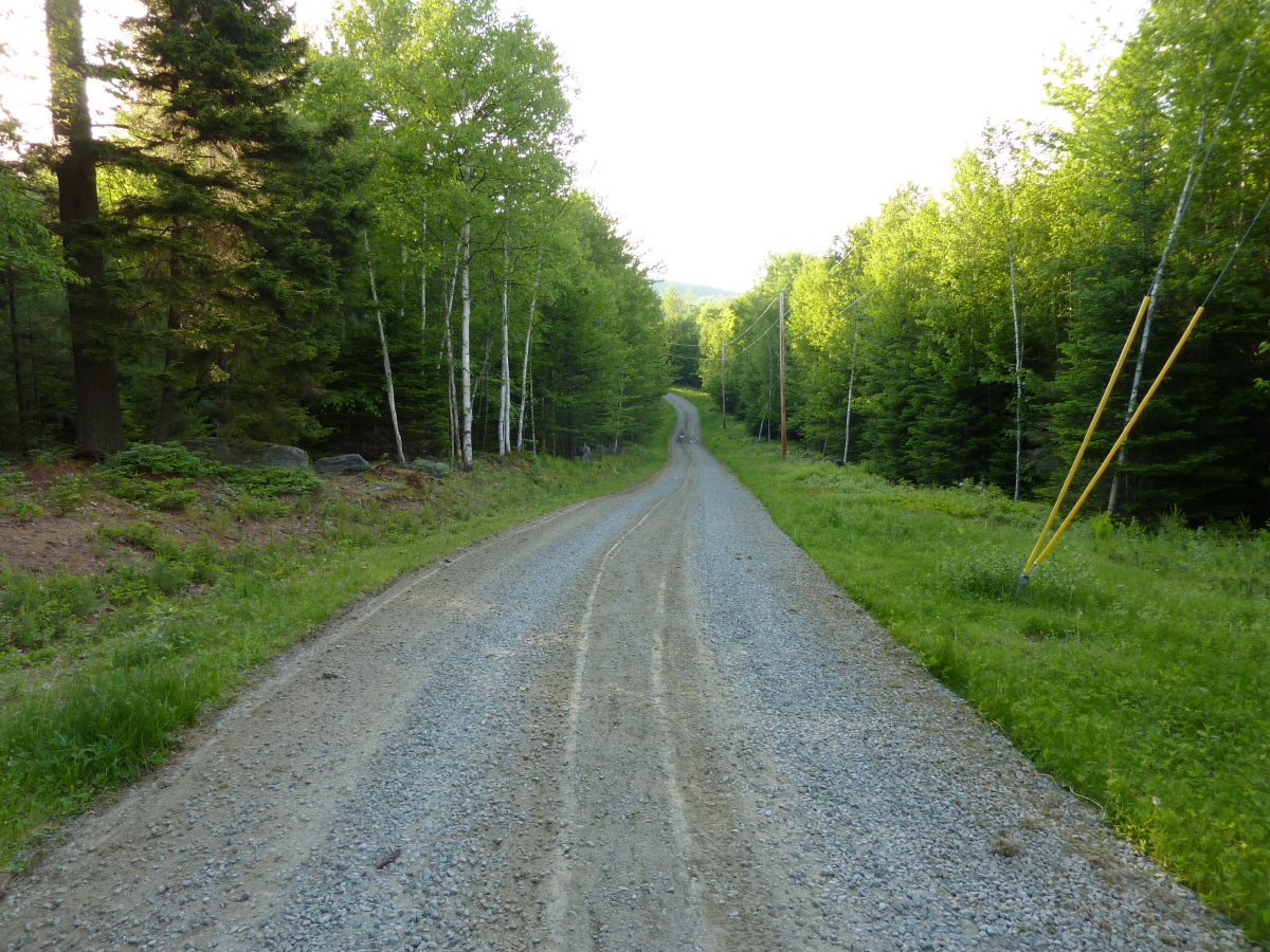

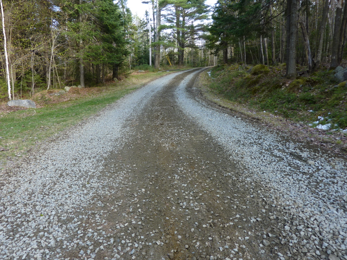

Not rude at all. But Don't forget eveybody has different needs and priorities. Your right it is not a boxblade replacement. It is specialized to make it very easy and quick to create flat planer surfaces from grassy, lumpy, bumpy, pot holey, rutted ones. What may seem silly to you may make perfect sense to the next guy.
Different strokes for different folks.
