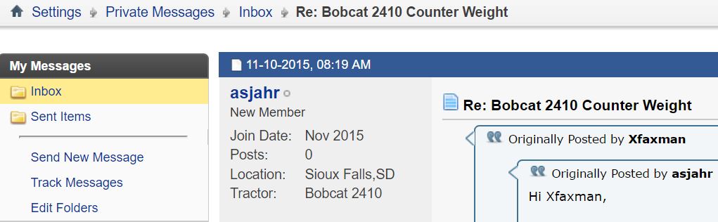

When did go into effect?
Several years ago a Brinly collector joined and sent me a PM. He never did make any posts.
I have had several PMs asking about the Versahandler from guys with no posts.
I just checked my PM Inbox, here is one from 2015 that never has posted to TBN:
   / Ground Speed of flail compared to rotary cutter? #6
I could have sworn that Muhammad had the system set up that way-it might have been another forum I am a member of and if so I apologize for the statement.
   / Ground Speed of flail compared to rotary cutter? #7
No need to apologize, I thought maybe it was a recent change.
I think it was for posting links for awhile, but not sure about now.
And now back to ground speed with a flail. :thumbsup:
