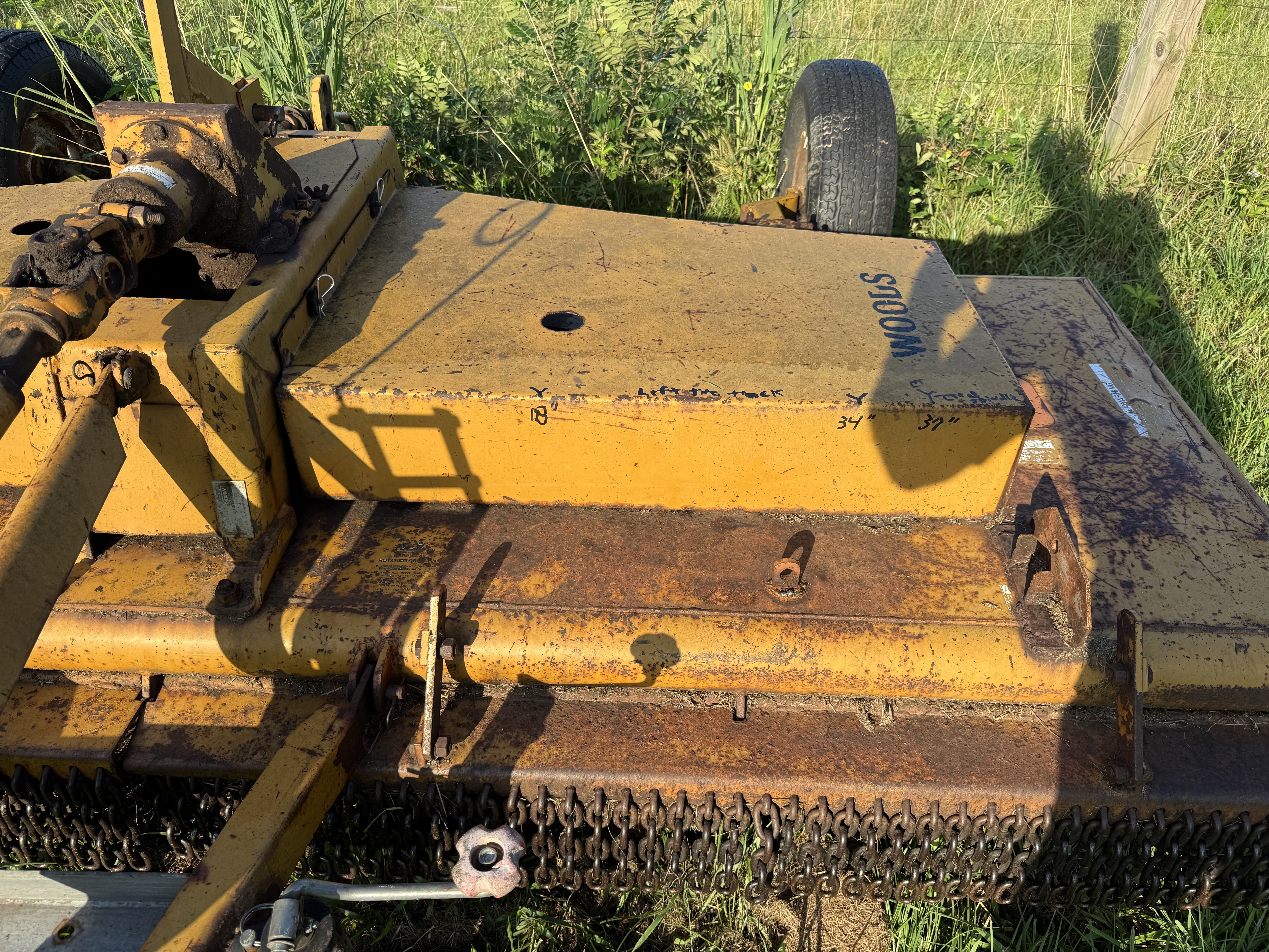

Sorry hadn’t had time to hook it back up and measure it.

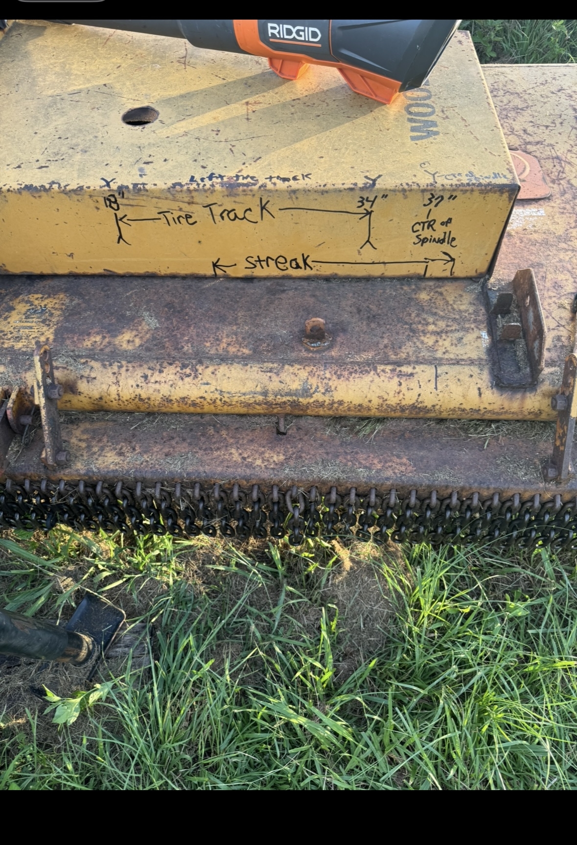

It is a 114” wide mower 57” to center. On my TC45DA the left tire measured from the center of the drawbar is 18” to inside and 34” roughly to the outside edge.
The streak seems be from almost the outside edge of the left tire to say 30” to most of the way to the outside edge of the cut, but not the whole way.
Next week I will hook it up again and see the actual measurement of the streak.
I haven’t hooked it up yet, but had time to measure it and the mower.
From center of PTO it is 18” to the inside tread lug/bar of the left rear tire.
Attached are some pictures of the mower with black tick marks from center of gearbox to 18”, 34” and the center of the outside spindle on that side.
I'm sorry, I don't know what "it" is. I also dont see the "black tick marks" and what they represent.
Here's all we'll need:
  • A pic (or your visual description) of the tractor/mower (shot from the rear) with a stripe coming out.
  • How stripe aligns with LH tractor tire (full width? Starts at tire center and goes out beyond tire to edge of mower? etc)
  • How it aligns with LH mower spindle (10:00, 11:00, 12:00, 10-11:00 position maybe???) Best guess or pic (stop tractor, snap pic with stripe from rear)
  • Confirm spin direction of LH spindle (CW, CCW?)
We'll get to the bottom of this!

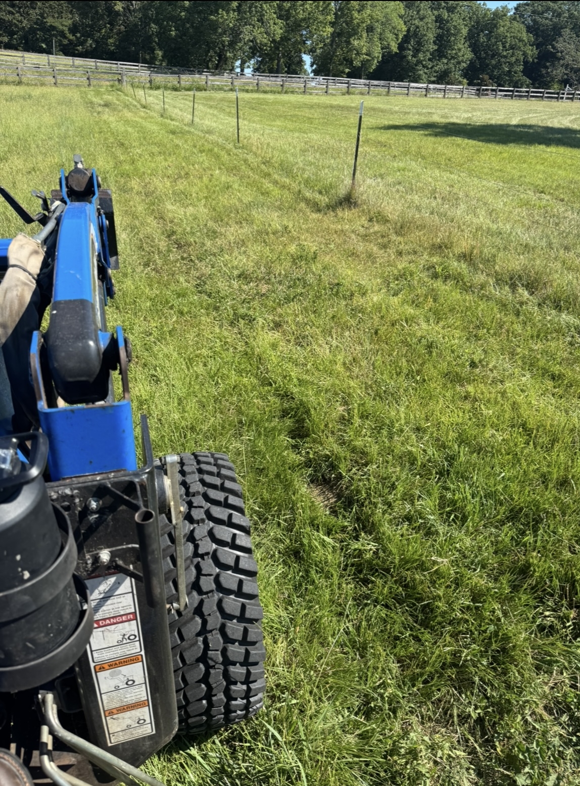

   / Hybrid Rotary Cutter Proof of Concept #75

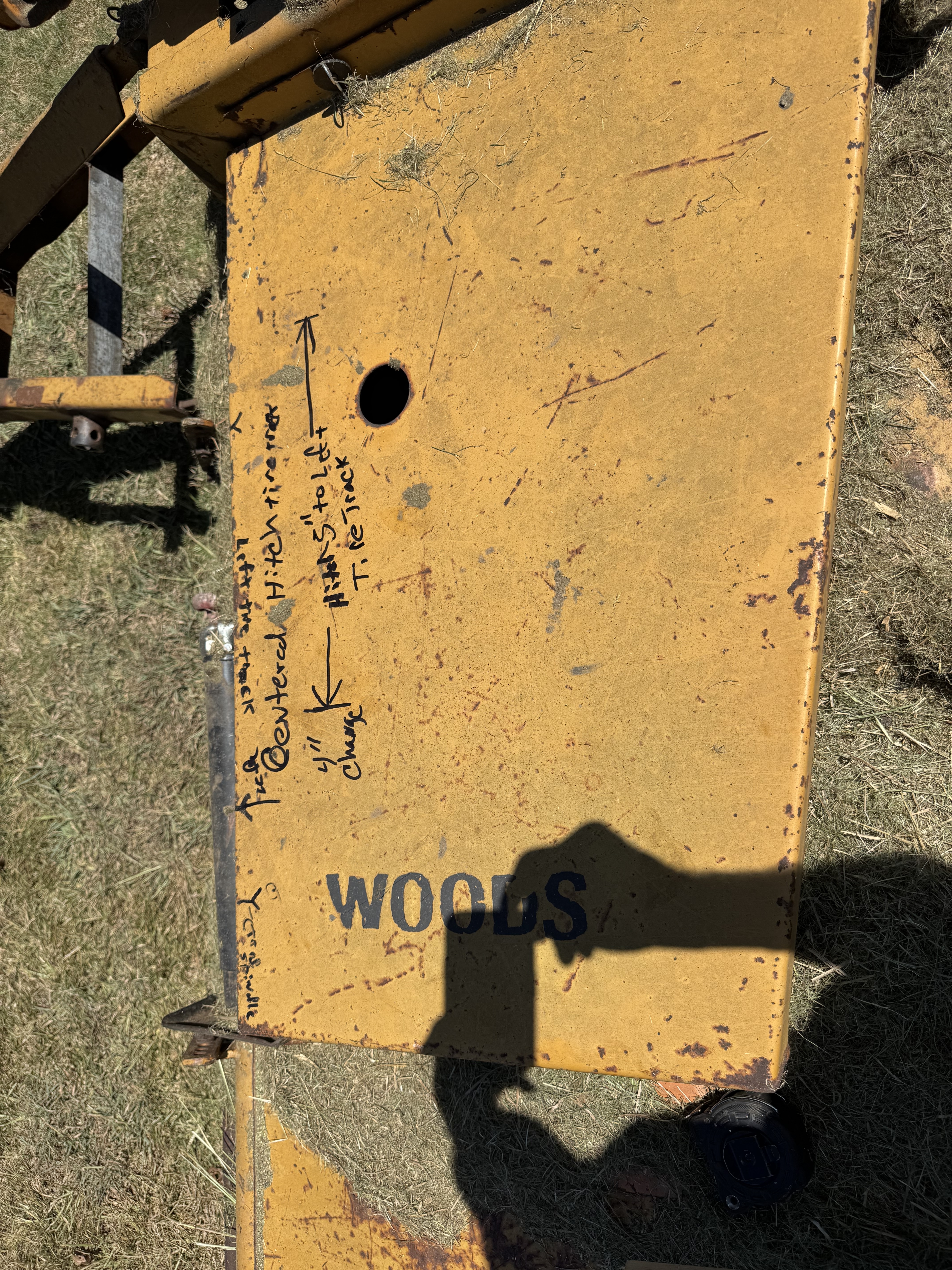

Sorry it was not clear.

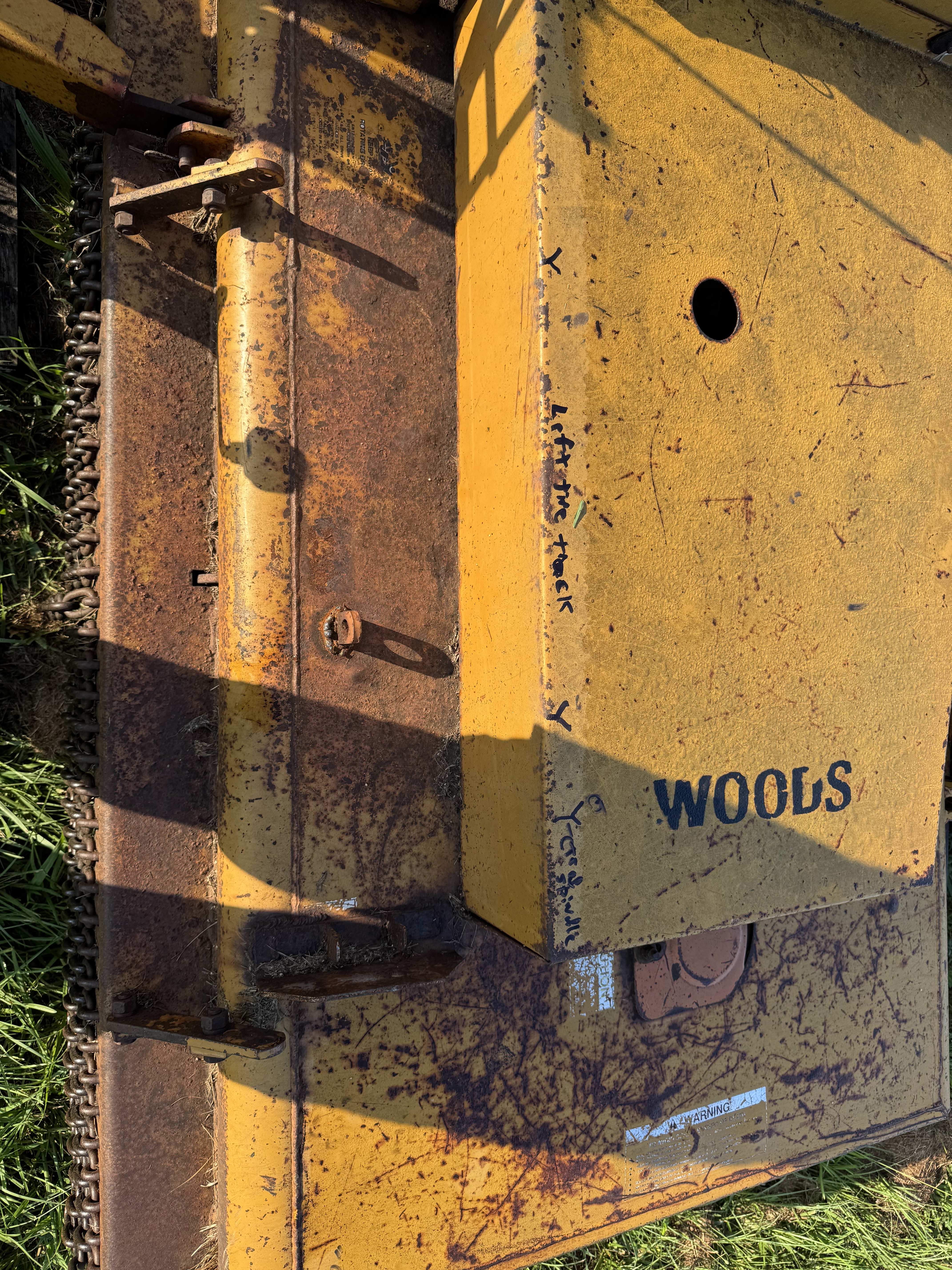

From center of the PTO stub shaft on my tractor it measured 18” to inside of the left tire lug and then from the PTO center it’s 34” to the outside of the tire lug (lugs are the parts of a R1 tire that grip and press the grass down).
Also it is 37” from the center line of the PTO shaft out to the far left spindle (about inline with the Woods decal).
If you expand the last picture I wrote those measurements in black marker on the belt cover/guard.

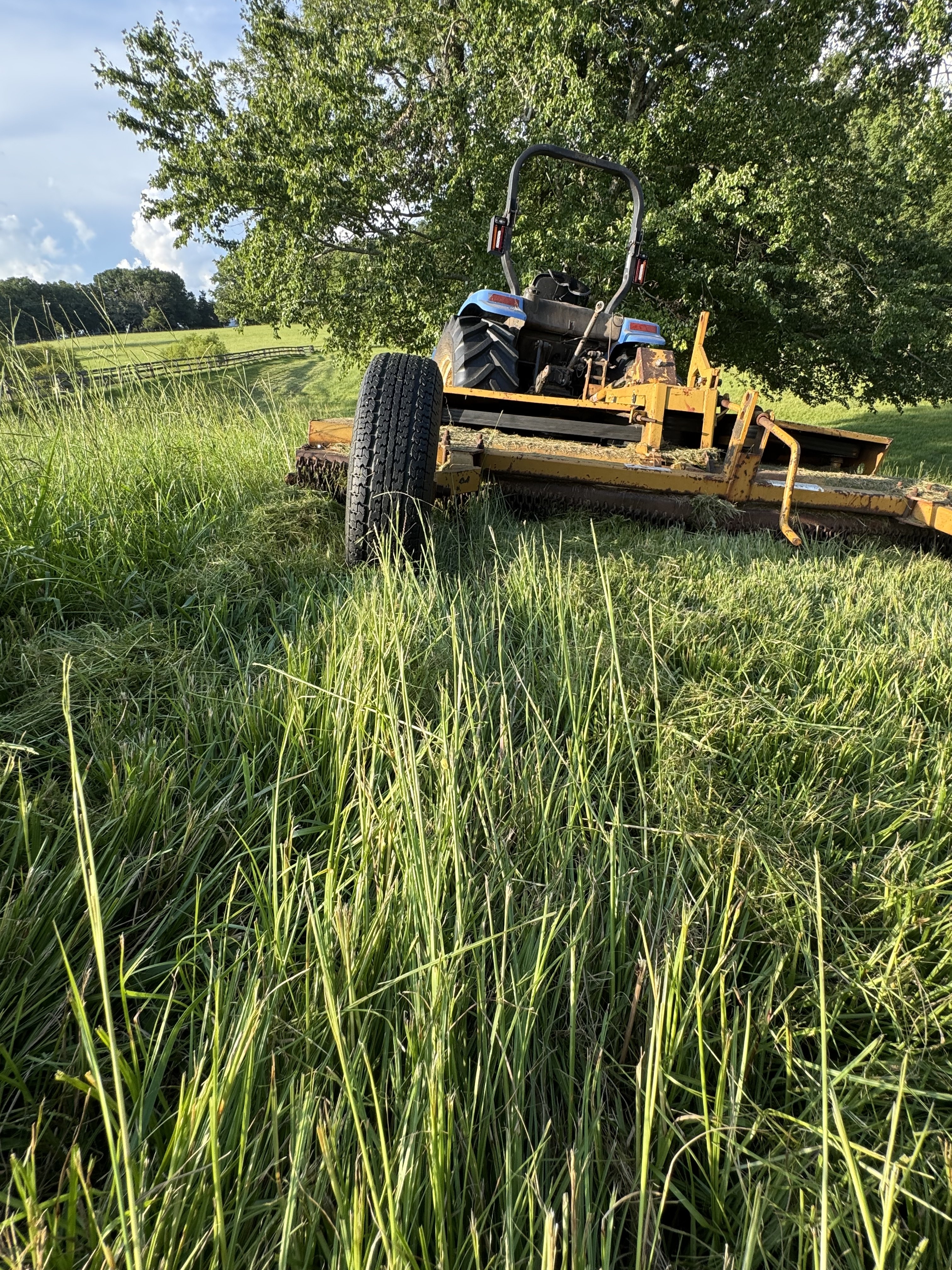

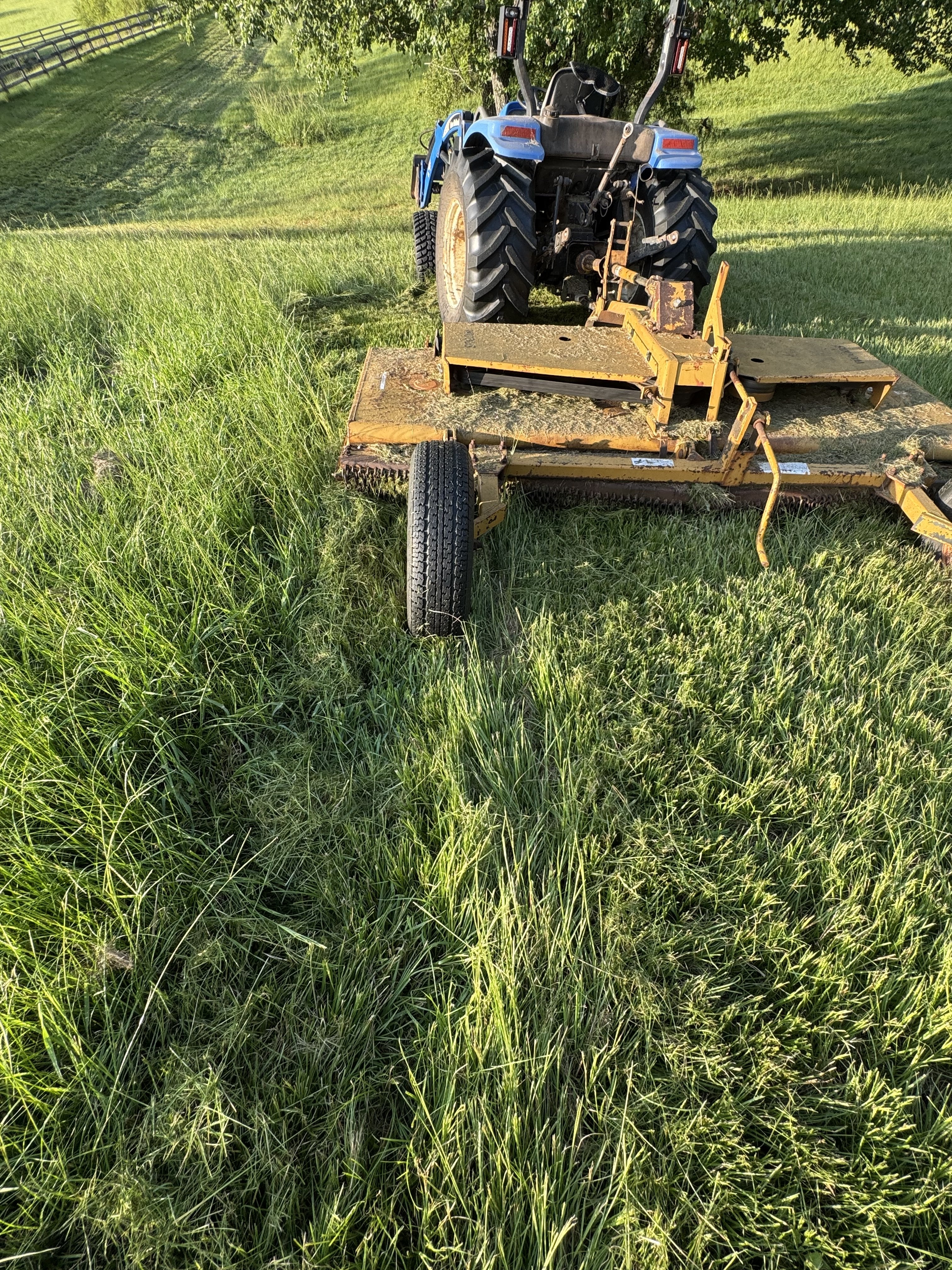

   / Hybrid Rotary Cutter Proof of Concept #76

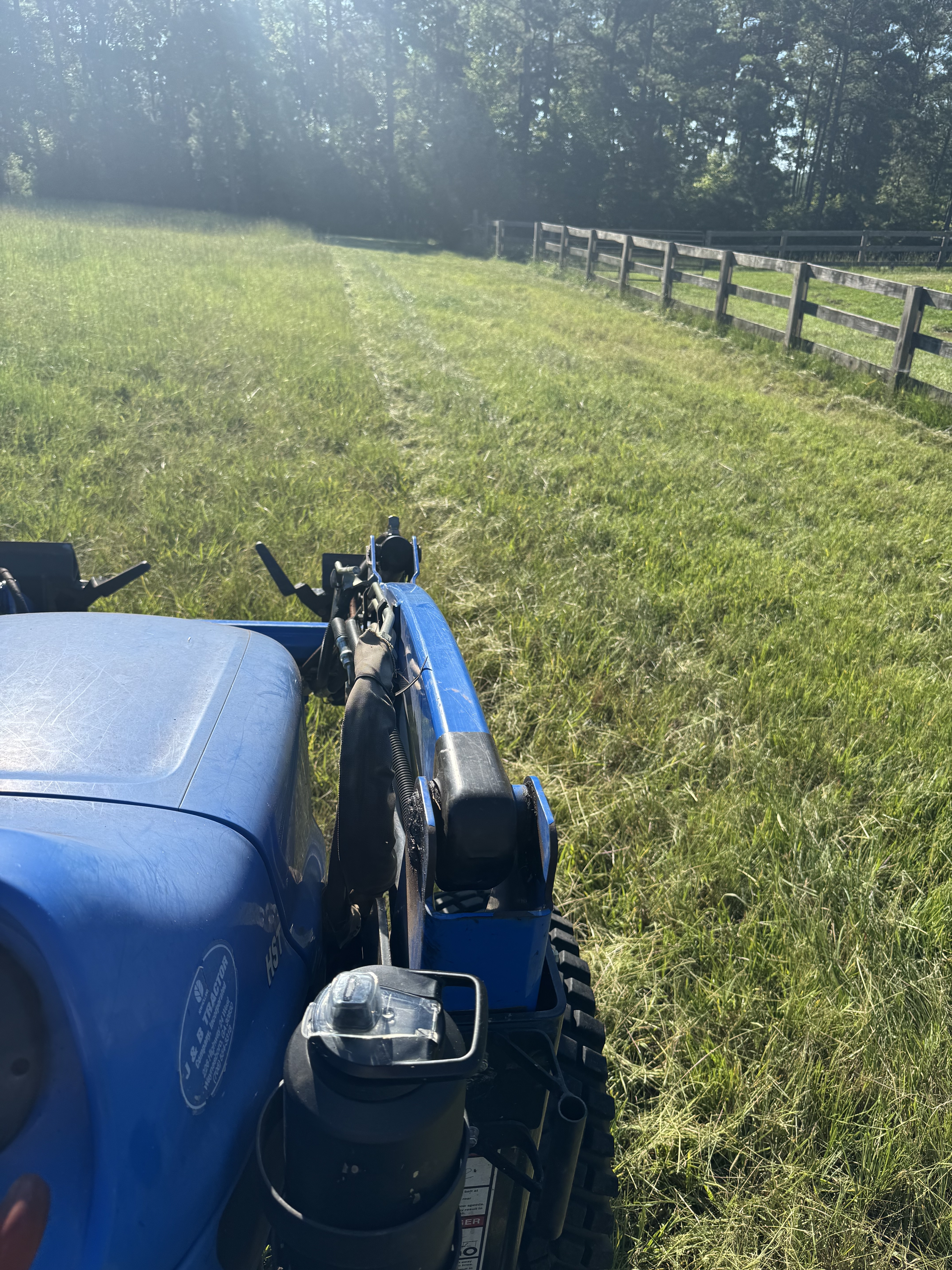

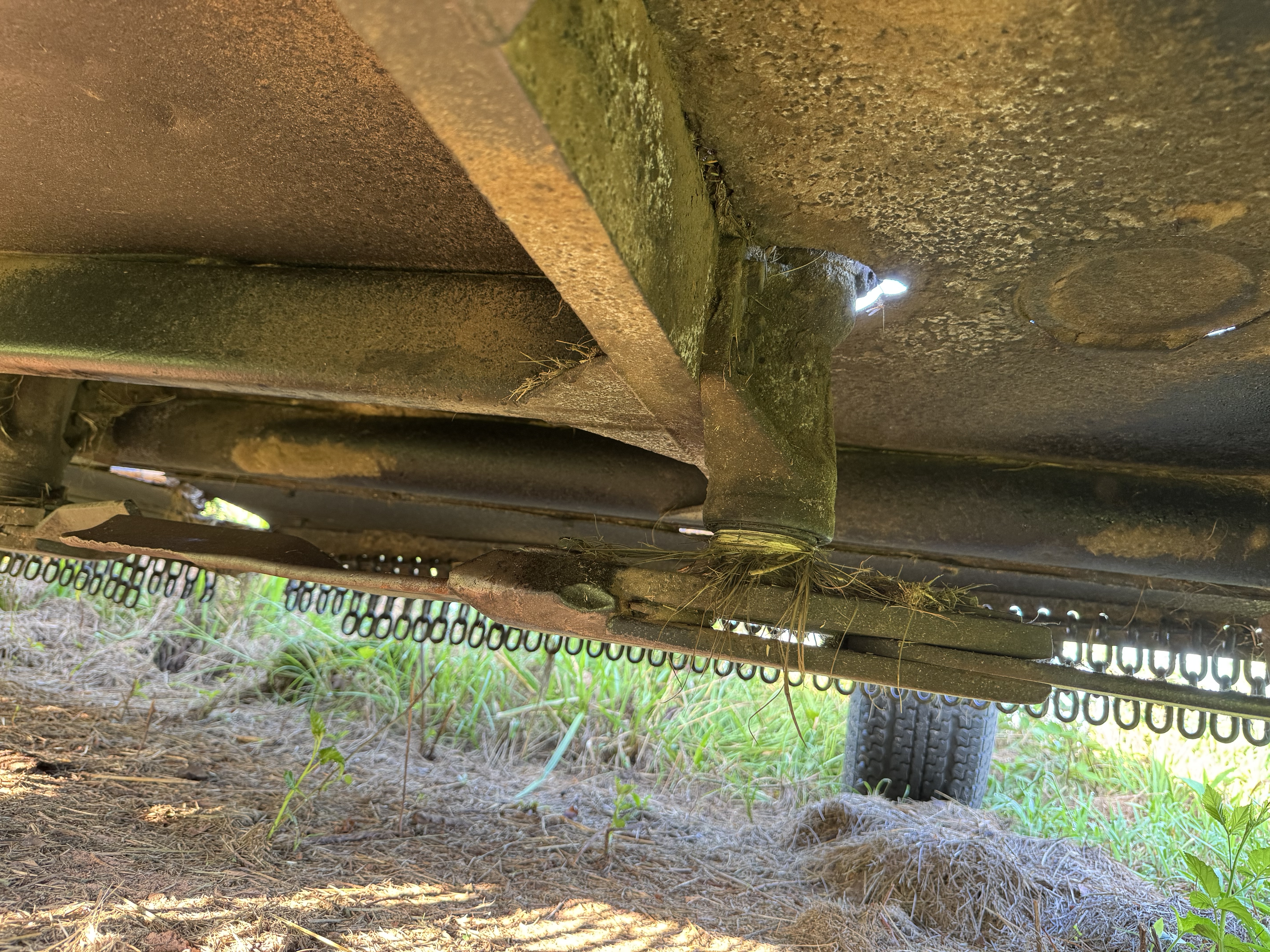

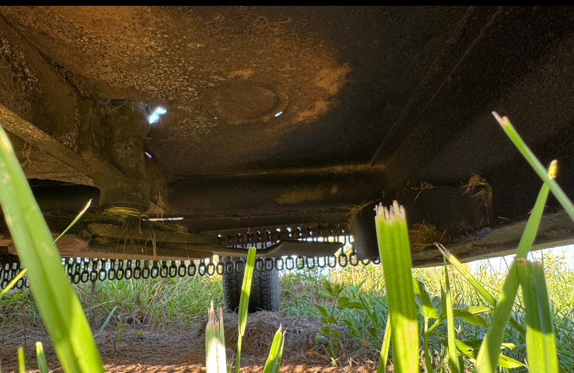

Here are some more pictures and the last one has measurements written on it with black marker.
- the tire path from center of mower/ PTO shaft 18” out to 34”
- streak is in the tire track and out to the center of that spindle
In the last picture the blade rotation at the front of the mower is going to the right side of the picture (outside edge of the mower deck).
Hopefully I am making sense.

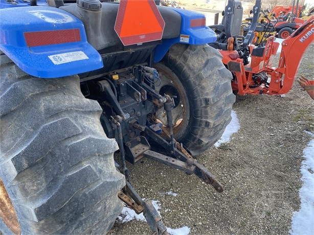

I just realized shifting to the left will be easier than I thought. I forgot that my center drawbar can be moved left or right until I scrolling through some TC45 photos I had saved see attachment. I will try that next mowing.
Hopefully the u-joints won’t scream too much.

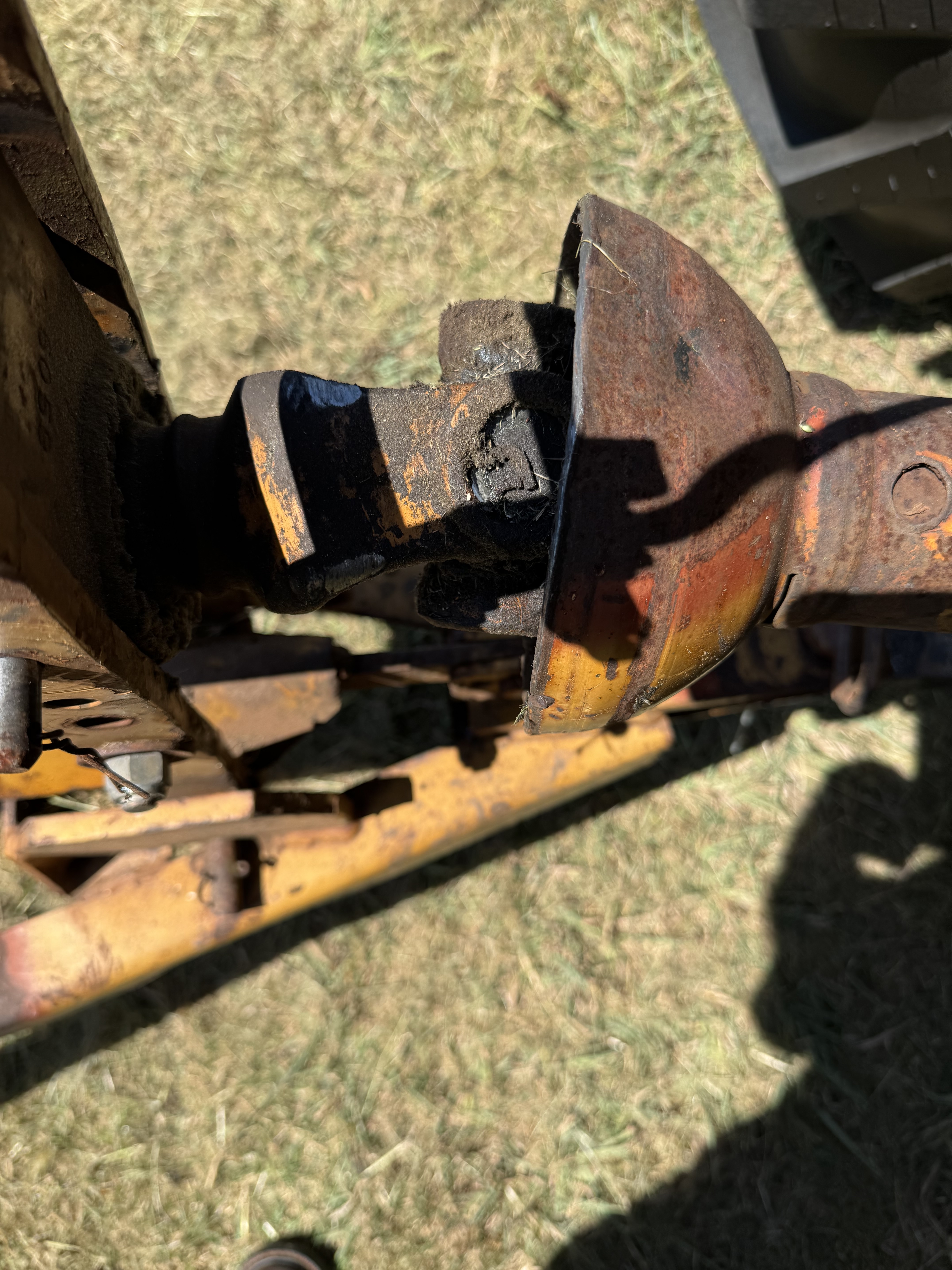

   / Hybrid Rotary Cutter Proof of Concept #78
I tried mowing with my drawbar shifted to the left. It shifts the mower to the left 4” 5” and I noticed my PTO shield rubbed the yoke on shaft yoke so it can’t move farther than that.
The left tire track shifted to the right of the deck by about 4”.
It didn’t make a real difference on the streaking left by it.
If I go slow like when I outline the field next to the fence cutting as close as possible to posts (every 8’ is a post on perimeter) it cuts with no streaking say less than 1.5 mph, but I mow at 3.5 mph typically.

   / Hybrid Rotary Cutter Proof of Concept #79
I also used my IR temperature gun on the u-joints. The back one which was running the straightest was about 5 degrees cooler than the middle u-joint at 114 degrees which had the most amount angle with the mower shifted.
