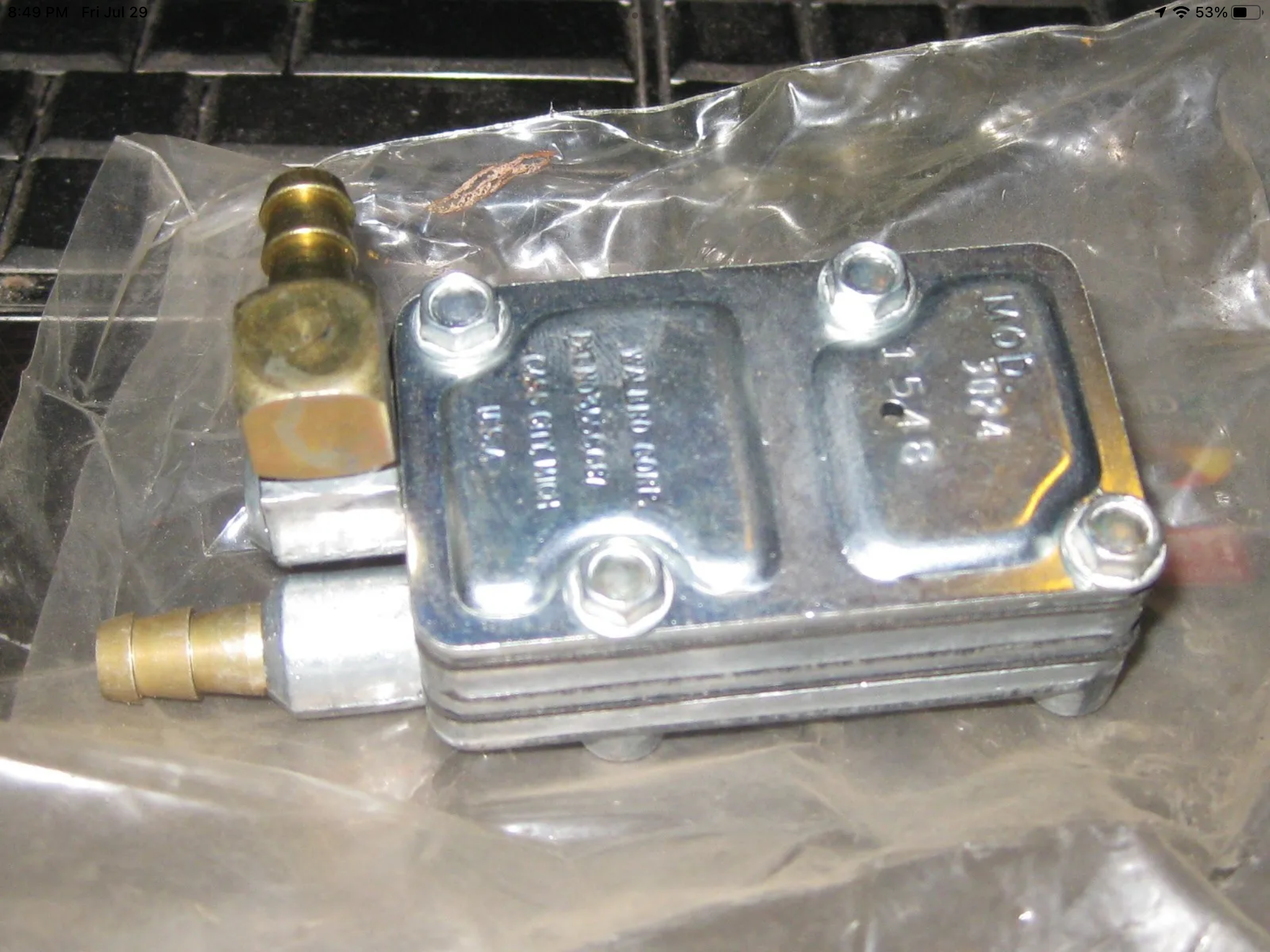

Have you checked the pulse line to see if there is oil in it ?
This is written in the original service manual for Groundsmaster 52. There wasn’t oil in the pulse line before putting on the new fuel pump, but I didn’t observe any smoking before the new fuel pump was installed either. Will check it again, as the new replacement fuel pump is purported to have significantly more pumping ability than the original. The original is a toro part #27-7000 IIRC, allegedly made by Walbro as their model 3000. The new Walbro 3000, sold as the replacement for the old one, is totally different in appearance and composition. While the old one is metal and a flat rectangular shape, the new one is round and made of a black manmade material, supposedly not plastic. I hadn’t made the connection that perhaps the new fuel pump may be an added player in this. The old fuel pump 27-7000 is no longer manufactured. I did notice an online source for one, but priced over $150, so I passed in favor of the new version at $30. The sales rep who sold the new one swore the new one was a superior pump…..

#73
This is the fuel pump used in Groundsmaster 52 to feed the cast iron Briggs 16hp single.
