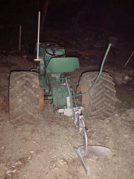

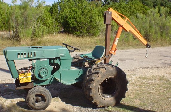

They may be old, but they don't have to die. Repower and alter to do more. Odd parts and Suburban This shows a Sears LT10 and the repowered Suburban with a few changes. Check above for teaser.

Here's the David Bradly mole board converted to 3ph.

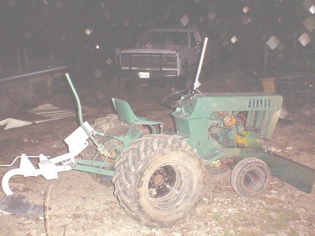

And here's homemade blade and linkage.

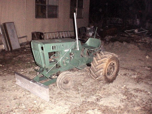

Notice the traction enhancement.

That sure is a different piece of machinery. Looks like it'll go through anything. Gerard

</font><font color="blue" class="small">( Notice the traction enhancement. )</font>
So, do wider tires increase traction or decrease it. Seems like the wide tires would put less weight per square inch and thus be less traction. I don't know.
In any case, that machine sure is a brute. I love machines that show modifications for a specific purpose. They just have a useful and well used look about them.
Cliff
   / Growing Sububan
I'll put it this way, with the original tires, any time the plow hung a rock the tires would spin, with these tires the tractor just stood up until it could go no futher.
The other day this little feller pushed a fullsize dodge van loaded full and never spun a tire and it's only 9.2hp.

very nice..i like the huge rear tires and rims. what are they off of? that engine looks like a WISCONSIN AENLD. they are great engines.. i rebuilt a AENLD back in 2000 and transplanted it on a "63 wheel horse and it has all the power i need. i also transplanted a 10 hp diesel in a larger wheel horse tractor, and the torque is incredible.. now i am hooked on diesel's.. /forums/images/graemlins/cool.gif
   / Growing Sububan
#9
The tires are off of a piggy back fork lift and you were correct on the aenld, it's a 1958.
