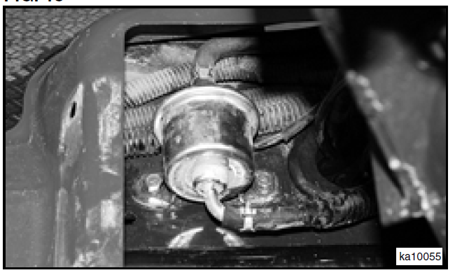

have not gotten screen removed yet to double check (still cold out and I'm disabled) but looks to be either pump or hose (hopefully) off pump and leak getting tossed around by driveshaft.

bingo. will patch/replace tomorrow.
pinhole was aimed directly at driveshaft also which spread the mess (even bumped it up so fan sucked in and spread that way too) all over the place. made it hard to find source.

My issue is preformed line off pump and hole at beginning of 90deg bend all while being within inch of pump output.
Very easy to restrict flow at that point.
And where these pumps WELL under .5gpm that matters.
1/2 inch other way I could easily use tube to patch.
And patch would prob be permanent
Just the worst possible spot on that line.
I really don't have distance to put patch clamp in place as well as clamp on pump output.
Yup worst possible place

temporarily fixed just in time for snow and ice over next 2 days.
luckily I had enough slack to trim and pull back onto pump as break was right at pump nipple end. no way to inset copper and patch as it would have pushed line towards driveshaft as I would have had to add 2 inches to line to allow insert to fit.
lines from tank to pump, pump to filter, filter to injection pump are all brittle so ordering 45$ of lines monday and will replace in spring when under doing other work.
but for now it runs, still few drops on snow but thats prob because belly pan full of fuel.
