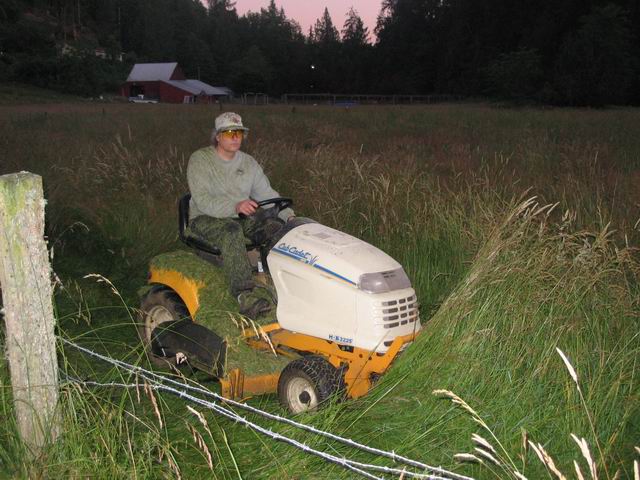

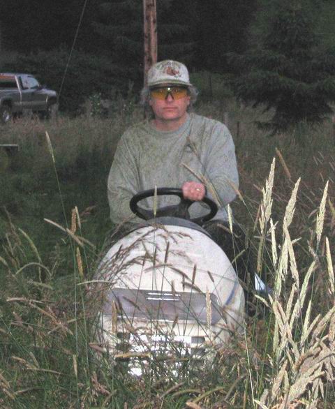

On my 3225 (1998) 54" deck I have had numerous problems with clogging even without mulching. First order of business was to tie up the discharge guard (=unsafe, but the alternative?). Then later I removed the lower brace. This allows me to cut some pretty tall stuff now with minimal clogging. The deck still builds up grass under it and reduces discharge effectiveness, but the stuff eventually spits out. I agree that the design is not the best. I try to clean it regularly, but at 200+ lbs and not the easiest to slide out, cleaning is irregular. The rust is bad, but thankfully they built a thick deck that should last years.
I just bought a Kubota BX24 because I was tired of the problems the 3225 gave me and needed something to do more around the house. I think the Kubota blades and deck are not as heavy as this deck and I am in for more regular maintenance.
BTW, it is only my wife & I & the animals on the property, so the risk is to myself only. I shut down the mower whenever she or the dog are in the area.

BY the looks of your pictures, I think you need a tractor with a brush hog. No wonder it clogs up! That is some high grass. I tried mowing high grass like that with my 2518. It was going thru it but it was plugging up so bad I stopped I didn't want to tear up my machine.

From those pictures, looks to me like you are expecting a bit much from a garden tractor. If you read the manual, it even says not to mow grass that is more than a few inches long. It states :"Your mower is designed to cut lawns, not to be used as a brush hog."
I would vote operator error over machine problem.
