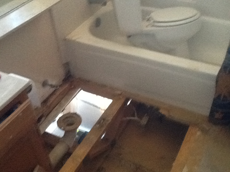

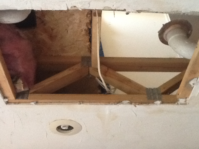

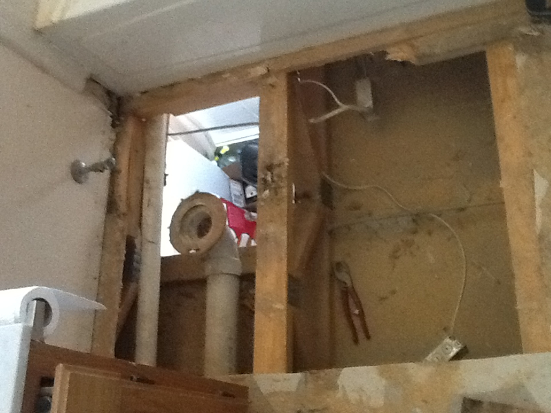

First pic is looking up into the kids bathroom from the kitchen. I was pouring a cup when a drop of water hit me in the head. So this is a 2story frame built in the 80's.

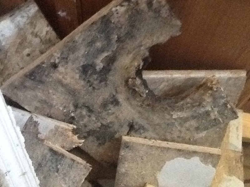

Actually it was the bath, the floor was rotten so I ended up cutting out the rot and will put in new along with some extra bracing.

Were the junction boxes attached?
I had a similar problem in my last house built in late 70's. House inspecter noticed curled vinyl around the baseboard in the bathroom. Had to do the same thing you did before the sale.
   / Guess how my Sunday morning started
The j boxes are part of the can lights. I hate to put a lot of money into this when we are trying to get started at the Ranchito.
