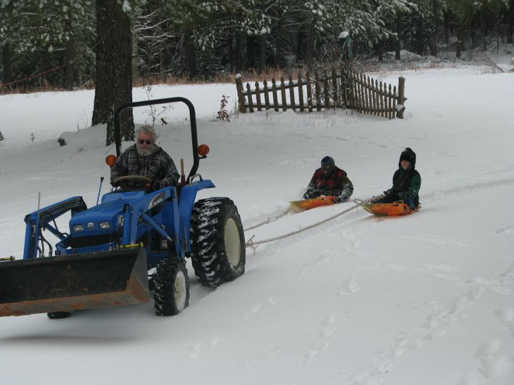

I like mine more,:)We have littel or no hills here in n/east ga.
Army Grunt

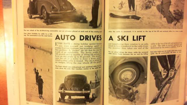

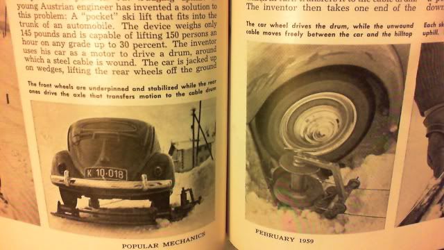

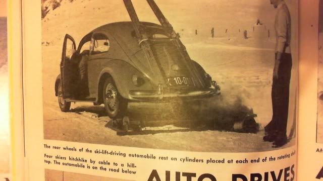

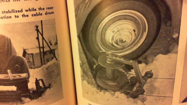

We draw names here for Christmas, and my sister got me this year. She asked what I wanted, and I emailed her links to a couple of auctions for *lots* of old Popular Mechanics magazines from the 40's and 50's. Cost her about $20 total, and has provided me with hours of entertainment.
Here are some admittedly poor-quality webcam photos from the February 1959 issue. Drive your VW Beetle to the slope, and then put the drive axle up on a set of rollers that power up a rope tow:
