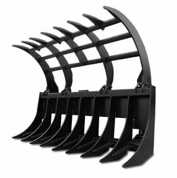

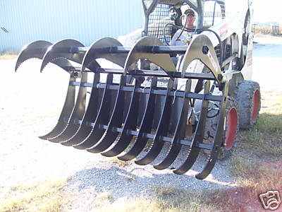

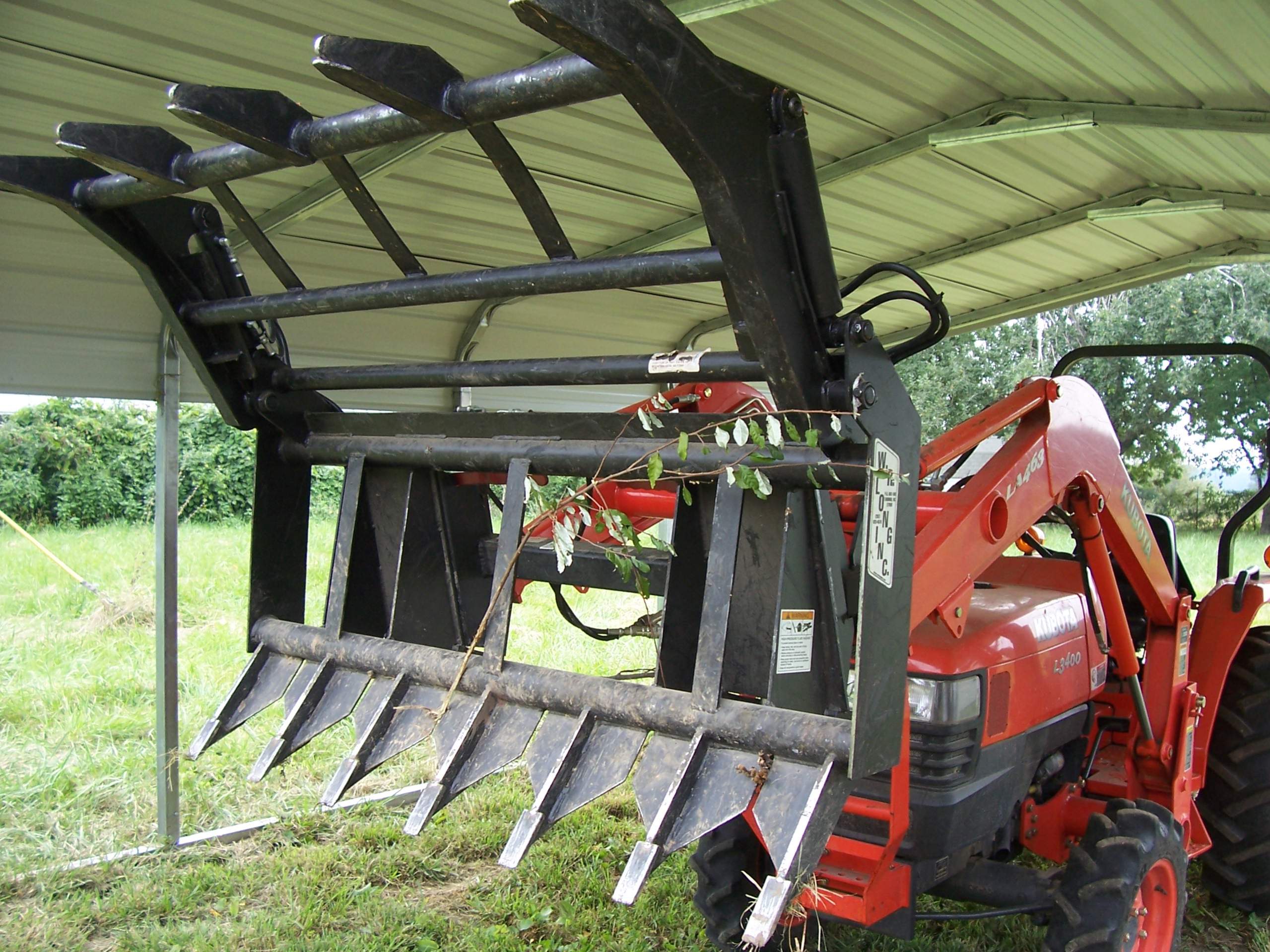

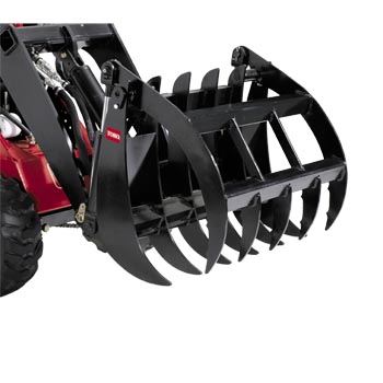

If you will be digging up roots and digging out rocks. you might consider more of a root rake/grapple combination. Root rakes are usually stronger, and there is nothing to inhibit the tines from raking through the ground to do a more effective job at root work. Grapple rakes , have a flat bottom to get under brush piles. It sound like you need a root rake grapple.
The third picture looks like the right combination for root work, and the ability to grab a rather large pile of debris/limbs, etc.
JJ, I think your basic point is correct and bulldozers do have the "claw" type root rake for that reason. However, it is not a very good idea IMO to use a CUT FEL for that type of "rip through the ground as you drive forward" type of work as the FEL arms are too long and not sturdy enough to withstand the forces involved (note that bulldozer arms are short and stubby as they don't need to lift anything and are purpose built for root rake work). In my experience the best way to deal with roots while using an FEL on a CUT is to identify the root or just very gingerly "bulldoze" at slow speed until you engage the root then to use curl/lift rather than forward motion of the CUT to get the root out. CUT FELs are really designed more as loaders and not bulldozers. My point is that it is not the grapple style that limits what a CUT FEL can do but rather the design and engineering of the FEL itself. I'd be more concerned with damaging the FEL arms than the grapple regardless of grapple style.
